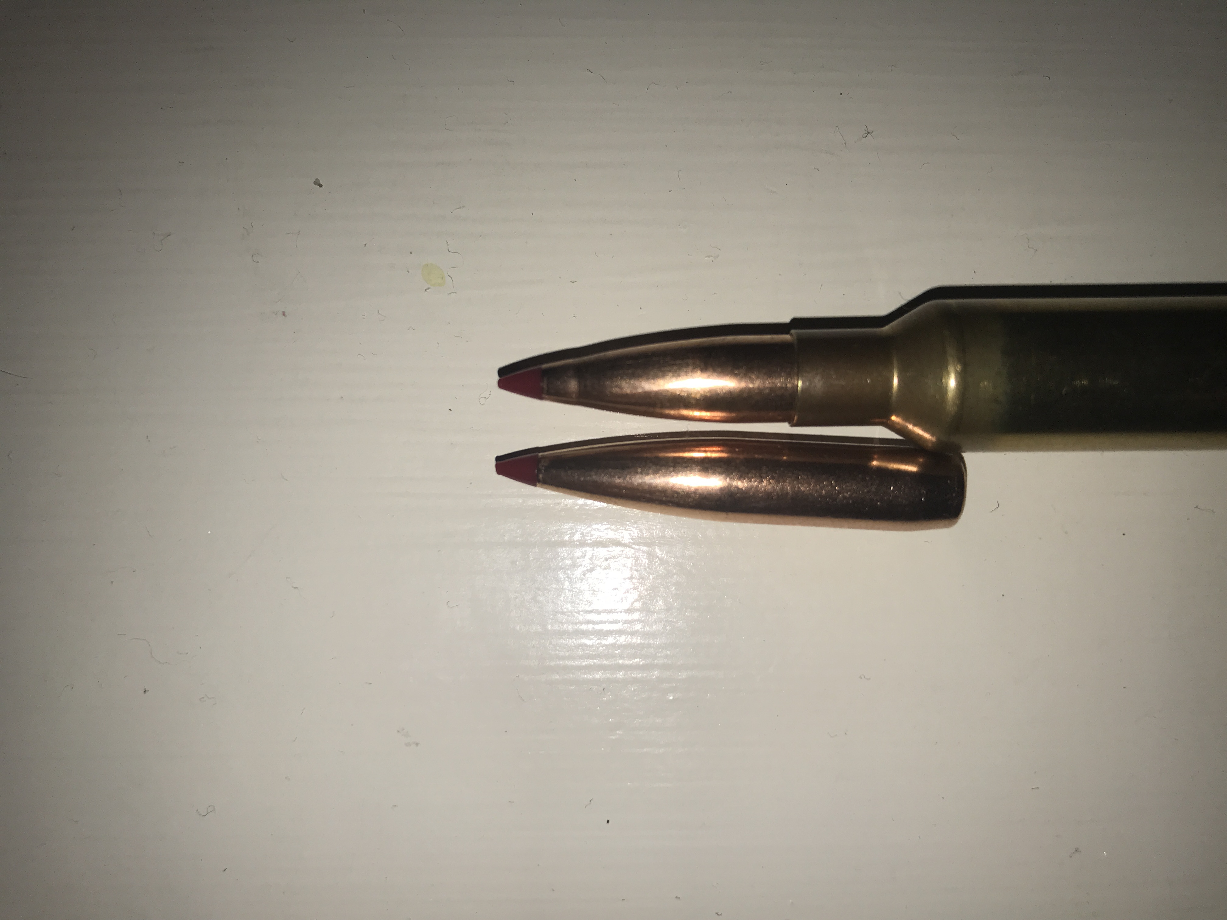

As a reminder this is what they looked like before and after seating.
Projectile before and after seating .

if I were you I would be definitely fixing what is making the ring marks on your projectiles, they are not just cosmetic :thumbsdown:
and if you think the ring marks are not hurting your rifles precision how would you know :unknown:
is this what your rifle and load shoots always or is it the better group of the day :unknown:
or you can be happy with what you have now, its about your standard and what you think is good enough :drinks:

I have had the same problem (with 223) and believe its related to neck tension, on the basis that more force is required to seat the projectile and causes dents
Bushing sizing dies with the correct bushing could solve this

I don't have "more" knowledge, hell what I don't know could fill a library, but I discovered that I was being a little forceful on the press. Being a little more gentle when seating eliminated the dents.

Hey mate, did you do all the things I suggested back on Page 1? I had the same issue with the 143 ELD-Xs, but the issue was setting up the seating die correctly and using an steady, even force when seating - not trying to seat too quickly, as Gaz mentioned.
As to whether it will hurt accuracy, from what I've seen and read, it won't harm inherent accuracy much, but it will hurt BC and change POI over longer distances - which will hurt accuracy if you mix up indented and non-indented rounds (if that makes sense).
I've shot some of my best groups with indented rounds, but only at shorter distances.

the problem with indents on lead core projectiles is that the copper jacket will spring back but the lead core will not
so if you can guarantee the indent is exactly the same on every bullet you will have consistency for shorter ranges but if you cant you may get unexplained flyers
if this is acceptable to you then not a worry but it would be better to not have any deformation for best precision
thing is we can all make it out to be as allowable as we like but it should not be there :unknown: :drinks:

I think the ELD-X are indenting where they are because they are hollow at the tip - there's just copper jacket with the plastic insert, so no lead core to prevent the jacket deforming if the dies are not set up correctly, or if there is too much neck tension (or no concentric), or if you're a bit too exuberant with the seating lever. As mentioned, I went through this myself with the same projectile, and I've got good Forster dies.
G’day mate,
Yes I have and the problem is now nowhere near as pronounced.
Just need to give the seating plug a bit of a polish which will hopefully eliminate the issue all together.
