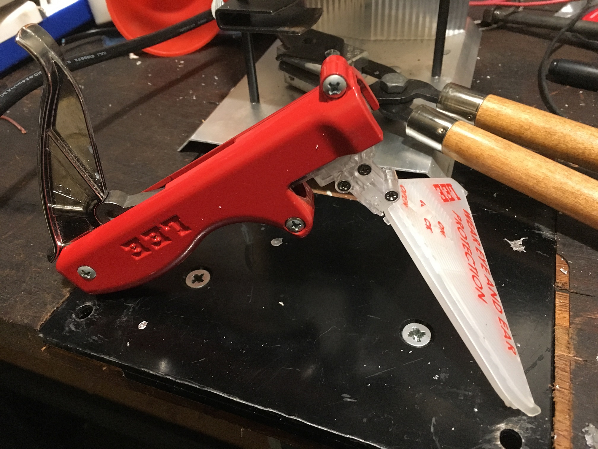

yep Hand prime for me I use the Lee ERGO prime and can easily do 500 cases at a time
the Auto hand prime that comes with the kits is a lot less comfortable (a mate has one) as you are kinda stuck using your thumb
But i say get the Press with the hand prime because it comes with a full set of hand prime shell holders , so you can upgrade to a ergo prime later on i think it was the Breech Lock Challenger Kit that comes with the auto hand prime
THe first upgrades you will be chasing is
Digital scale and the Ergo prime :)
this is my Ergo prime
