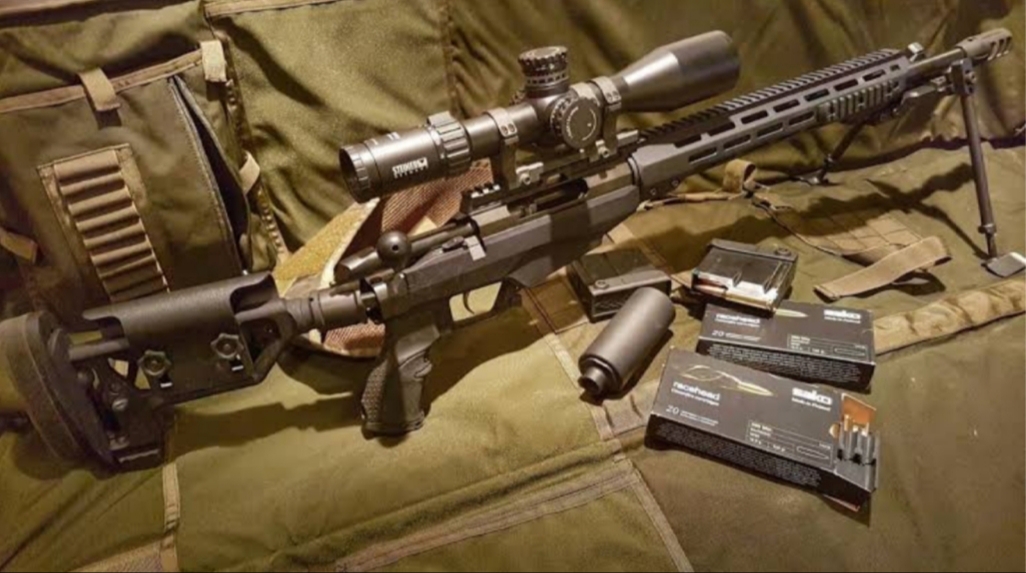

OK i think i stuffed up as i thought we were talking about this rifle , i apologise.......

Post by Apollo » 28 Mar 2019, 12:46 am
What the heck is that piece of rubbish.... :unknown:
Sorry, but those things just do not appeal one bit.. :thumbsdown:

Post by Flyer » 28 Mar 2019, 12:46 am
deye243 wrote:OK i think i stuffed up as i thought we were talking about this rifle , i apologise.......
Sorry, no my bad. I thought you were talking about Apollo's wish list. Of course you were talking about the OP's rifle. That's what you (I) get for going off on a tangent . . .
If it's any consolation, the TikTac should have a similar barrel to the 24" Sako, as they obviously both come out of the same factory.
