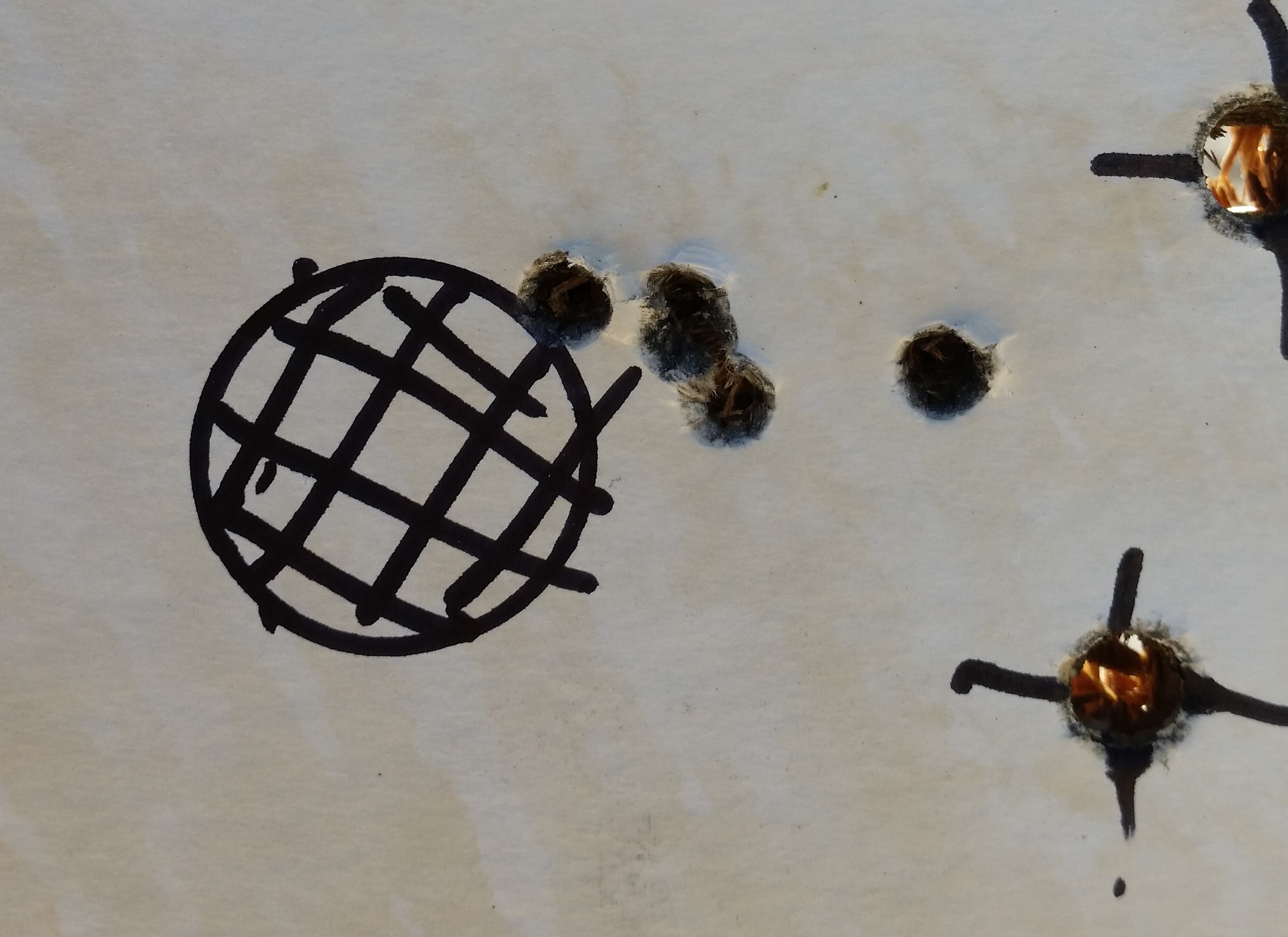

1st grouping
Group 1 Bullets - Copy 1.jpg (611.76 KiB) Viewed 6087 times
Like the experience you described here Tassie Tiger regarding your friend from the forces, the KISS principle sounds good.
RESULTS from shooting & odd measurements (100 meters) -
Had made up 50 brand new cases & my CBTO measurements for the 1st 20 cases had a range of 3 ½ thousandths b/w them, not what I had hoped for as made sure all case necks were lubricated. So still having issues with getting consistent sizing here, and considering people are talking of keeping bullets as low as 2 thousandths of the lands, that is not really cutting it. The last 30 cases loaded had a variation of 6 thousandths, which came from I think me having to empty the cases of loaded powder because I had forgotten to camfer the neck of those cases so this may have wiped away the dry lube (Mica) in the neck when I finally loaded (again) & seated them.
Images show some of the groupings (x5 each) , and they were all around this. The drawn circles with cross pattern are approx. 1 & 2/32 of an inch, I drew a sharpie felt pen around a 10 cent coin. Used ADI AR2209 powder, 38 grain [mid range], 140gr Berger VLD Target bullets, Lapua Cases Brand new. So now have once fired cases.
Used 2 different primers (25 each - CCI Magnum Small Rifle Primers No. 450 & Federal Premium Match Small Rifle GM250M). Funny thing is the CCI primed cases did not appear to have increased the shoulder length of the cases, but the Federal primed cases grew by 3 thousandths on average (more power generated?).
Another unexpected result was all case lengths are now shorter in length than when brand new, expansion to fit rifle chamber shortened all cases?

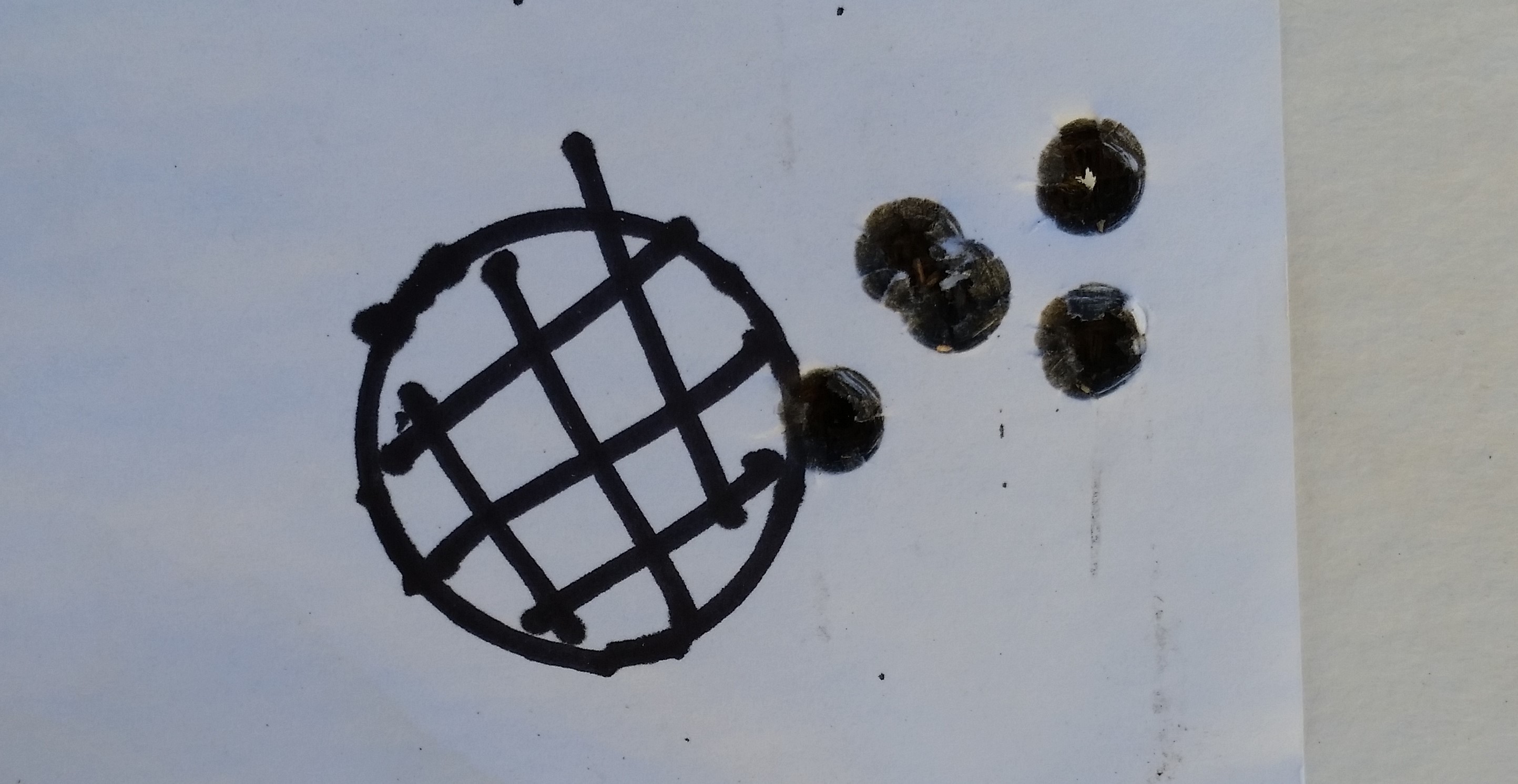

5th grouping
Group 5 Bullets - Copy.jpg (728.29 KiB) Viewed 6087 times

Re: Bullet seated too deep ???
Post by marksman » 26 May 2019, 8:48 pm
circles you are getting a heap of horizontal
please dont be offended if I say I think you may be the problem
have a look at this utube vid I think will help you shrink your groups :thumbsup: :drinks:
https://www.youtube.com/watch?v=iLeJ8rRUSXc
be aware that a heavy trigger can cause horizontal as well as other things :drinks:
also a smaller target is better, aim small shoot small :thumbsup:
Post by cirles » 26 May 2019, 11:00 pm
marksman wrote:circles you are getting a heap of horizontal
Hi marksman,
No offense at all taken, & yes I think that I am the problem with the groups. Definitely getting horizontal shooting so any suggestions are welcome & will look at the video you have posted.
I find that I am not comfortable when it comes to operating the rifle on a bench (friend just starting says the same thing, he prefers shooting prone). I shoot from a bipod that has spiked feet (came as standard) so use a strip of rubber matting I place on the bench top & put my bipod on top of that. I then use my left hand under the pistol grip handle to help adjust height (do not use a bag or anything at the rear & do not wish to) while trying to hold the stock end hard into my shoulder (which I think may be wrong). Another problem I am running into is suffering from pins & needles in my right dodgy arm, result of neck issues that rose again 2-3 months ago, & that may be a game changer in ending this little game. Will have to see how that plays out next time.
Really enjoying this otherwise, the setting up & actually loading rounds that did not blow up the rifle :D

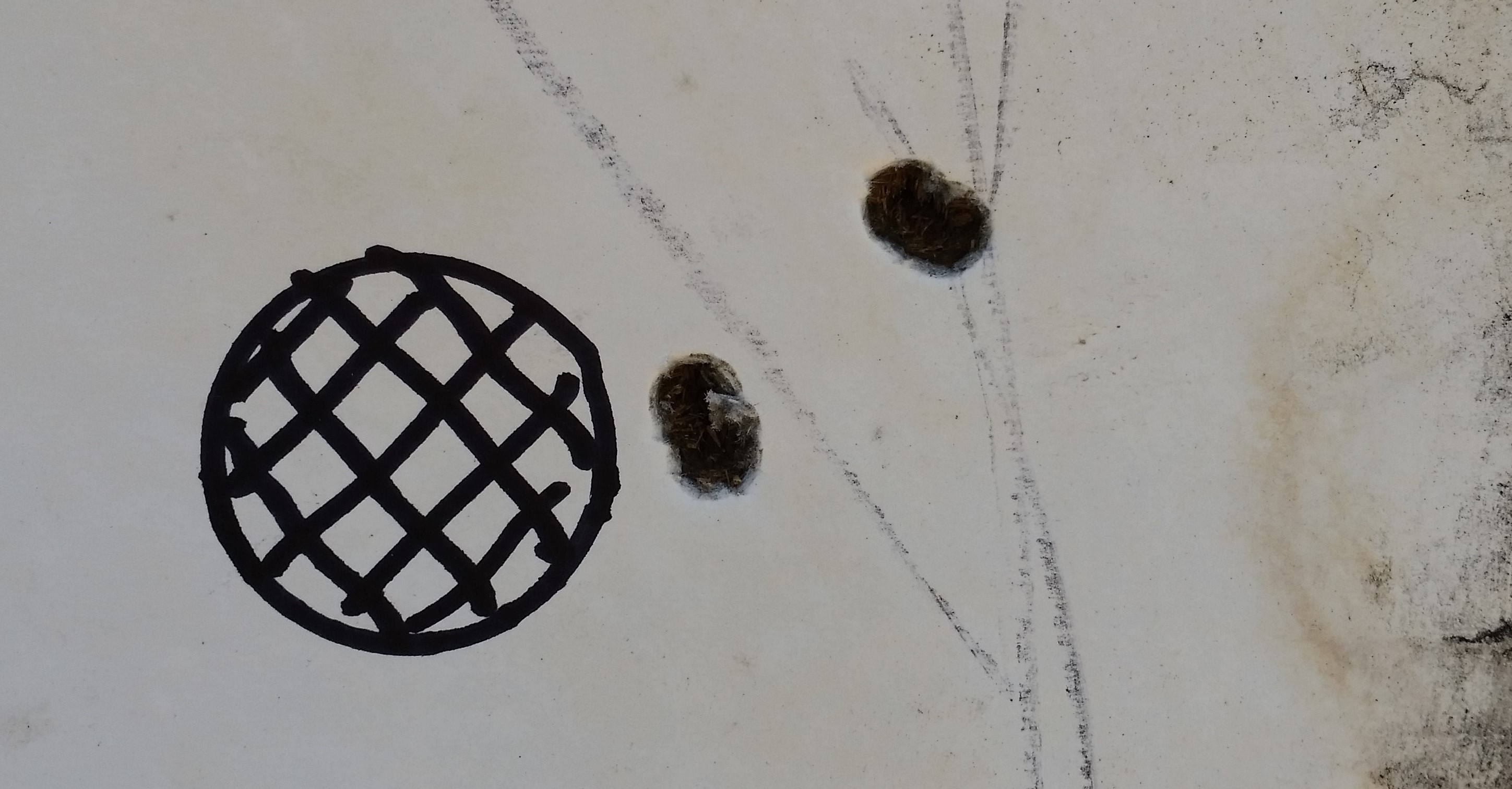

Previous images were for the CCI primers, these 3 are for the Federal primers.
Group 10 Bullets -1.jpg (565.72 KiB) Viewed 5980 times
Group 6 Bullets - Copy 1.jpg (636.33 KiB) Viewed 5980 times
Group 2 Bullets - Copy 1.jpg (521.84 KiB) Viewed 5980 times
Post by SCJ429 » 27 May 2019, 10:13 am
Stick with whatever primer you like but find a load that is sitting in a node that shoots. Then if you want to change primers you can do this testing. The new primer may give you extra speed and push you out of the node. You then throttle back the charge to get you back into the node and see if the primers have decreased your standard deviation. Do you have a chronograph?
Post by SCJ429 » 27 May 2019, 10:24 am
Shooting prone off a bipod takes a little technique but can be extremely accurate. You see F class shooters using bipods on skids so that the rifle recoils straight back. If you put too much input into the rifle it may bounce off the ground sending your rounds left and right, up and down. Loading up the bipod by pushing it with your shoulder against spiked feet may be doing this. Try rubber feet and gentle pressure from your shoulder.
Marksman posted a vid that showed some excellent tips including trigger control. I find I am better with my thumb placed along the side of the stock, just above my trigger finger. Placing my thumb up behind the action tends to make me shoot left. If I am struggling I go to pinching the trigger with my thumb at the rear of the trigger guard.
Post by SCJ429 » 27 May 2019, 10:32 am
Don't use your left hand under the pistol grip, if you want to shoot without a rear bag use you left hand under the the stock below your face. There are also small tac bags you could consider, they are held in you hand and you squeeze them to get the desired height. These are used by PRC shooters in all sorts of difficult shooting positions.
