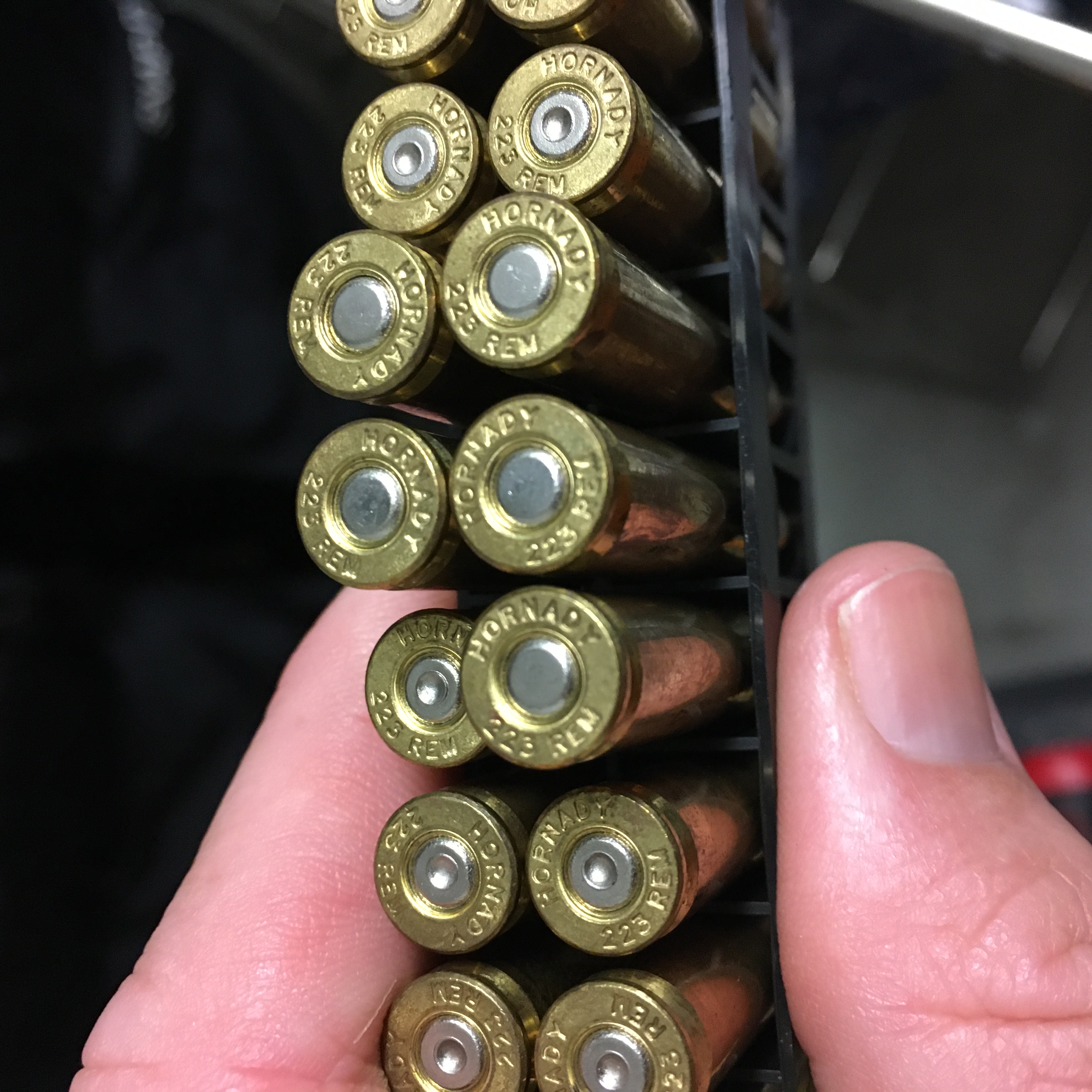

Hmm potatoes, mate i bought a few boxes of the 60gr tap in 223 (i just rechecked to confirm) from shop. And mine has crimped primer pockets. If the pockets are crimped that would explain why its very hard to seat primers, why primers might be seating out and that will increase case length.

Ziad wrote:Hmm potatoes, mate i bought a few boxes of the 60gr tap in 223 (i just rechecked to confirm) from shop. And mine has crimped primer pockets. If the pockets are crimped that would explain why its very hard to seat primers, why primers might be seating out and that will increase case length.
Hey Ziad, after looking at a stack of pics of crimped primers from the web i think you might be right. Here’s a pick of mine
223 tap with 60gr vmax

Post by Sergeant Hartman » 10 Feb 2020, 8:34 pm
Easiest to tell is deprime one and run a pin on the walls. Try to use a case debur tool on the picket on one and try and seat a primer

Post by Potatoes » 10 Feb 2020, 9:01 pm
Yeah the deburer did the trick some time ago after the primers were catching the edge. Primers go in ok now, just stick out a tiny bit on the majority of them.

Post by in2anity » 10 Feb 2020, 9:31 pm
Potatoes wrote:Yeah the deburer did the trick some time ago after the primers were catching the edge. Primers go in ok now, just stick out a tiny bit on the majority of them.
Treat yourself to a satchel of say, ADI brass. I bet your problems go away.

Potatoes wrote:[quote="Ziad"Hmm potatoes, mate i bought a few boxes of the 60gr tap in 223 (i just rechecked to confirm) from shop. And mine has crimped primer pockets. If the pockets are crimped that would explain why its very hard to seat primers, why primers might be seating out and that will increase case length.[/quote
Yep, crimped primers.

Post by wanneroo » 11 Feb 2020, 1:04 am
That sure as heck looks like crimped brass to me. If it's the TAP rounds, those are used in law enforcement and perhaps military applications and often rounds that will be fired full auto will have crimped primer pockets.
