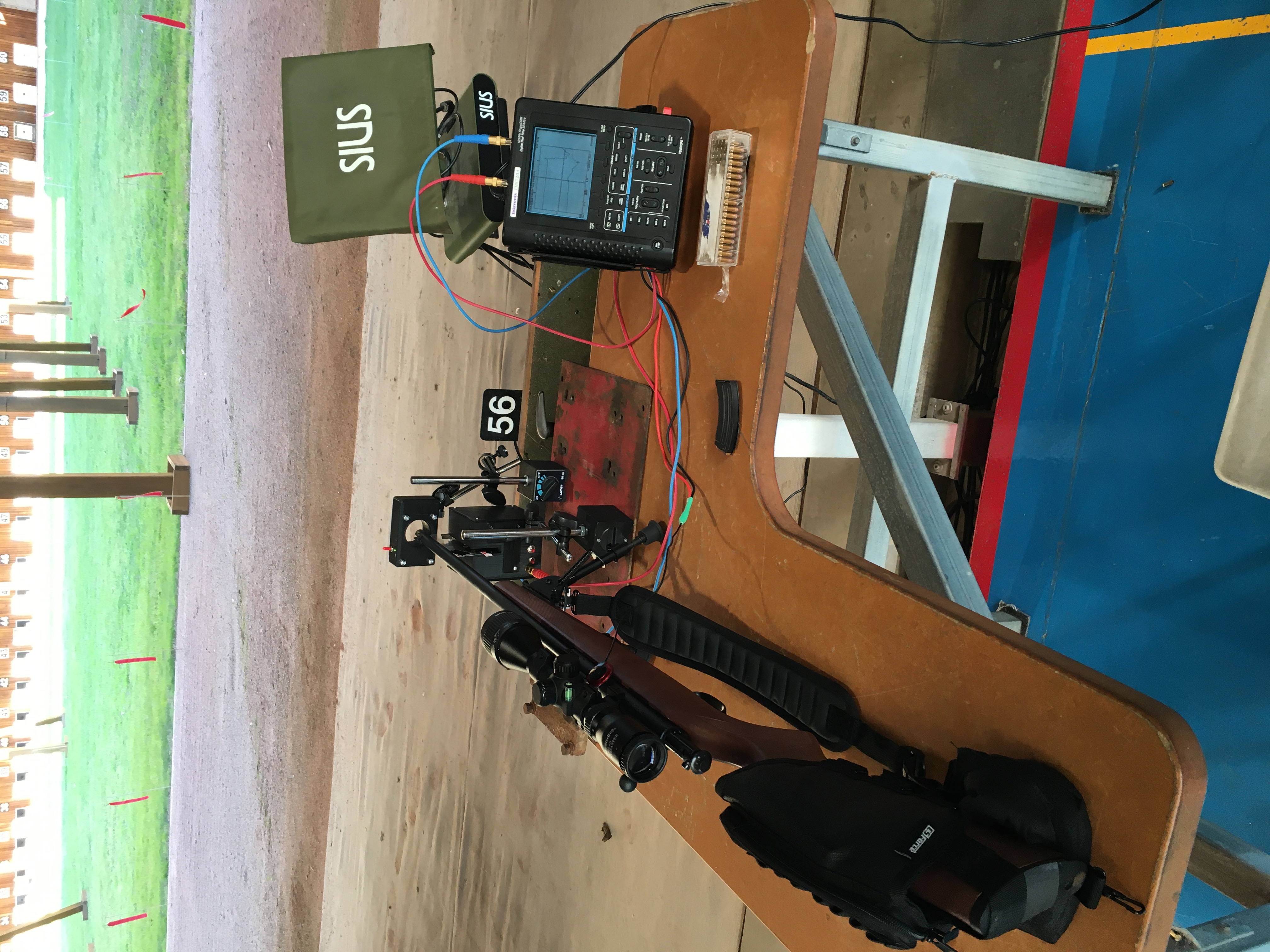

Post by Jarhead » 09 Aug 2020, 2:03 pm
Wooo Hooo!
The barrel angle sensor was a success at the range!!!!
Next steps-
1. make a bullet exit sensor.
2. determine how many milrads per volt.
3, setup an adjustable mount so you do not have to spend 20 minutes tweaking position with wooden wedges before firing one shot.....

Post by Jarhead » 10 Aug 2020, 11:44 am
Tassie,
Paid off? LOL. It already has! I once paid thousands for a holiday that really sucked. I have spent exactly $83 on this so far ( I already had the oscope) and the pleasure of success has made it worth doing!
I have decided to do this to shoot better and enjoy the process. I have spent enough of my life making money that I can choose not to with my favourite hobby. If I wanted to make a buck I would be looking at how to integrate this with iphone /android instead of the Tekscope as that is the only way it would make a viable business case.
When I get some usable data on the 6.5 it will be fun- I can work towards that less than 0.2 MOA target I set for myself.
I started working on a barrel sensor design- but stopped when I realised it will be exposed to muzzle blast. I need to understand the blast forces first as I don't want to send sensor shrapnel flying.
I did measure the device scale.- 6 volts per miliradian
I also thought about a mount- I have one for a dial gauge that I think will be exactly what is needed- will play with it this afternoon.
So far the only real data I have gleaned with it is that my .22 whips through about .23MOA.

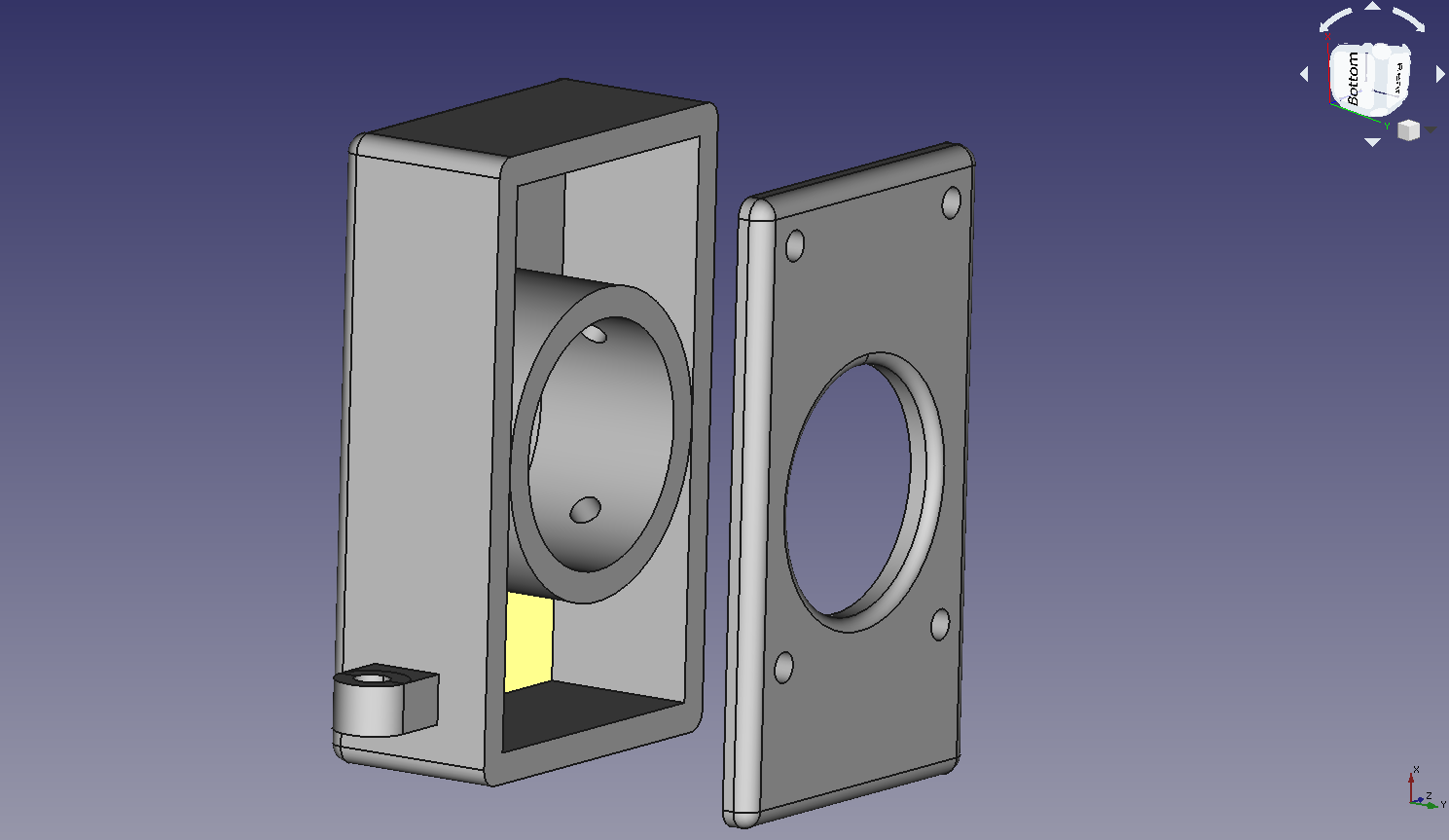

Re: Load dev-how many shots does it take to dial in a rifle?
Post by Jarhead » 14 Aug 2020, 8:40 pm
Tassie.
Thanks for the info. I already have the 3D printer going on the design I posted though.....Its almost done. I will try to get the electronics install next week and aim to test it out on Sunday week.

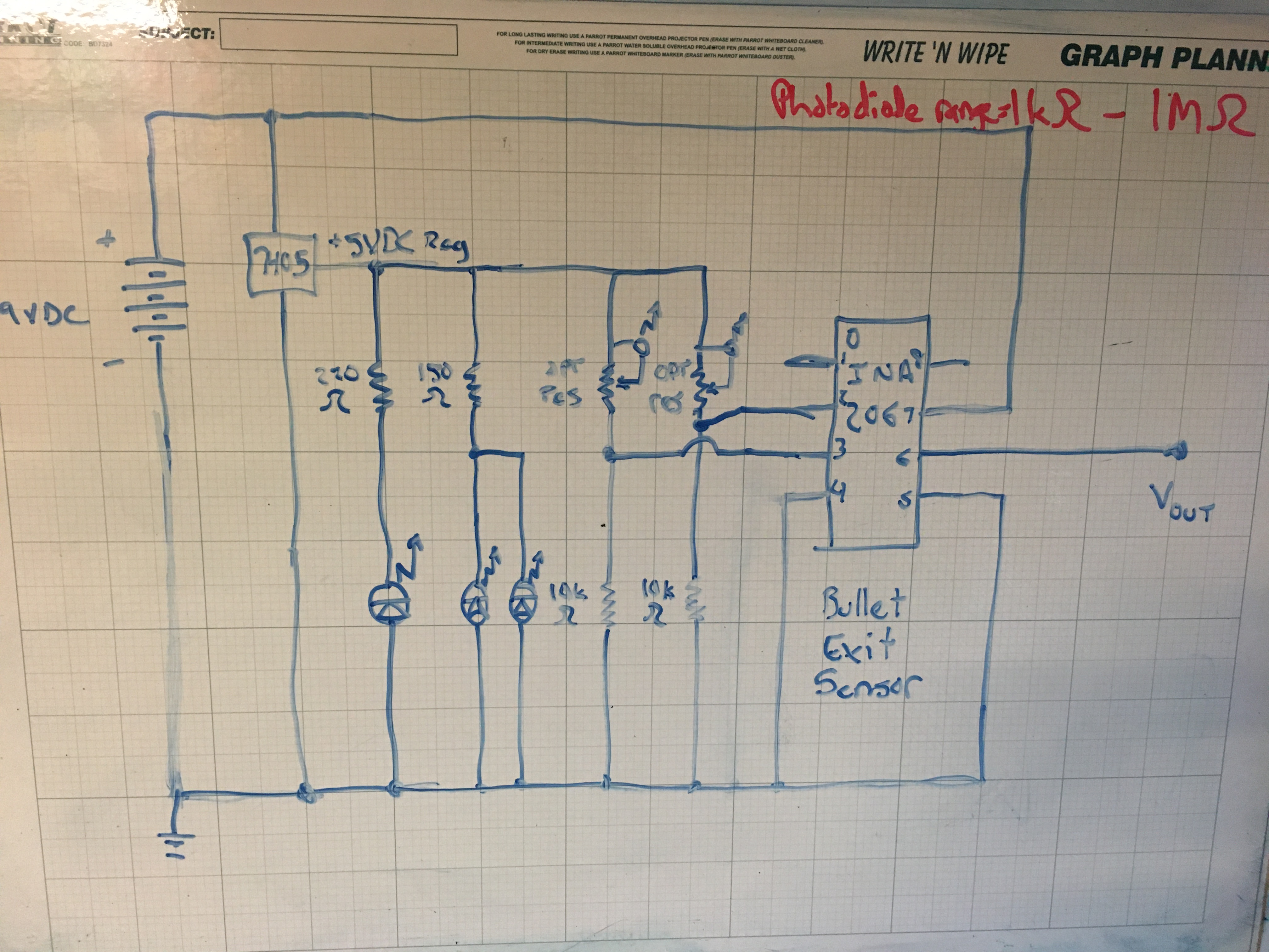

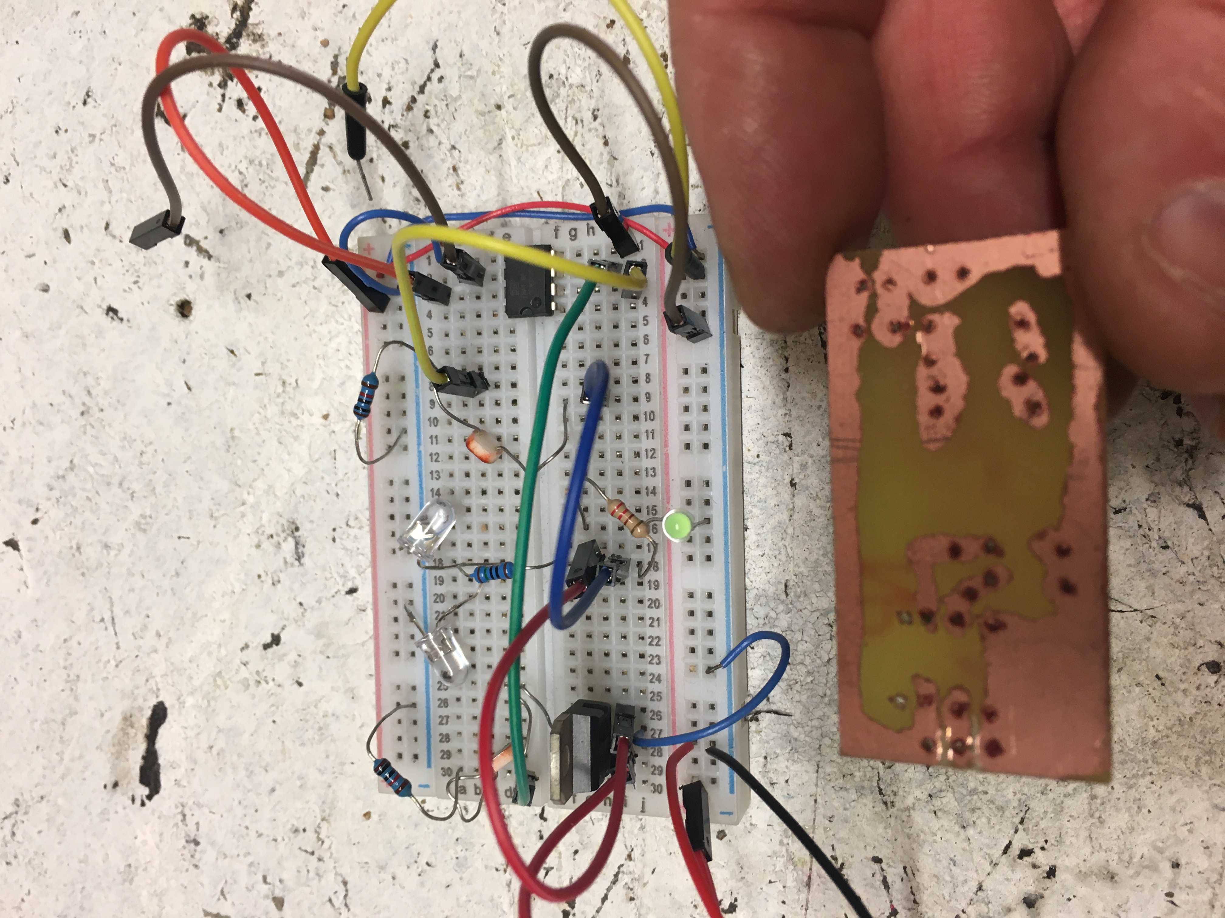

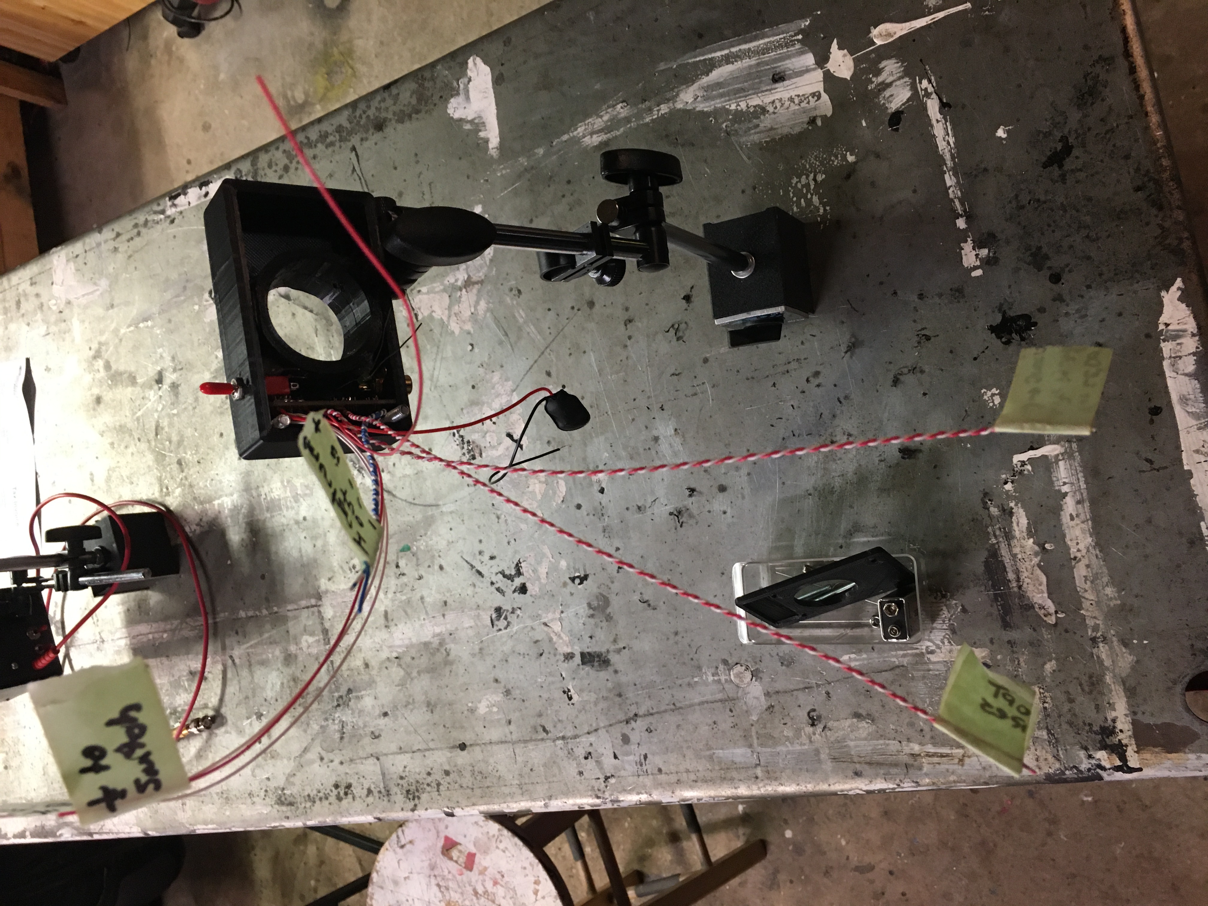

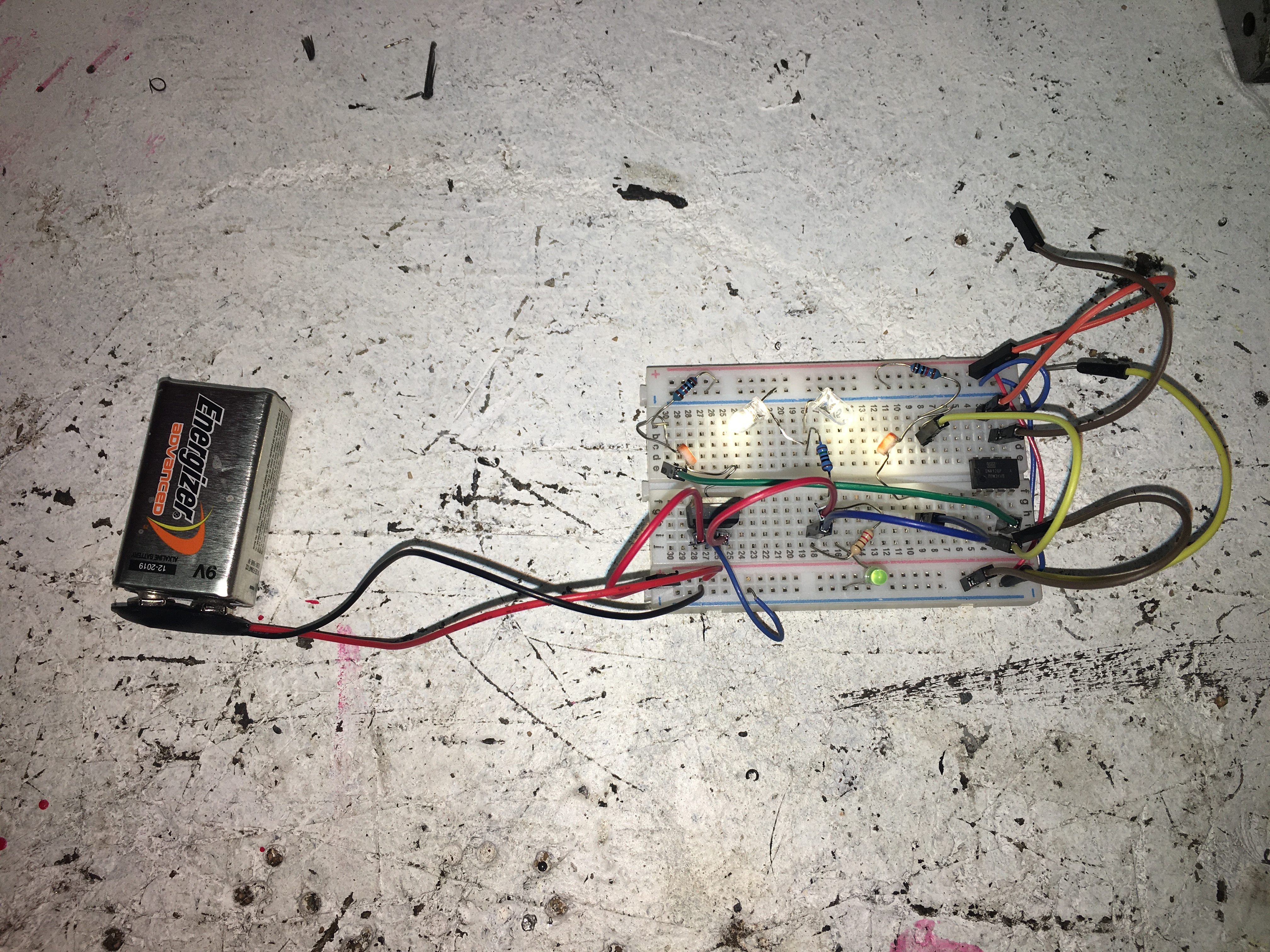

Post by Jarhead » 20 Aug 2020, 8:13 pm
Design to reality.....I love doing this stuff. The bullet exit sensor is together and working with an index finger through the beams- need to test it with a real projectile moving fast......
I'll give it a test at the range with the 22LR next and if it holds up to that.....I'll take some real measurements with the 6.5. Rippa!

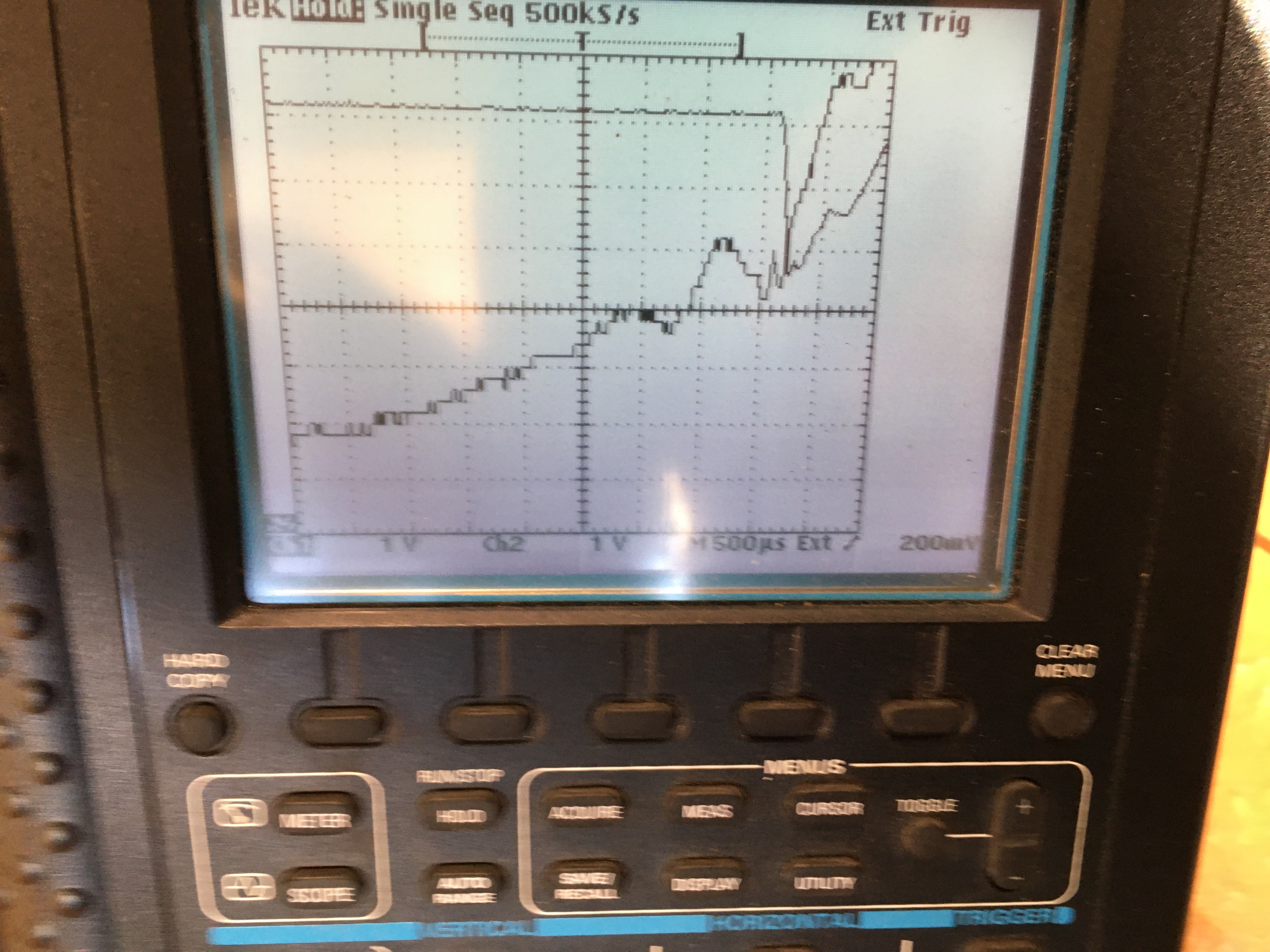

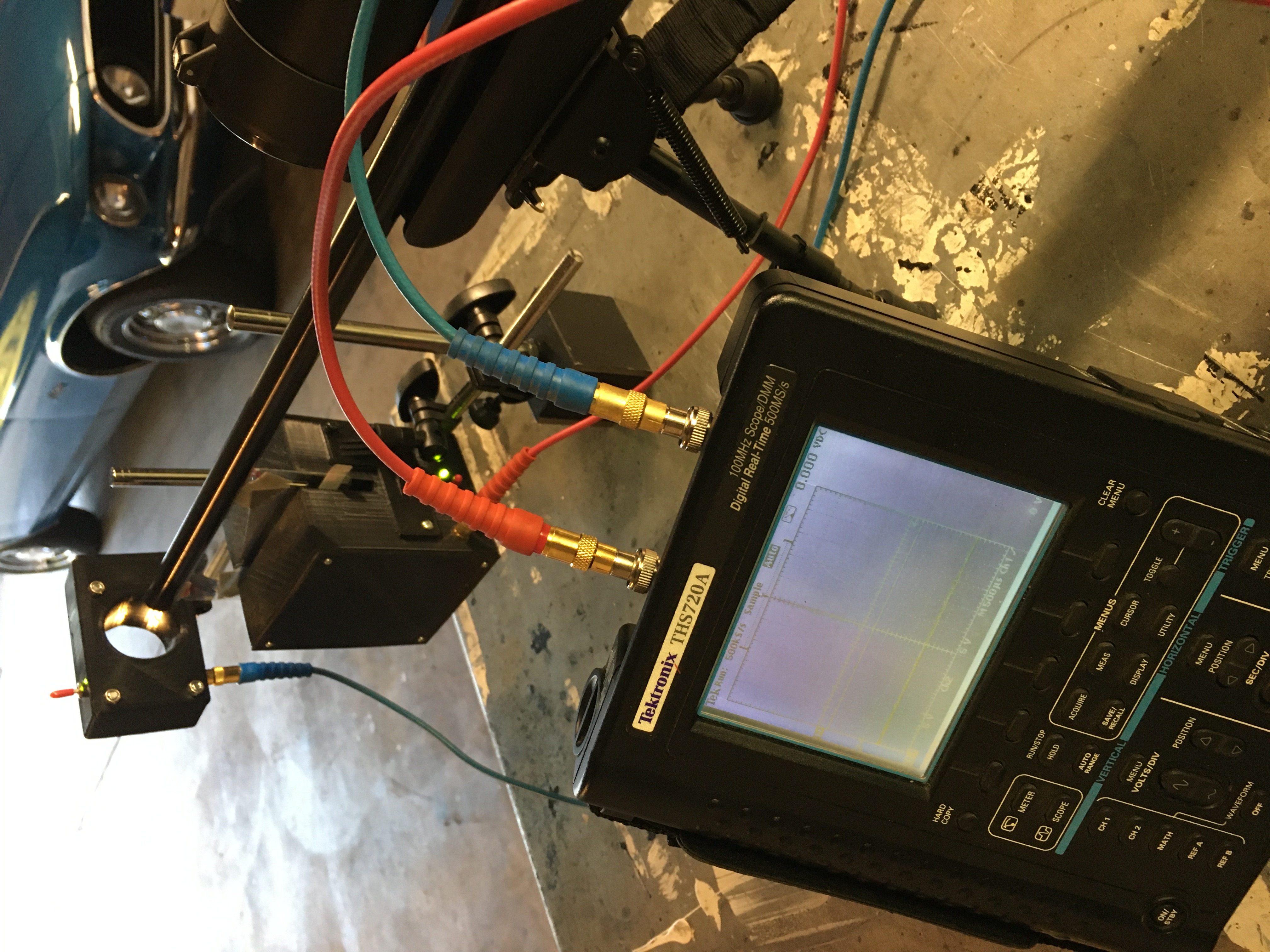

Post by Jarhead » 21 Aug 2020, 6:27 pm
Another successful test day!
Verified that the bullet exit sensor is working- and then managed to capture both bullet exit and barrel elevation whip on the same trace! The top trace is the bullet sensor and the bottom one is the barrel angle sensor. They cross over at about 4.2 milliseconds and the barrell angle trace goes off the top of the scale. I can see that I am on the wrong part of the curve with that ammo and the target results reflected that- they were all strung vertically. It looked like I sawed the target in half down the middle.
Next step is to use the bullet sensor on the 6.5 to measure how the change in bullet exit time relates to muzzle velocity (i.e how many fps change makes the bullet exit time change by 1 millisecond). I'll do that the next time I am at hilltop after the magneto-speed arrives......
I also found it is painful to take a measurement without the rifle being clamped down as I move it when I get behind it to shoot. A very slight movement sends the trace off the display.
Can anyone recommend a portable way to clamp the rifle into position by the stock and keep it shoot able?
Post by Jarhead » 21 Aug 2020, 8:50 pm
Hi Larry,
Agree there is alot more to harmonics than that. There are 3 that I am aware of and I understand how to get positive compensation from the first two. I don't have my head fully around arc yet.....
1. Barrel whip, which I am measuring above.
2. OBT- which I think of as "donut" expansion of the barrel from the breech to the muzzle and back. If the bullet exits as the crown contracts, good accuracy results.
3. ARC- caused by the barrel vibrating in a moment (i.e twist) as a result of the bullet accelerating into a spin when it hits the lands.
