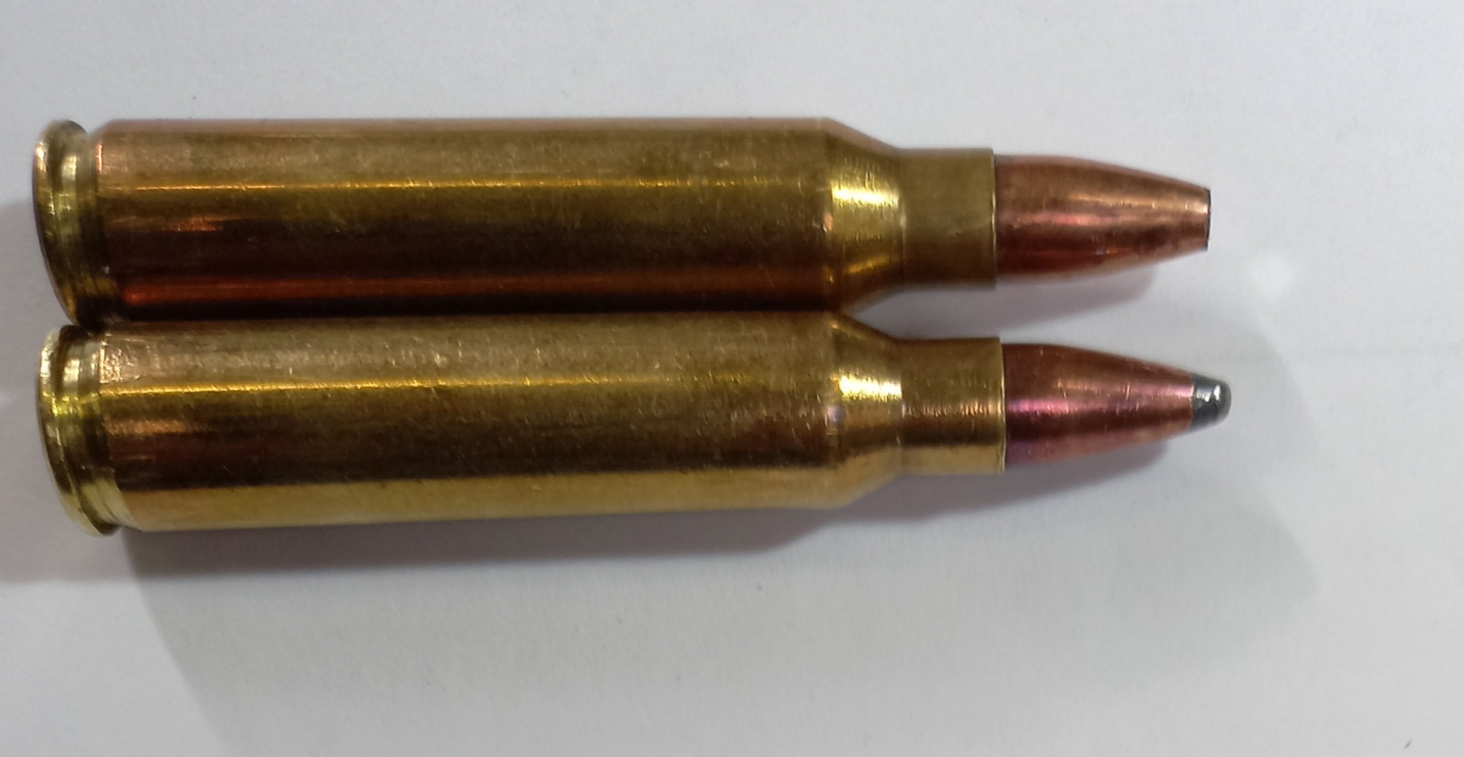

Post by Oldbloke » 11 Aug 2021, 9:58 am
Try this.
TBH. 15.8 gr AR2206h,,,I would think that would be doing around 2200fps (hust a guess) surprised their is no deformation at all.
I've shot 2 foxes with my load (abt 2100fps) and both just fell over. Bullets were 55gr, straight out of the box.

Oldbloke wrote:Try this.
You grind the points off?
Re: .222Rem loading down to .22mag
Post by Oldbloke » 11 Aug 2021, 4:26 pm
No mate. Tried a file first time. Bloody stanly knife was best by far. Lol Took about 0.7 gr off.
Grinder or file will just clog up with lead.
I did it for easy identification of my squib loads. But figure they will open up a bit quicker now, which is good as only doing abt 2100fps.

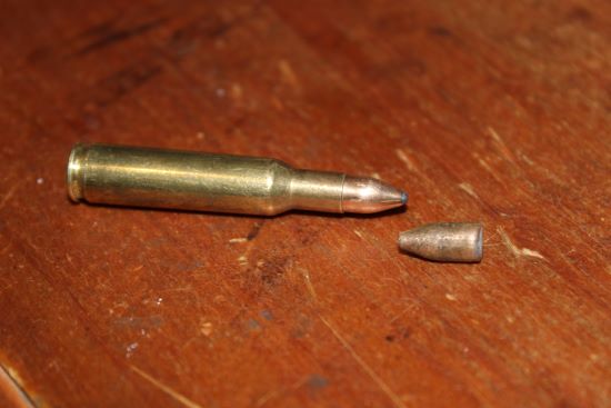

Post by MtnMan » 11 Aug 2021, 7:05 pm
Here's the bullet that I just happened to find sitting on the grass on the embankment behind my target. This is from a 15.8gr charge of AR2206H. Could be from 50, 70 or 100m. The jacket is completely intact and there is a dent in the base. Bullet is the Speer 40gr Spire point #1017.
That is going to act as a FMJ on small game!!!
I've loaded a few with 20gr charges listed as starting loads but I'm yet to shoot any animals with it. accuracy is good with 20gr.

Post by bladeracer » 11 Aug 2021, 7:16 pm
Doesn't seem like it had much velocity. How low is it shooting compared to your .222Rem 40gn loads?
If you know the trajectory for 50m, 75m and 100m we can calculate the velocity fairly accurately if you don't have a chronograph.
FMJ bullets still kill just fine if you hit the right spot. If accuracy is good just place the bullet in the brain or heart.
I no longer have a .222Rem so I can't replicate the load to chrono it.

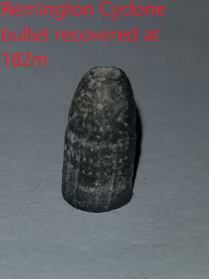

Post by bladeracer » 11 Aug 2021, 7:32 pm
I recovered a virtually undeformed Remington Cyclone .22LR bullet last week.
It was laying on the ground at my 182m targets.
It should've hit the grass at about 850fps, but a fair percentage of that old ammo was significantly under-powered.
Obviously it still had enough to make it to the targets so it probably only dropped about 600mm lower than the others.
I guess the wet grass was sufficient to steal most of its energy before it hit the mud underneath.
Despite being a high-velocity hollow-point, I wouldn't expect to see any deformation at 180m on small game either.

well, just shot 2 foxes with the 40gr bullets and 20gr charge. Both were chest shots. 1st one dropped on the spot and had an exit hole about 10mm diameter. about 80m shot.
second one dropped but disappeared, nowhere to be found. distance was a tad longer.
these things won't expand! Bit disappointing really. never seen a regular soft point act so much like a FMJ.

will try cutting the lead tip off and maybe even hollowing it a bit.
