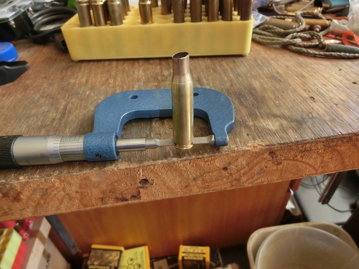

Post by straightshooter » 12 Sep 2021, 8:41 am
For those that are interested, the only reliable way to evaluate excessive pressure in a 'high pressure' cartridge is to eliminate as many measurement variables as possible.
That is done by using a blade micrometer scaled in 0.0001 inch graduations or better still 0.001mm and measure in the extractor groove. (see picture)
The method is to make 3 measurements of diameter around the groove at 1/3rd of a rotation each and calculate the average before firing. Then do the same after firing. If there is as much as 0.0005 inch increase in average diameter then the pressure of the load recipe being employed is excessive for the case head hardness and temper in the brass being used.
Ideally for reliability this measurement procedure would be repeated over a number of samples for a reliable evaluation.
Also this method is only really useful in cartridges that operate in the 50 000 CUP or 60 000 PSI range which is approaching the ultimate tensile strength of brass.
Posts: 1457

I don't see any value in measuring in the extractor groove as the brass is essentially solid at that point.
I measure just ahead of the groove.

That is precisely the point of measuring where the brass is solid.
The purpose is to know whether the ultimate tensile strength of the hardest part of the brass case is being exceeded and not whether you are measuring the deformation of a thin section of softer brass that is intended to deform.
Or a tapered section of brass that can't be easily reliably measured.

I understand that, but it requires immense pressure to expand the solid brass. By monitoring any expansion up higher, closer to the walls I would avoid ever getting near those sorts of pressures. Basically, I think the pressures that lead to expansion within the groove are far above where any of us should be shooting.

I measure ahead of the extractor groove. Using a standard micrometer I file the rim so that when I measure the solid web the rim doesn't get in the way. This way you have a single place to measure on each cartridge case.
Pressure signs are excessive when there is more than 2 thou expansion on a once fired case.

Post by straightshooter » 19 Sep 2021, 8:27 am
straightshooter wrote:That is precisely the point of measuring where the brass is solid.
I think you still don't get it and I suspect you may possibly have lost sight of a characteristic of gas under pressure being that it exerts that unit pressure equally over the internal surface of it's containment.
Firstly 'immense pressure' is what makes modern cartridges and modern powders deliver the performance they do. The trick is to be in that upper end of pressure yet still remain safe, or suffer diminished performance due to excessively lower pressures. This should be of particular interest to long distance target shooters.
What I have described is a reliable and simple go/no go test that reveals whether or not a loading may exceed the tensile strength of the brass being used.
It is particularly useful in circumstances where, case head web thickness is minimal or case head hardness isn't what it should be, such as after incompetent or clumsy case annealing or having a batch of 'too soft' brass.
If expansion of 0.0005" using this method is seen then it is a definite warning to back off.

Oops, I said 2 thou expansion and it should be 0.0002

I thought 2 thou was a bit much, figured I would just use the more conservative figures. Who am I to correct you! You're actually more conservative than most books are
