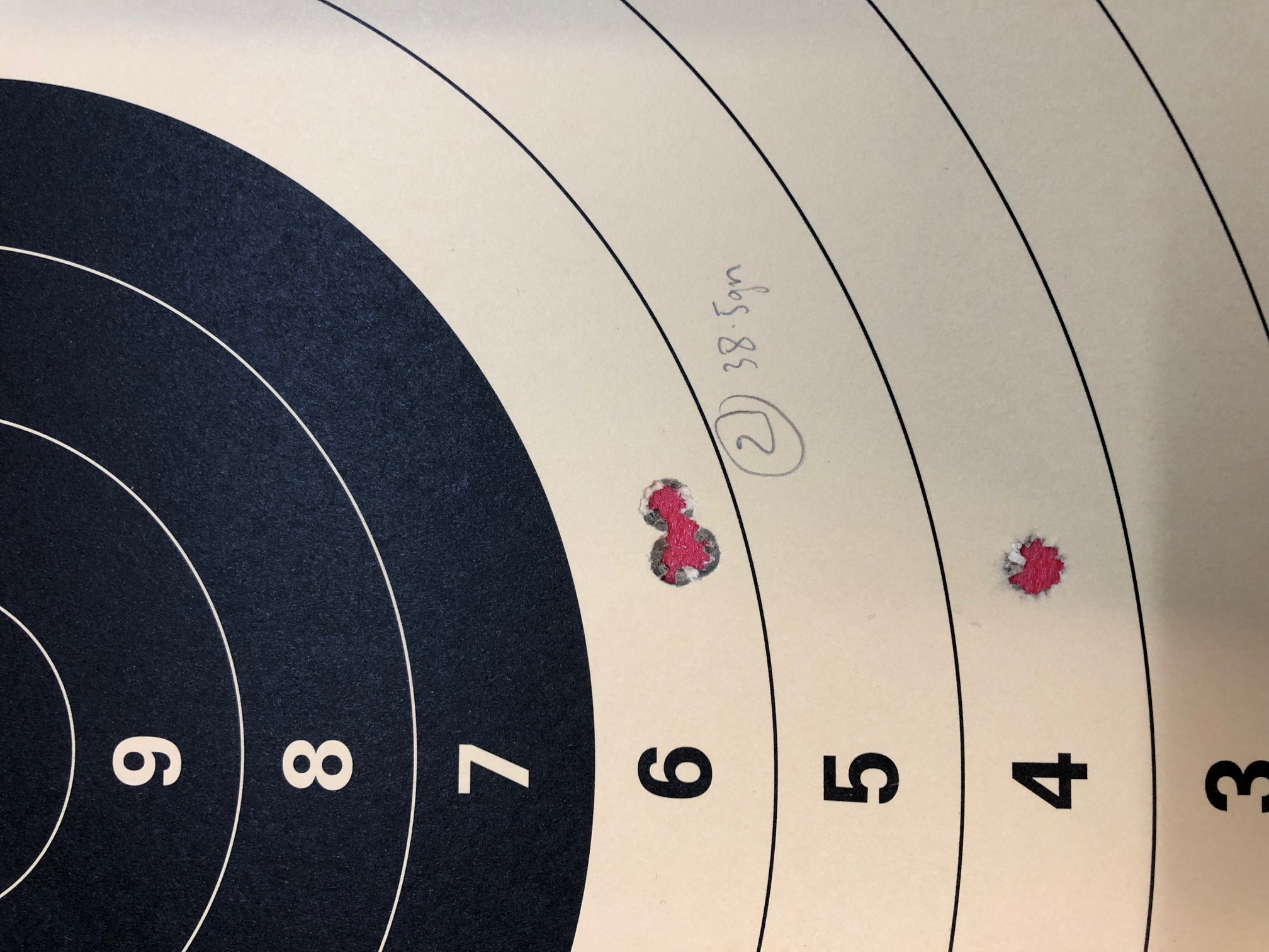

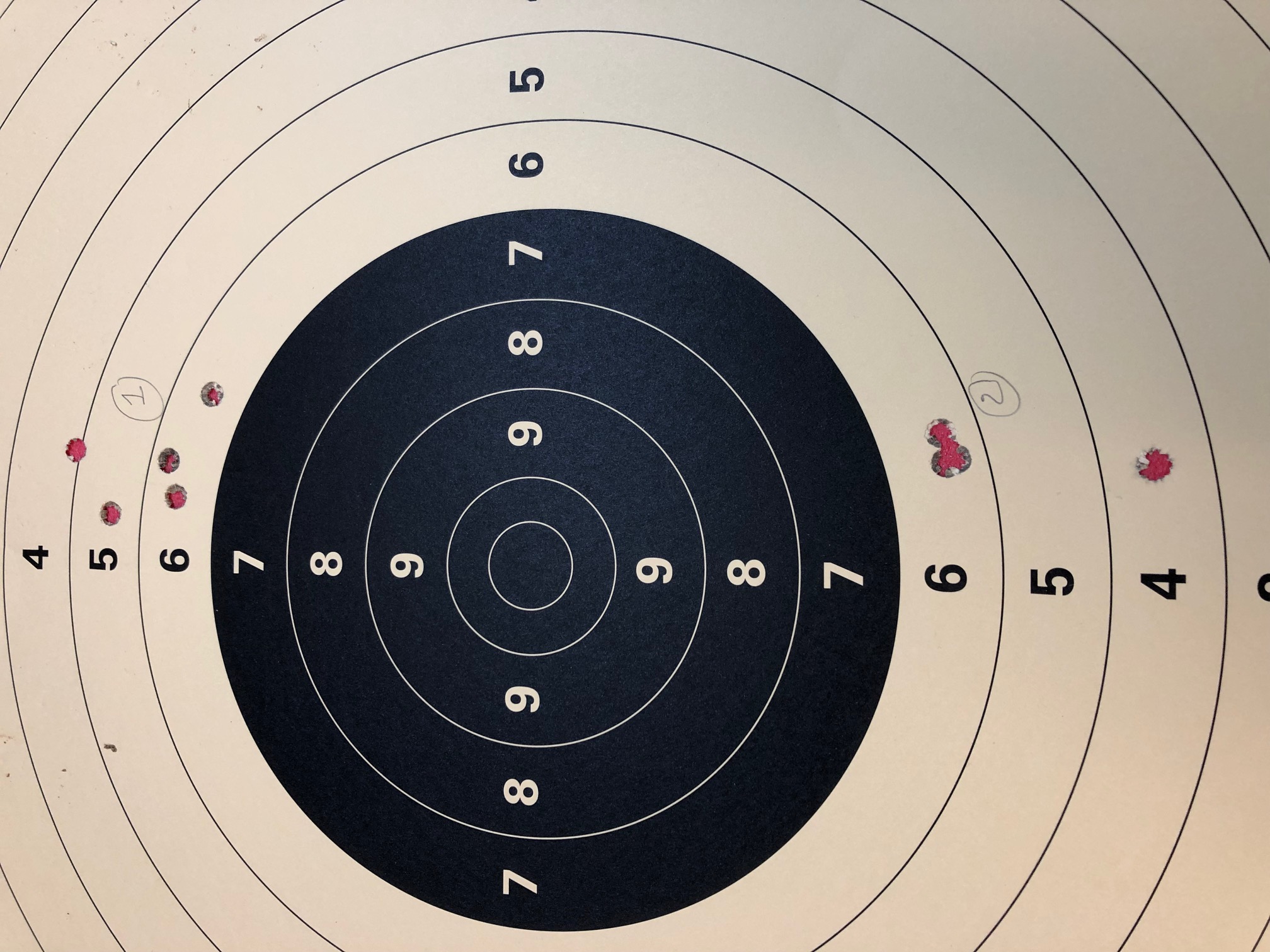

So I eventually did the ladder test, with 7 steps of 0.5 grains from 38gn to 41gn.
A bit disappointing overall, with a few atrocious loads and a few other loads doing simply as well as the factory PPU, but not clearly better.
Except... there was this load at the 38.5gn step that just managed to put 3 shots in the same hole - and a 4th one quite a bit below, but probably my mistake (and still perfect in windage).
LD 150gn BF 2206h.jpg (614.91 KiB) Viewed 3543 times
I hear what you are saying, it's likely to be just a fluke.
But still to be sure, I'll try again this 38.5gn load, this time at 100m with the necked size, trimmed, deburred and chamferred cases!

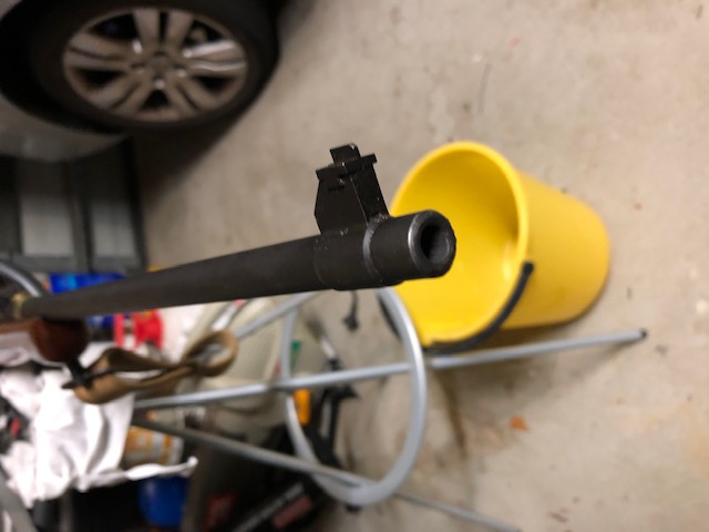

By the way the ring that was around the barrel has moved while shooting and now moving freely, good news, bad news, who knows ;)))!
(ps: the 4 shot group above is the 38gn load - much less impressive!)

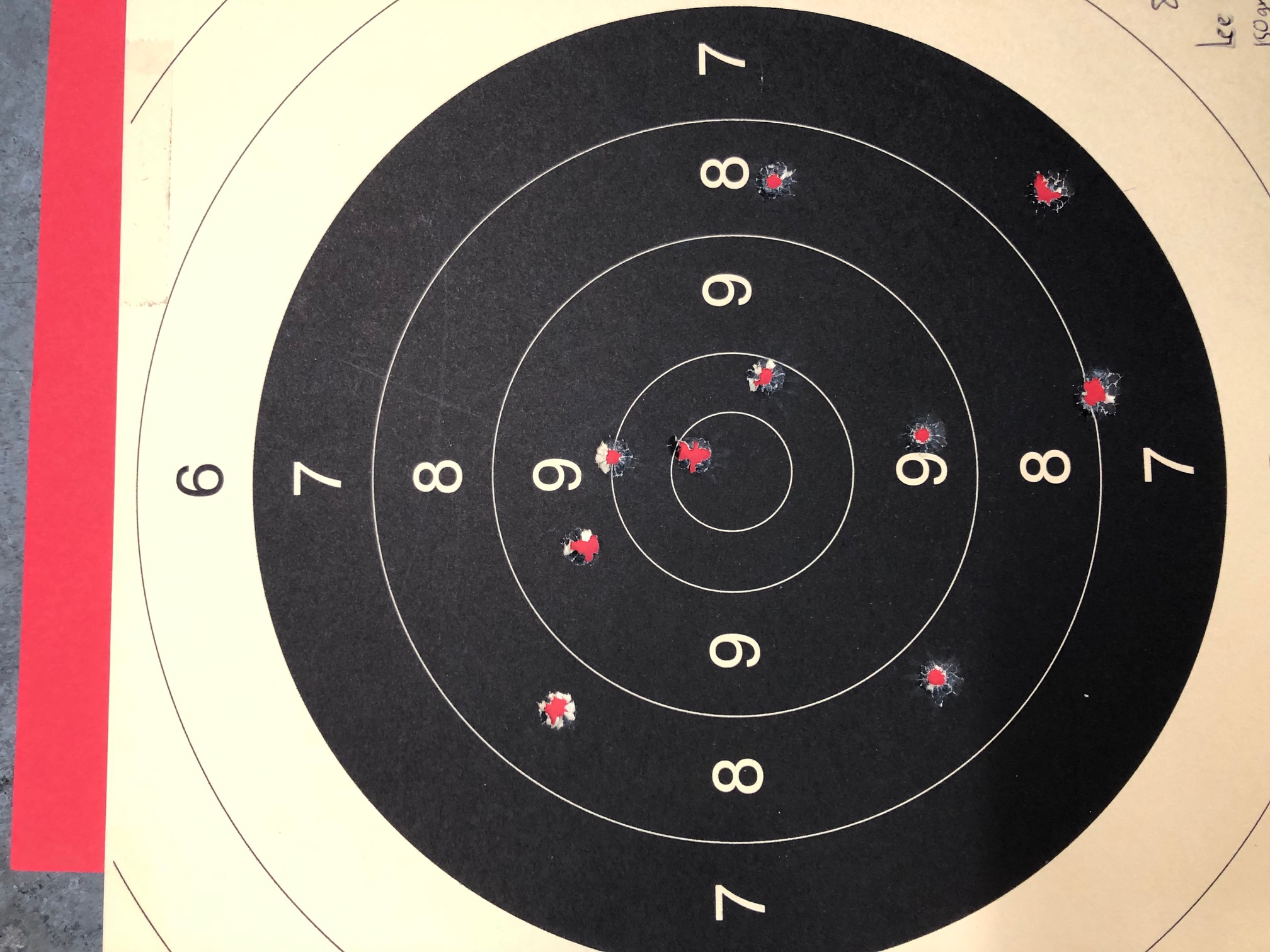

And to conclude on this topic, I have tried the 38.5gn load at 100m.

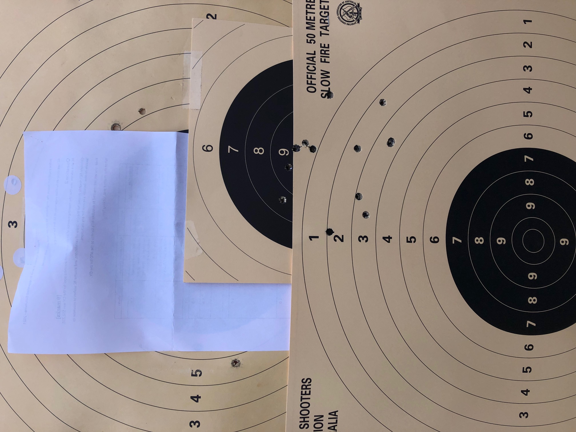

First attempt at a 10 consecutive shot series after a bit of mucking around for the sighting in (it shoots too high and on the right, had to use 2 targets as pictured, aiming at the bottom one, landing on the top one), a bit difficult at 7am with the rising sun in my face and changing light conditions.
ref target 100m.jpg (569.41 KiB) Viewed 3424 times
87 / 100, nothing extraordinary but I did not do better than this with an Swedish M38 that same morning. And that's better than what I achieved with my full-wood SMLE and PPUs!
The shots sprayed on the bottom of the visual were the last 5 of the series of 10.
Anyway it's good enough for me, I am sure I could do better but this target starts to be too small for my eyes at 100m.
This sporter is the cheapest rifle of my collection but I do enjoy shooting it, the shot placement is pretty consistent, mild recoil, good trigger, good sights.
How is that for a heavy barrel!!

What diameter is the bull (the 7-ring looks about 200mm)?
I could try mine on the same size bull at 100m.
Mine shoots close to point of aim at 50m, just a little high, which should be close to a 100m zero. I think I've learned all I need to with the scope at this point so it can come off and I'll start practicing with the open sights at 100m and 200m. 100m is normally shot standing unsupported, and 200m is shot sitting unsupported.

To answer your question, the 7 ring is 20cm. the diameter of the 10 is 5cm and the diameter of the bull is 2.5cm.
This target is very nice at 50 metres, but slightly too small at 100m I find.

Just a little high, about 30mm, with 2300fps 174gn loads. I can't say precisely how high it shoots at 50m as I've only fired perhaps a dozen groups with the iron sights, and being an SMLE the groups are not small, but I'm guessing it's hitting about 30mm high. I ran it through a calculator using a guesstimated BC of .450, (assuming 30mm high at 50m) and it should zero around 130m and be about 30mm high at 100m. If it's only 20mm high at 50m it'll zero around 110m and be 10mm high at 100m, if it's 40mm high it'll zero around 150m and be 50mm high at 50m. Either is easily near enough to consider it "zeroed" at 100m due to the probable group sizes being at least 100mm, and more likely closer to 150mm. The bigger issue is how my eyesight places the sight picture over the target I think. I use a diamond around 50mm to shoot open sights at 50m, but it's on the small side really. I'll do some diamonds from 100mm to 200mm to practice on at 100m to determine which is most suitable, but the actual target I'll be aiming at is the big irregular blob of the Figure 11 at 200m and the figure 12 at 100m and 300m, so no precise aiming point that can be seen with my eyes at 100m.
Being around 130mm high at 50m seems ideal for the military competitions I think (my mate's rifle already shoots like this). This would make it about 250mm high at 100m so hold on the bottom edge of the 600mm target at 100m. It would be about 270mm high at 200m so hold about a quarter up from the bottom of the 1200mm target at 200m, and should be about dead-on at 300. This would avoid making any sight adjustments. But I don't even know yet if the competitions are shot at 300 yards or metres, and I think it varies depending on how each range was set out. But ideally I should be able to find a sight setting that avoids making any adjustments out to 300m.
Yes, that period with open sights tended toward the shooter being able to see the target above the sights, so they wanted the bullets to hit well above the aiming point - sort of an "aim at the belt to hit the chest" setup. This was usually only out to about 300m though, then they tended toward hitting point of aim as ranges extended. If you measure your sights and plot them you should see two separate curves, a short-range curve, then it should have a "step" around 300m as it becomes a long-range curve. So you might do better to find a low aiming point on closer-range targets, or just ignore the range settings entirely and gather your own DOPE. Or put some weld on the front sight and file it down to suit the load you've settled on, but then I would expect the longer range settings to hit very low.
But it does seem odd that somebody would sporterise it and not adjust the sights to shoot to point of aim.
I have actually already painted some other military targets that have 200mm centre bulls, I'll take one out next time and see how I go on it.
