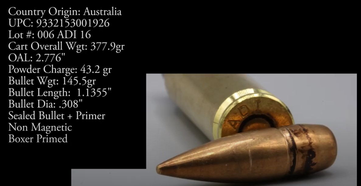

ADI 16, that’s my head stamp! But 43.2 grains of which powder??)

Vince24 wrote:ADI 16, that’s my head stamp! But 43.2 grains of which powder??)
08 probably.

Post by Vince24 » 28 Sep 2022, 3:59 pm
Yep - although I have heard that ammo makers sometimes blend different powder types together like French winemakers blend different grapes.

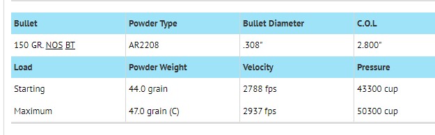

Over The Hill wrote:I am loading Speer 150g Soft Point Boat Tail Spitzers with 44g AR2208 which ADI lists at 43600 psi.
That seems like a mistake in the ADI table to me - look at the Nosler loads above, of the same weight. I reckon it's a misprint and should be CUP.

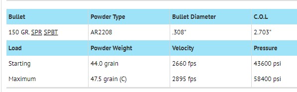

I agree, for some reason they're using Copper Units for the starting load and psi for the max load.
Screenshot 2022-09-28 181210.jpg (26.22 KiB) Viewed 7976 times
Screenshot 2022-09-28 181505.jpg (25.84 KiB) Viewed 7976 times
Still not a hot load though.

Post by Over The Hill » 28 Sep 2022, 7:40 pm
I am not so sure its a misprint
If I look at the ADI table for 150g speer SPBT with max 47.5g AR2208 nis shows pressure of 58400 PSI. If this was in fact a misprint and meant to be 58400 CUP then the pressure in PSI would be well north of SAAMI spec and I doubt that ADI would be publishing recommended loads that exceed SAAMI
In any case for the 44g load I am using whether 43600 psi or 43600 CUP (approx 48200 psi) it is in my opinion still a safe load for the No.4.

Post by bladeracer » 28 Sep 2022, 8:05 pm
The start charge is 43,600CUP, not psi, the max charge is 58,400psi. The error is in the use of two different measuring systems but listing both as psi.

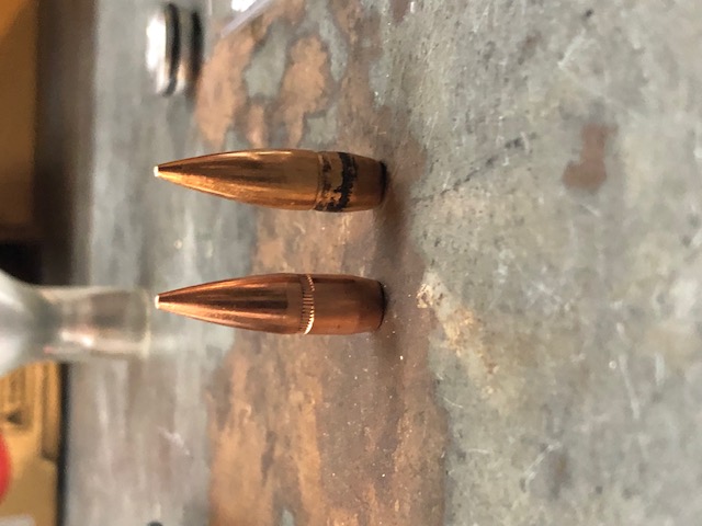

okay, upon request of the estimated audience :D , i have dismantled one of those ADI rounds.
The only surprise is that it has been super easy with the "inertia hammer" (or however you translate this in English).
Just two blows, easier than with my reloads, I was shocked. Yet my reloads are not crimped. :wtf:
Anyway.
so the bullet is 145gn as discussed (quite a different shape from the Hornady 3037)
And I found 42.9 grains of powder. May have lost a few in the hammer.

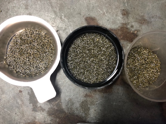

As to which powder, well not easy to say, see pictures.
From top to bottom you have the ADI powder, some 2206H and then some 2208.
It looks like 2206H but not 100% certain.

Vince24 wrote:As to which powder, well not easy to say, see pictures.
Top and bottom samples look identical to me.

Post by Vince24 » 29 Sep 2022, 7:53 am
The ADI father looked like 2206H to me but anyway, it has become purely academical by now.

SAAMI spec is 60,000psi for .308Win.
Out of interest I contacted ADI questioning their data in case of misprint. To my pleasant surprise ADI have replied with a letter that states: We can confirm that the data which you are referring to is accurate based on our records.
Full letter text below FYI as it contains some interesting info regards the accuracy of these published tables
Thank you for your enquiry of 28/9/2022 with regard to reloading using ADI Sporting powders.
Please find attached our latest test load data for .308 Winchester.
Owing to the effect of variations within allowable manufacturing tolerances for cartridge components made by different manufacturers, firearm variations and conditions, operating temperatures etc, pressures developed by any given rifle or pistol load can vary significantly from those that apply to our recommended loads. The two loads you are referring to have been generated at different times with different manufacturers component lots and in different barrels so there is likely to be some variation.
We note that there is no ‘rule of thumb’ to convert CUP to PSI so the two loads that you are referring to cannot be directly compared.
Older data and some of the load data supplied by Hodgdon Powder Company has been measured in copper units of pressure (cup), which is mechanically using a copper slug called a “crusher”. The crusher is placed in a fixture over the chamber where a hole passes through the barrel to the chamber. When the cartridge is fired, the resulting gases cause the “crusher” to flatten. The “crusher” is measured and the result is then converted to pressure by comparing to a tarage table. Our more recent data is measure in pounds per square inch (psi) by calibrated Piezoelectric transducers.
Our published test load data is only ever intended to be used a guide and you should always work your loads up using your components and firearm until you find your optimum safe load.
Ensure that you begin your load development at the suggested starting load. Carefully monitor your rifle and cases for signs of excessive pressure like badly flattened primers or difficult bolt lift.
Extreme caution should be taken and loads should be worked up accordingly. Refer to our website at www.adi-powders.com.au or our 10th edition handloaders’ guide for more information, warnings and reloading safety.
We thank you for using ADI Sporting Powders.
Yours sincerely,
ADI Technical Centre

Over The Hill wrote:Out of interest I contacted ADI questioning their data in case of misprint. To my pleasant surprise ADI have replied with a letter that states: We can confirm that the data which you are referring to is accurate based on our records.
Extreme caution should be taken and loads should be worked up accordingly. Refer to our website at http://www.adi-powders.com.au or our 10th edition handloaders’ guide for more information, warnings and reloading safety.
Yours sincerely,
Disregard it, they are wrong. Anybody that queries the irregularities in their published data gets the same response.
