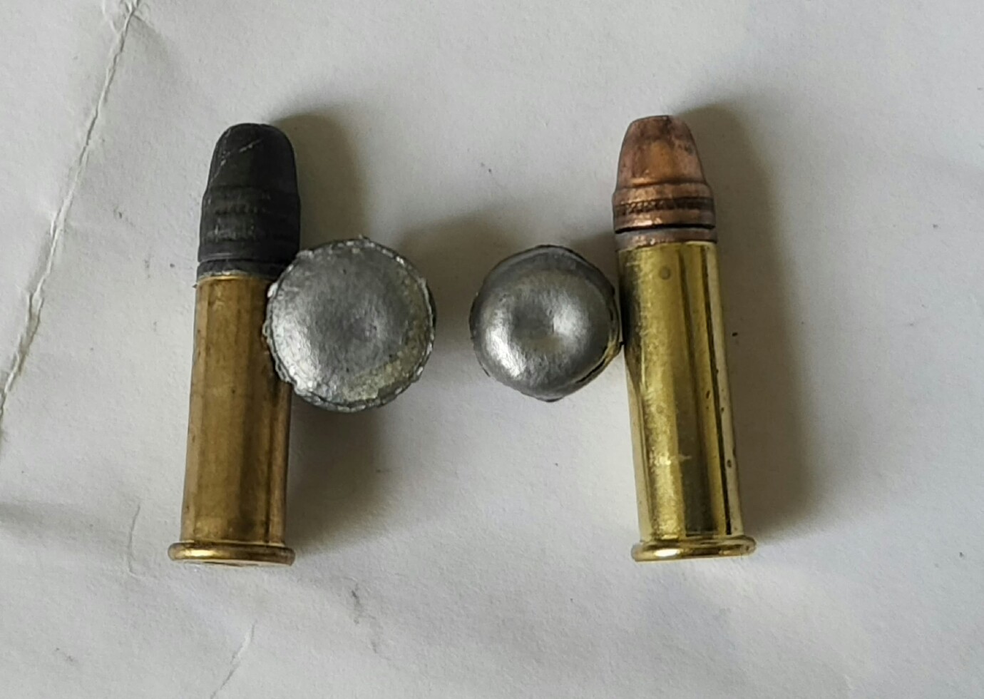

Thanks OB
I don't have a .308, yet but it's on my wish list, with the the V4 Multistrada :D, probably more chance of getting the .308

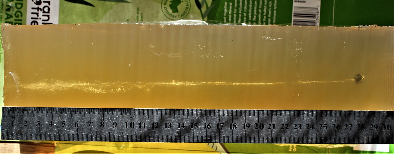

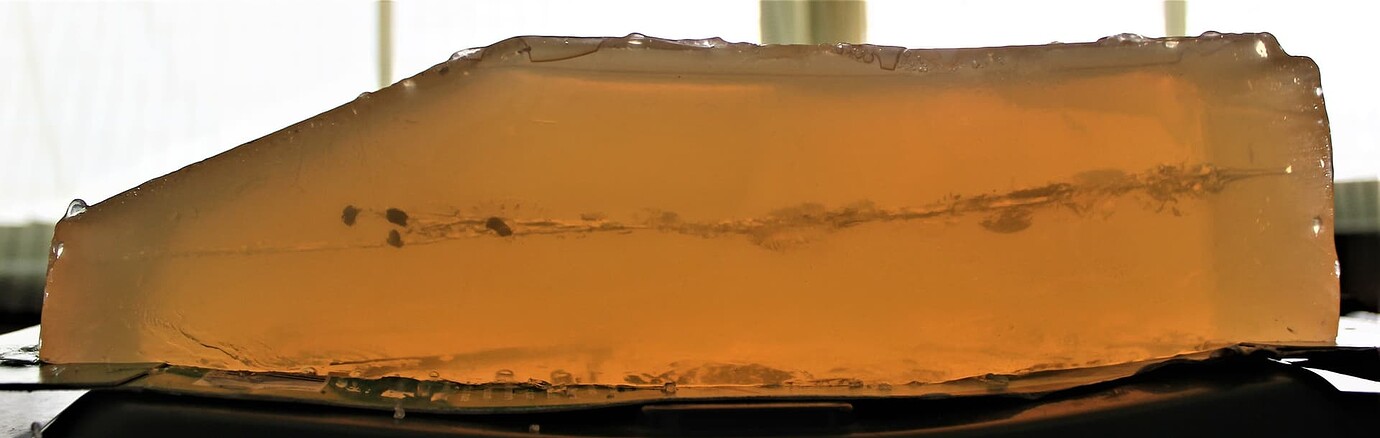

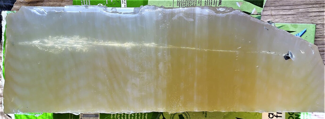

I do have subsonic HP and HV as well as Hornady 55gn RooMax which are pretty close equivalent.
The subs actually penetrated the gel farther than the HV.

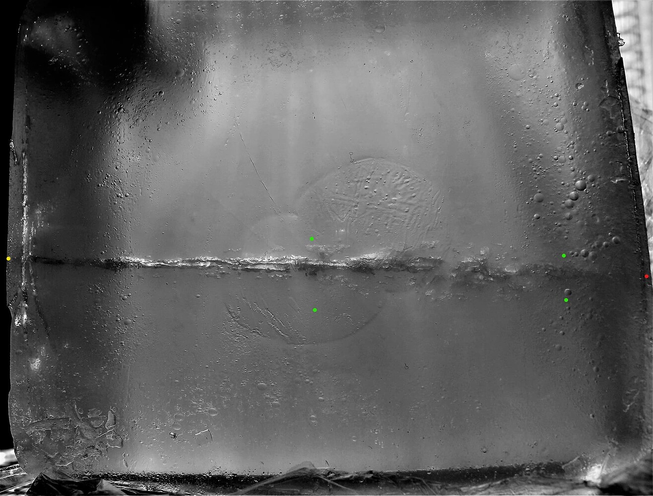

The first pics are the subs, apologies for image quality but I was using the wrong settings on my DSLR.
I was using much smaller molds during the first tests and the subs went right through the full 34cm.
Entry point is the red dot on the right, the 2 green dots indicate the maximum width of the permanent wound cavity.
Have got my poop in a group vis a vis the camera, the S&B HV pics are better

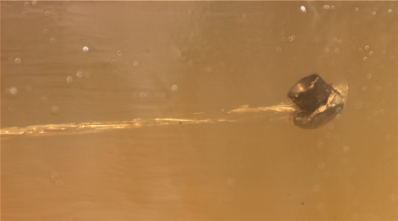

Next .22 was the Aguila Hypermax 30gn
e800b3b71a12a3f52480e061c5531e83fd0c6490_2_1380x768 (1).jpeg (94.09 KiB) Viewed 8665 times
Despite expanding less the Aguila made a better permanent wound.
I then tested the venerable Power Points
As the S&B 40gn subs were overpenetrating the small block I tested them at 75m

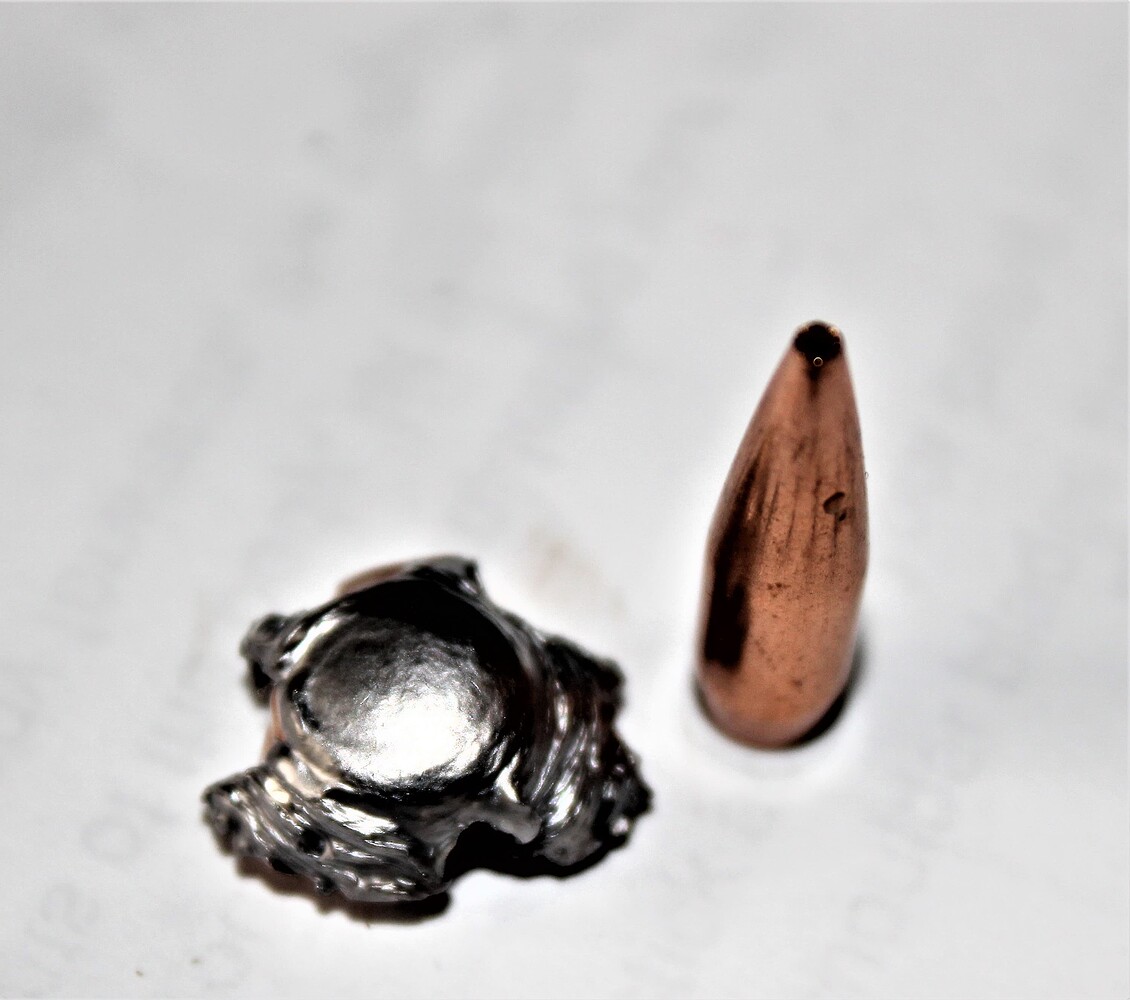

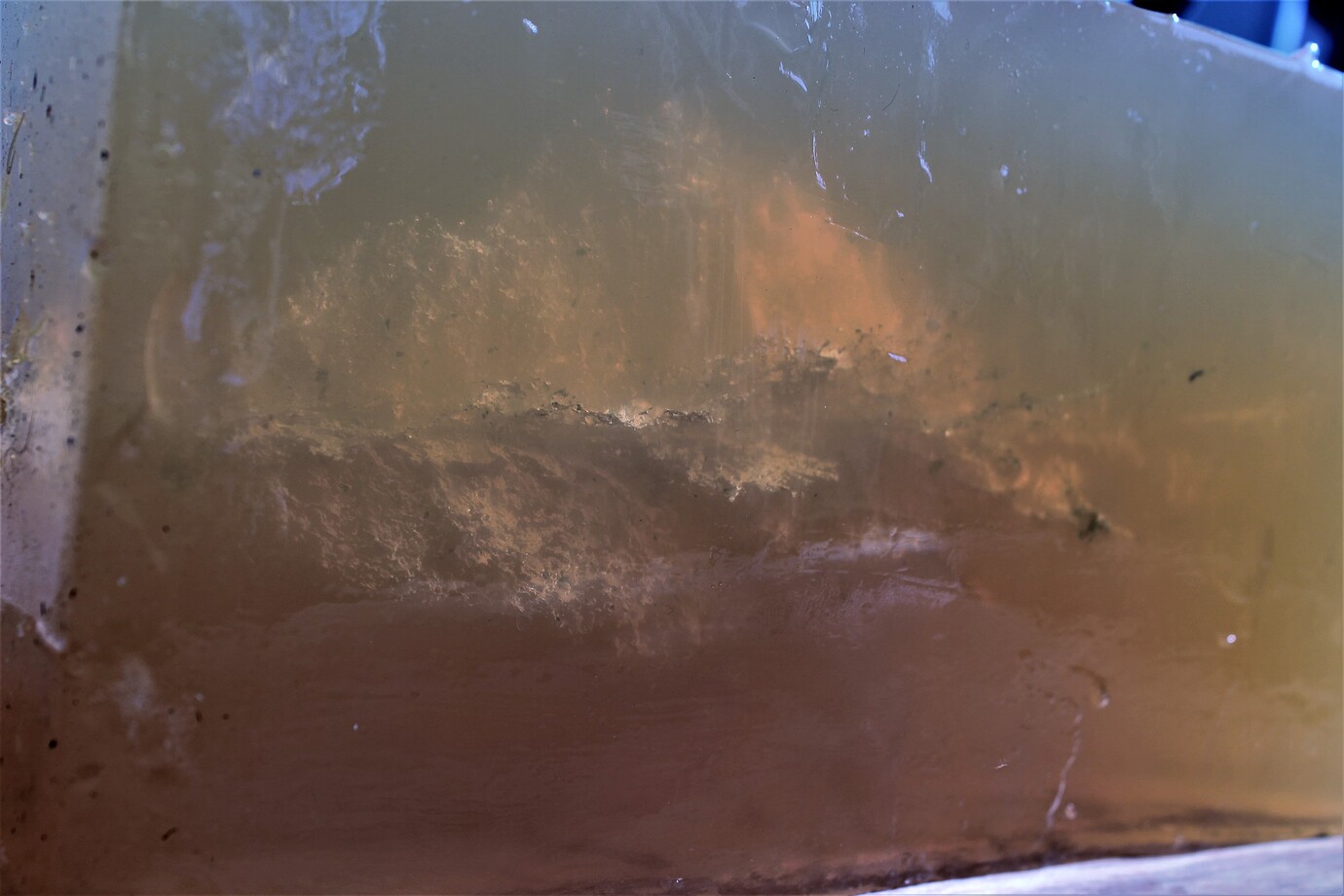

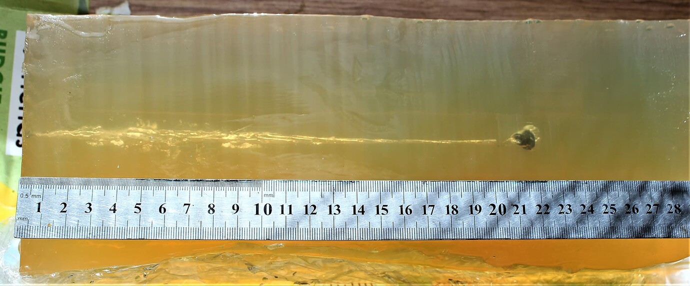

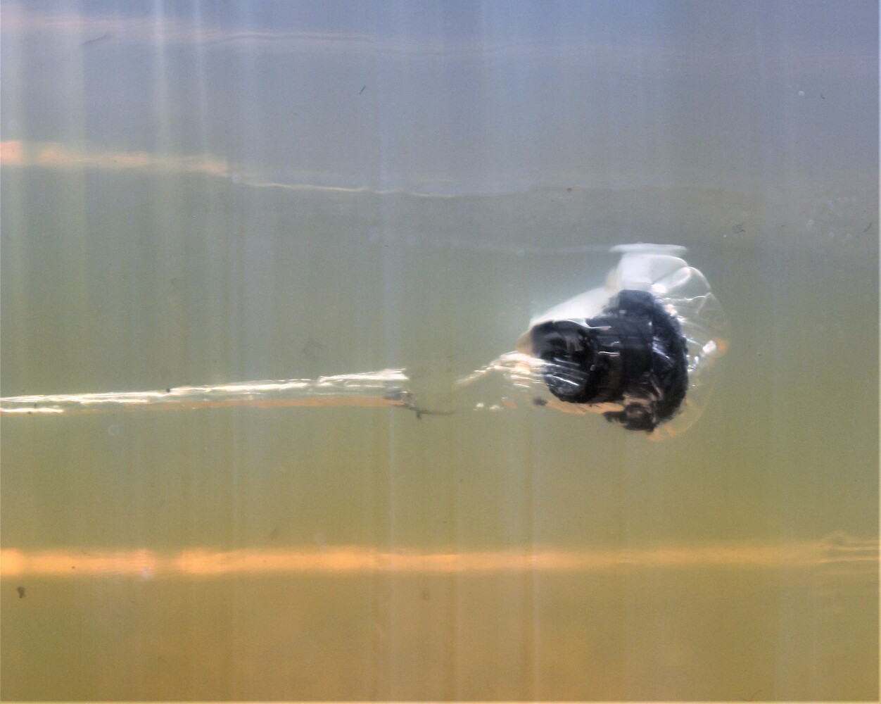

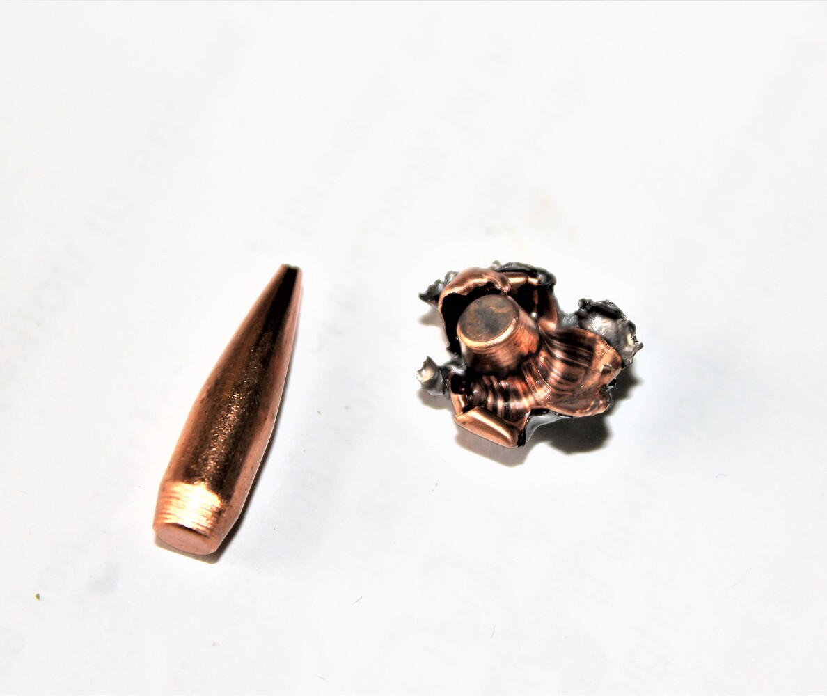

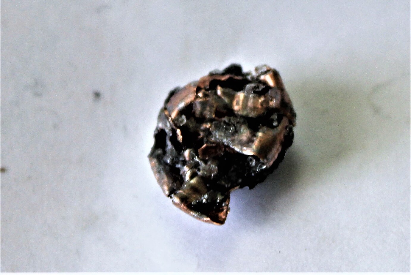

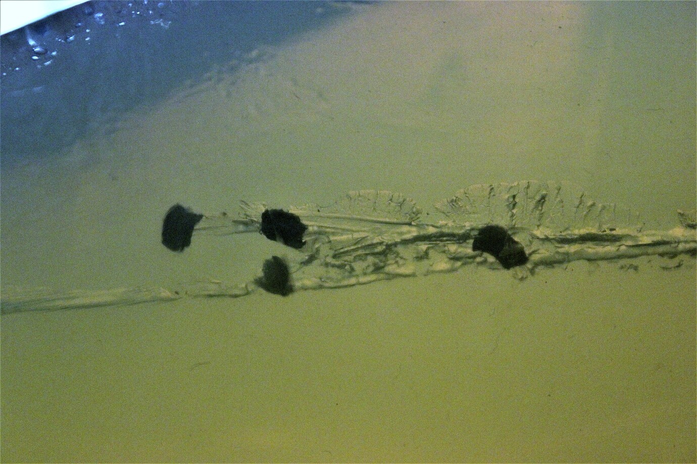

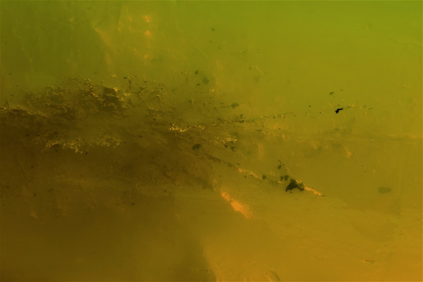

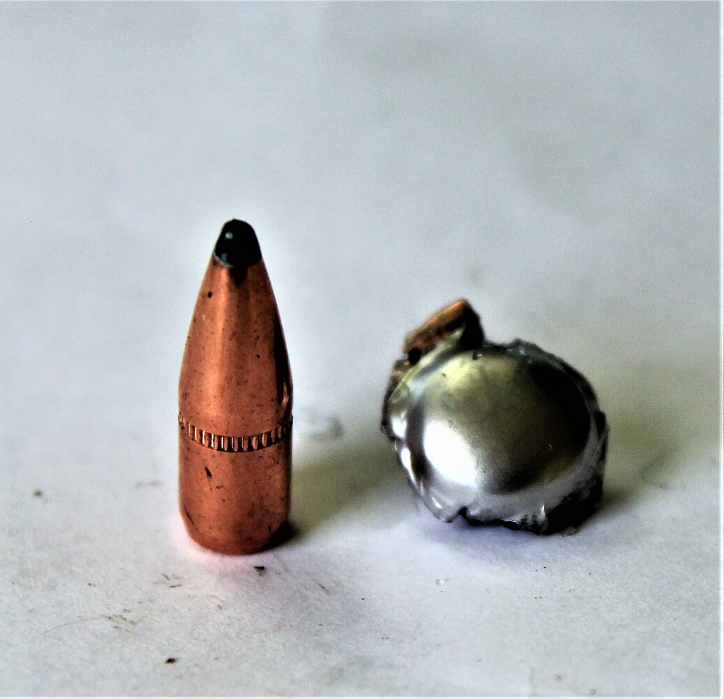

The Hornady 55gn RooMax at 100m
5feddb23c7b5ed0948b827984f721b9be7197b94_2_1380x920 (1).jpeg (117.43 KiB) Viewed 8664 times
bf7b6ec0daef439d820c9dd0352911d69ab9dce8_2_1380x920 (1).jpeg (154.35 KiB) Viewed 8664 times
5ca76eff3027e2732a9c85de60e5c65fb8d583a6_2_1380x536 (1).jpeg (104.57 KiB) Viewed 8664 times
0c9913e709893c23f466d4226eb8c84a6bb76d0f_2_1036x1000 (1).jpeg (195.16 KiB) Viewed 8664 times
Entry was from the right, for some reason I forgot to put the ruler in for scale but there was about 19cm of permanent wound cavity

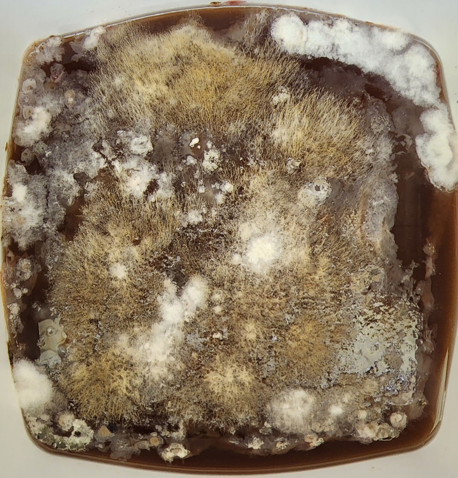

I looked at the clear synthetic gel but the price put me off so I used food grade gelatin powder which cost me $100 for 5x600g tins.
I made the gell up on 22nd July.
I initially had some mould and fungus problems when the weather put things on hold but on the next remelting after discovering that I increased the melt temperature to 70°C and added 10ml of clove oil to the full batch.
There hasn't been anything but the tiniest of surface only invasions since and I've dealt with them by wiping down with commercial sodium hypochlorite mould spray.

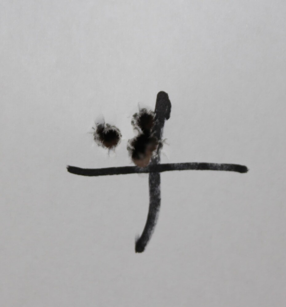

You should be happy with them Cooper.
My 24" Howa 9 twist gave me this group at 100 without any load development

They hit like a runaway train.

My first pleasant surprise was how accurate they are.
I didn't bother looking for the "ideal" load, just put the minimum, 23gn of 2206H under them and got the 5 round group below at 100m.
The flyer is doubtless my doing.
I did two tests, in the first test the block was somewhat dehydrated from sitting for over a week waiting for a break in the rain and I attributed the extra damage to brittleness from dehydration.
The results were quite impressive as below, with the projectile expanding explosively on impact and leaving a 20cm permanent wound cavity and the main body of the projectile travelling 36cm into the 41cm long block.

After rehydrating the block and giving it 2 days to set, I tested again today.
I didn't think I could have been more impressed than with the last result, but today's blew both the block and me away.
These are the most accurate and destructive projectiles I've ever used and I can't recommend them them highly enough.

G'day OB
No mate, I got busy and while I was looking the other way, the moulds and fungi had evolved resistance to the clove oil preservative in the jelly and turned it into something with all the charm of a month old corpse.

Post by Lazarus » 23 Dec 2022, 7:52 pm
When the snot monsters had turned the block into a fragrant syrup, I poured it down the toilet.
Then I started wondering what it might evolve into in my septic tank. :unknown:
