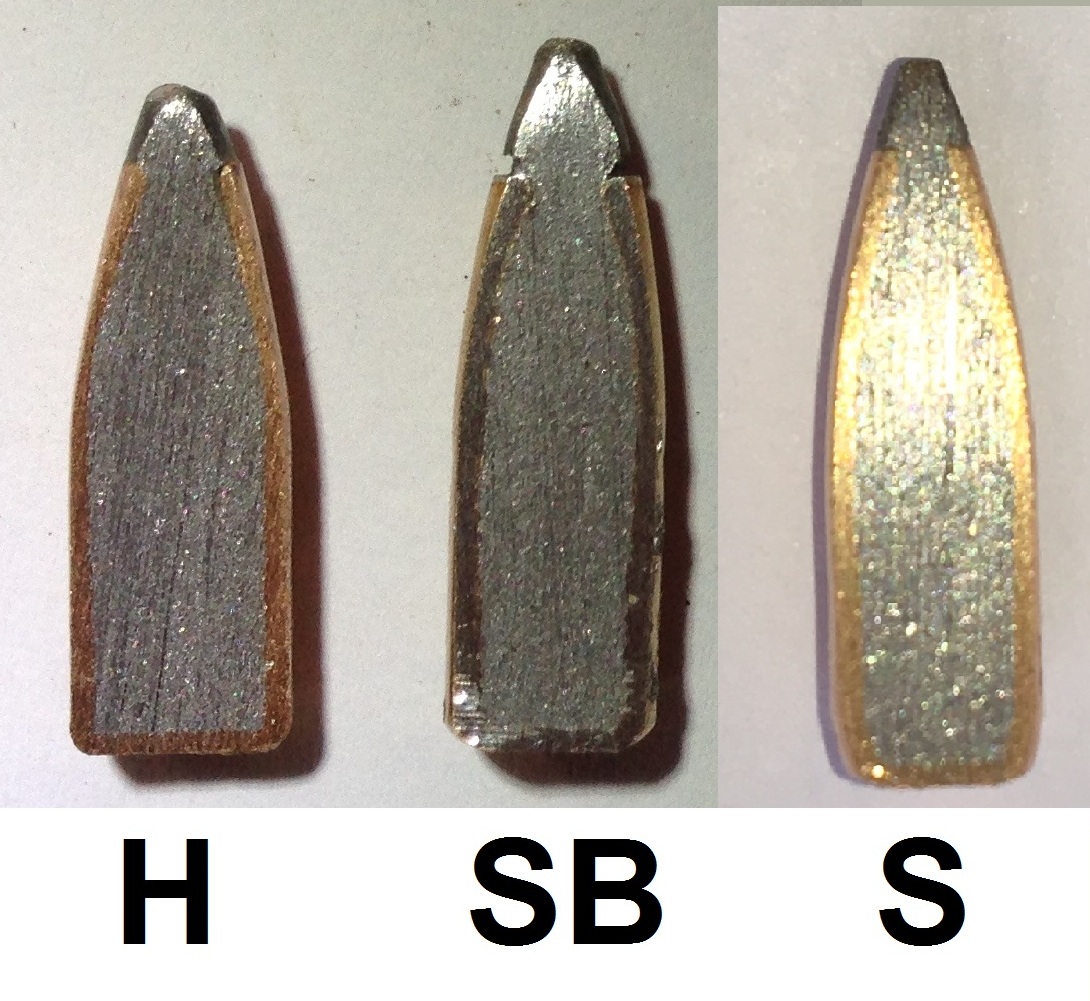

Here is 3 I cut a few years ago all 55gr SPs
L to R
Hornady Sellier Belliet Sierra super roo.
All very similar in construction.
