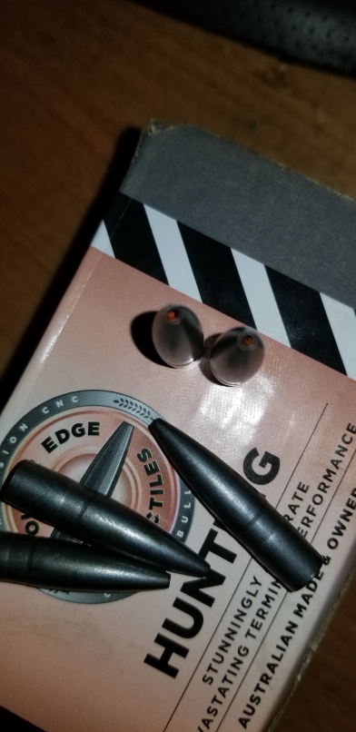

Bullets arrived today.
They are coated with something but they claim not moly. It does rub off on the inside of the boxes but I haven't noticed anything coming off on my hands while handling so far.
They are technically a boat tail I guess as the base is .270", but the taper is not very obvious.

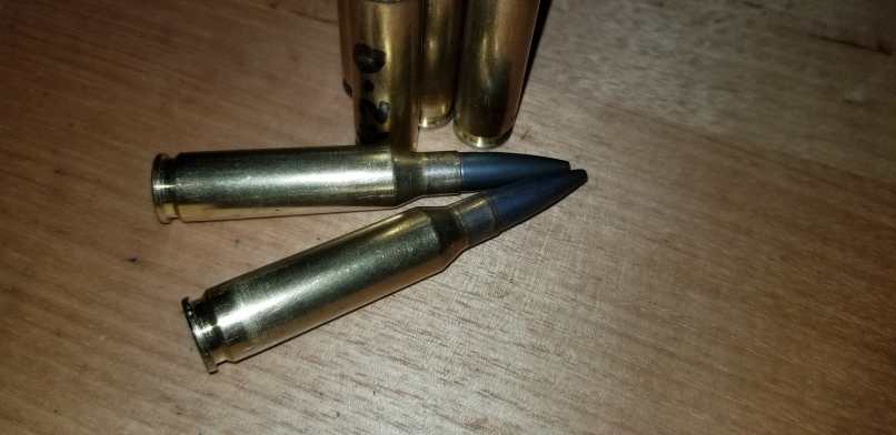

Post by bladeracer » 20 Dec 2022, 9:16 pm

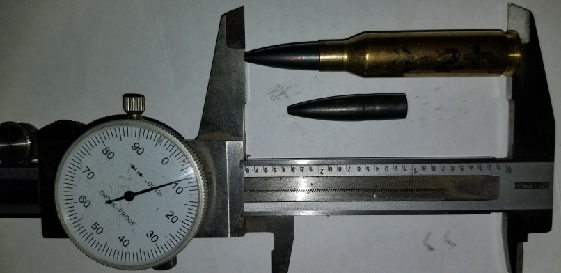

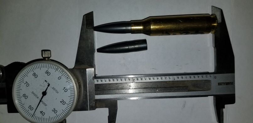

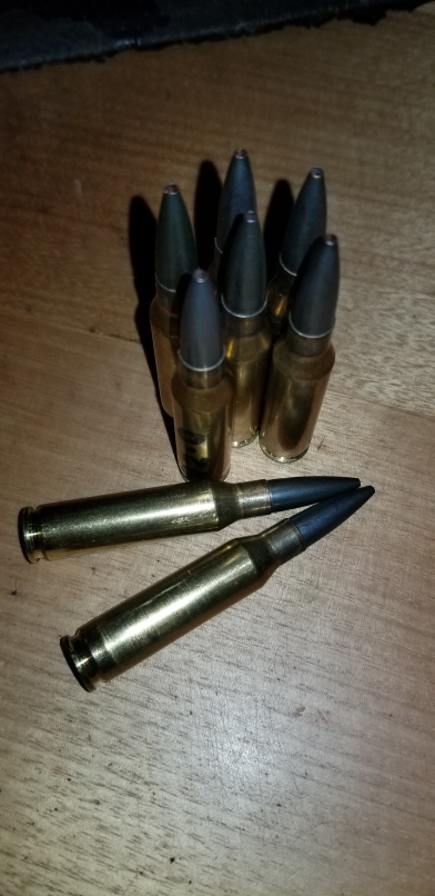

Loaded up eight rounds of 7mm-08 with the 130gn Outer Edge HP for testing.
The coating does indeed come off on your fingers, very grubby, and it scrapes off during feeding. I'm inclined to clean the crap off the rest of them. It's supposed to be a lube to reduce the pressure spike as the bullet slams into the lands.
One very strange thing about the design is that the bullet has a groove around the bearing surface. Reduces the diameter down to .278" over a length of about .150". Problem is that this groove, when seated to the standard 2.800" in 7mm-08 brass, is all inside the case mouth. The case neck is only about .250" long so there is all of .100" of case neck actually in contact with the bullet, all of it down at the bottom of the neck. This does not make for a tight fit in the case.
https://www.youtube.com/watch?v=3TJ4x6la-J4
I did measure length to the lands (in the Ruger American) beforehand at 2.900", but as this is for hunting I want to stay at 2.800". They recommend .040"-.060" of jump so loading longer would give a better grip, but I need to seat about .150" longer to get the full length of the neck gripping the bullet. Cleaning the lube crap off will probably improve grip on the bullet as well.

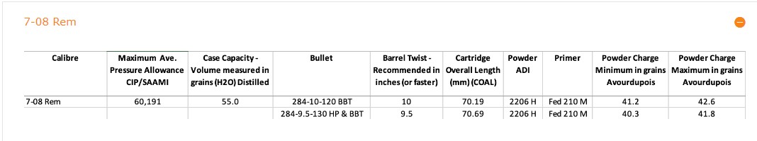

Their load data is 2.783" CoaL but seating the bullets another .17" is not enough to get a grip on the bearing surface forward of the groove. It just pushes the bottom of the groove closer to the shoulder making it even more loose.
Screenshot 2022-12-19 205508.jpg (38.27 KiB) Viewed 3841 times

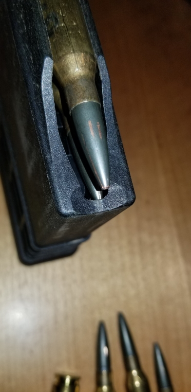

I cycled them through the mag twice and they feed fine with nothing to indicate the bullet might get pushed deeper during feeding. I'll test shoot them and decide if it's an issue.
So far I'm less than impressed, especially compared to the Barnes TSX and TTSX bullets.

Post by bladeracer » 16 Jan 2023, 5:08 pm
I've been battling to get out and test fire these things, every time I get close something comes up. But I had to shoot some 7.62x54R groups for somebody so I took the 7mm-08 with me. I wanted to check pressure signs and get a velocity figure to work with rather than worry about accuracy. Since I was shooting at a very odd distance of 50yd and had forgotten to put any fine aiming marks on the paper I just fired these at what I could see as folds in the paper. I fired half a dozen 120gn VMax's first to confirm the rifle/scope is working properly then fired the eight test rounds I'd loaded up. They all went pretty much where I aimed them so I can't say they're any less accurate than conventional bullets so far. Recoil was certainly noticeable, which surprised me. I should've taken some 145gn HotCore loads with me to compare the copper bullets to. The 120gn VMax was making 2850fps, these made 2840fps which is right around what I figured they should make, so that's good. The load was 41gn of AR2206H. No pressure signs at all but the primers are starting to square the edge. I'll load some more at 41gn and see how well they group at 100m before deciding whether I want to change the load.
The bullets are so loose in the case neck that pulling the bullet forward gives a CoaL of 2.946" and pushing it in gives 2.808", which is pretty ridiculous.
I was concerned that the bullet is very likely to push forward and hit the lands simply by cycling the bolt fast to chamber the round, as you would in a quick follow up shot. Likewise, being so loose I was concerned a bullet might get pushed into the case during feeding or under recoil in the mag. Both of these situations could spike the pressures. The velocities were all within the same ball park so I don't see any sign of this sort of issue yet.
I'm going to clean the coating off before working with these again as they really are filthy things, and I may try paper-patching around the groove to bring it up to .285" so the case neck can actually grip the bullet. Frankly it's a lot of messing about for a "premium bullet" but I'm still hopeful they may be a good close-range deer bullet. With the bullet floating about in the neck like it does I would have zero confidence in their reliability in the field.
