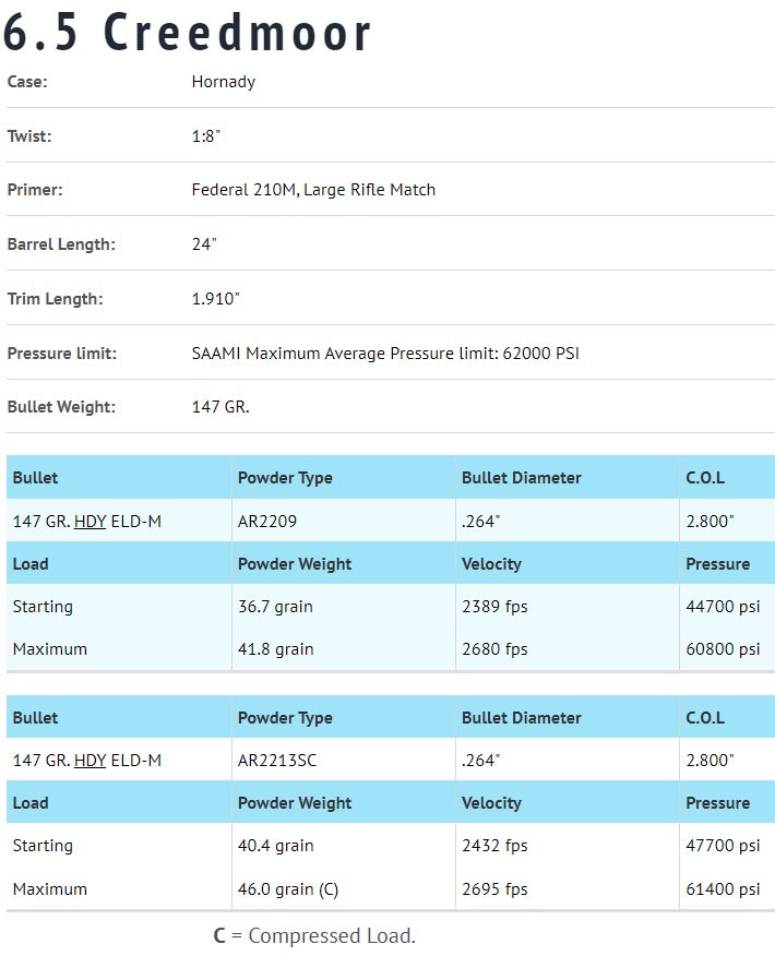

Interesting ADI have load data for the 147gr on their website now, only for AR2209 and AR2213SC

ash_hendo wrote:Interesting ADI have load data for the 147gr on their website now, only for AR2209 and AR2213SC
It would appear somebody at ADI is following this thread :-)
They just need some data for the 160gn RN now.

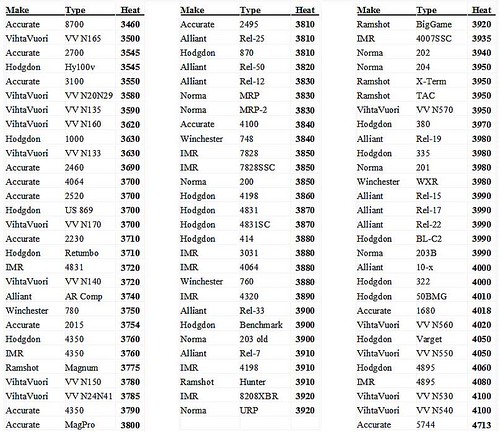

This is the Quickload list of powder flame temps in Fahrenheit. Not a complete list but gives you and idea.
Have a close look at where H4895 and Varget sit on the table.

Wyliecoyote wrote:This is the Quickload list of powder flame temps in Fahrenheit. Not a complete list but gives you and idea.
I'm not sure what those temperatures are relevant to, surely they would relate directly to pressures? If I load 20gn of H4895 behind 55gn bullets it's clearly a lot cooler shooting than 25gn loads.
But it's certainly interesting.
The Accurate 5744 is a massive leap up over the next powder on that list, its huge jump of 613F almost covers the entire 640F range of the 67 powders on the list below it. I looked it up and it looks quite useful. In .223Rem 18.7gn pushes 55gn bullets to almost 3000fps. In the .204 25gn pushes the 24gn to almost 4400fps. That's 5-7gn less than I'm using of AR2206H. Similarly in 7mm-08. It looks like something that might be worth trying.

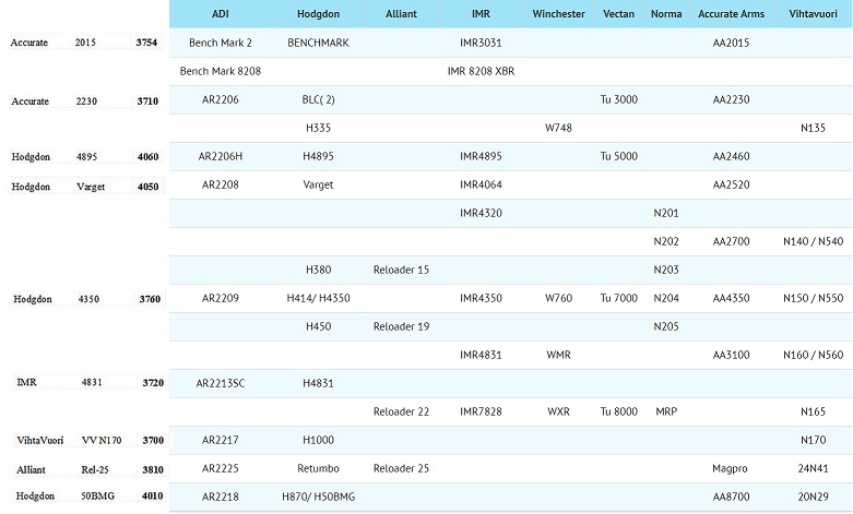

for those who want a quick comparison between ADI and that other chart....
This table appears to be a listing of "Specific Heat" for the various powders which will correlate with energy content although no units are provided.
The units should be in Calories or Joules depending on whether the calculations the figure is required for are done in English units or SI (metric units).
The "Specific Heat" is established by burning a quantity of sample powder in a closed bomb immersed in a water bath and is thus a measure of the energy the powder delivered in heating the water.
As stated in a previous comment the gas temperature in the chamber when a cartridge is fired is largely a function of chamber pressure and this table does not appear to be relevant.
I must admit that I know nothing about Quickload and could have things completely wrong. Also I don't ever recall coming across the term "flame temperature" in relation to smokeless powder.

ash_hendo wrote:for those who want a quick comparison between ADI and that other chart....
These are burn "rates", not temps. This is how quickly the powder generates pressure. This is important when related to bore volume or barrel length, and bullet mass. A 15gn bullet in an 18" .172" bore prefers a faster powder than a 250gn bullet in a 26" .338" bore.
