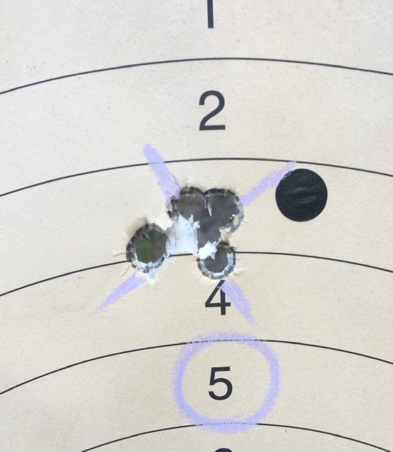

download/file.php?id=14792
Here it is…..6 shot group at 100m.
490gr Lyman .459 home cast over 31gr 2207 out of my 16” barrelled H&R Model 155 single shot I paid a carton for…
Pays not to generalise.
I’ll be more concise in the future for you.
Similar results with my Martini Enfield VTC Carbine (look it up) using home cast loads and my 310 tool.
.45-70 not accurate at all…..clearly.
‘Limitations?’ I think not.
Tank
