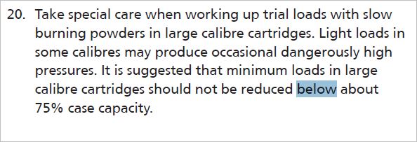

fast forward to 2023 and the reloading component shortages. I have 2208 powder and 55gr v max proj. ADI says min load is 23grn. OAL at .2130. Seems to be a compressed load. Mag length will allow AOL of .2190. Still a full load. I,m not keen to start at that, so I plan to start below that min level. Anyone loading with 2208 and what range are you at.

BNR964 wrote:fast forward to 2023 and the reloading component shortages. I have 2208 powder and 55gr v max proj. ADI says min load is 23grn. OAL at .2130. Seems to be a compressed load. Mag length will allow AOL of .2190. Still a full load. I,m not keen to start at that, so I plan to start below that min level. Anyone loading with 2208 and what range are you at.
It's not a minimum load, it's just a suggested starting point. There is no issue with going below it if that better suits your purpose. Compressed is good too.

You can safely further reduce you loads using ar2208.
I'm just unsure what is considered max capacity. But assuming 24gr is max capacity you can go down to about 18gr.
And I would not consider 222 a large capacity case.
Reduced loads 75% of Case capacity.JPG (39.94 KiB) Viewed 5869 times
