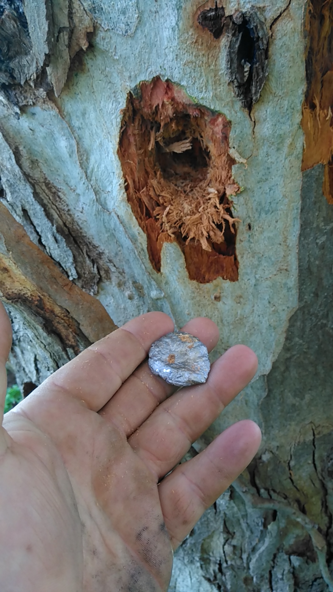

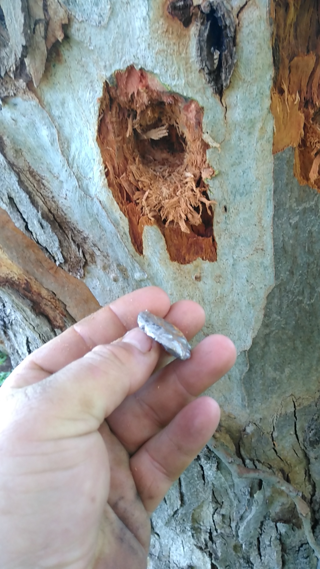

Post by bigpete » 15 Jul 2016, 5:27 pm
here's s round ball I dug out of the tree as you can see it flattened out considerably
