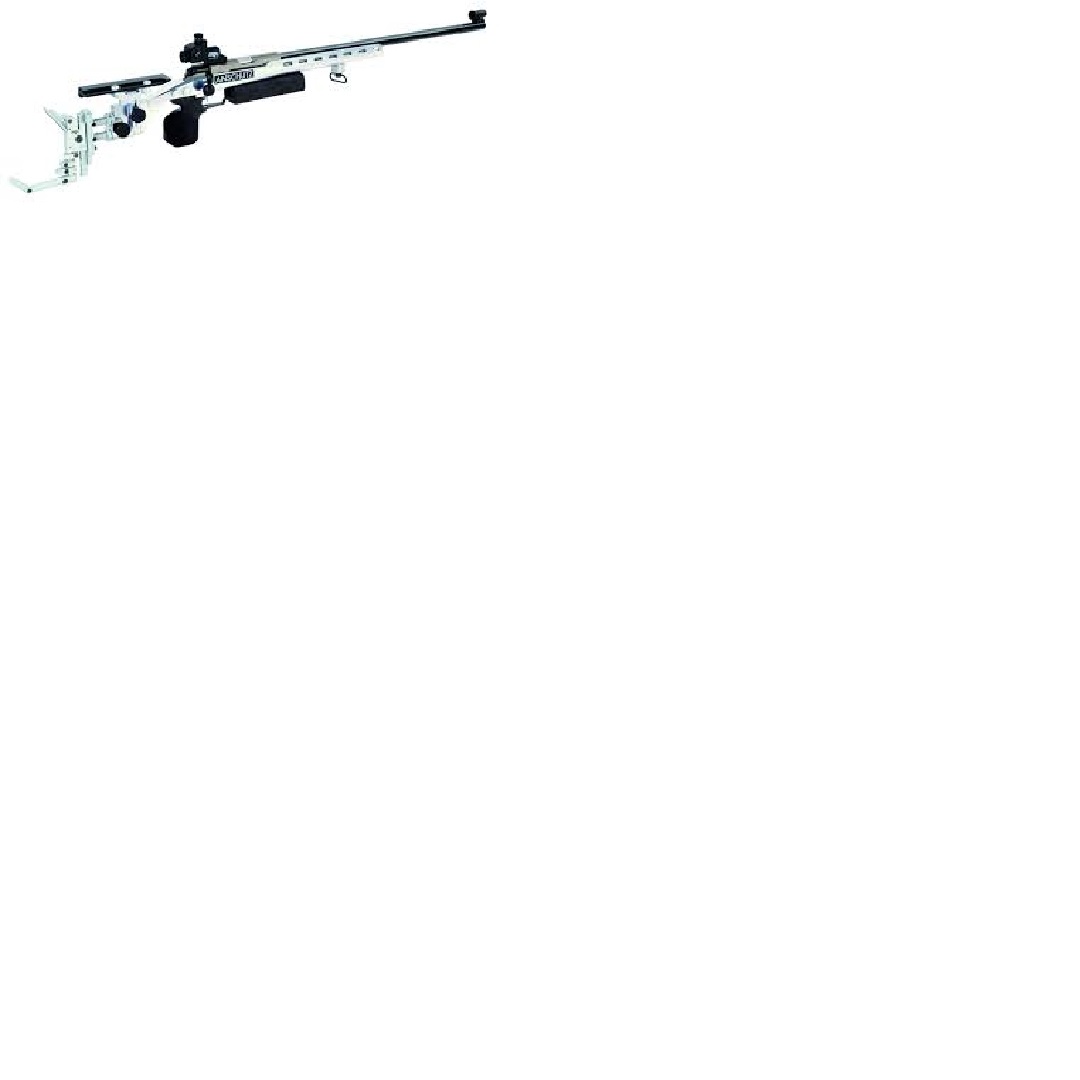

This is the type of rifle used.
3 p rifle.jpg (34.38 KiB) Viewed 10525 times
Now do you see why I don't think a Marlin Cowboy in .45-70 would be suitable.

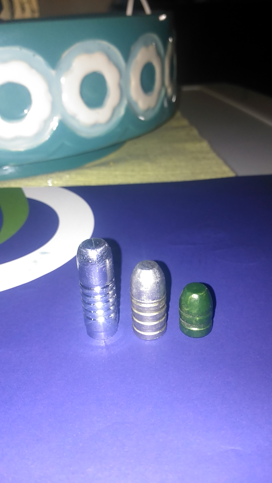

So here's the 570gn,405gn, and a 225gn 44 mag lined up
Posts: 4182
