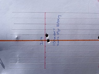

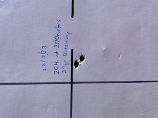

Post by Bello » 24 Jul 2023, 1:33 pm
Took the new guy (Tikka 204 stainless hunter), for a range day.
I sold my Sako VLS (Varmint laminated stainless) in 204 Ruger some years ago. I wasn't using it, so out it went.
Lately my young fella has been nagging me about a 204.
So I bit the bullet and bought a second hand Tikka from Used guns, just so he can have some fun.
Took it to the range for a work out with some old 204 ammo I had loaded for my Sako.
Had a fun morning.
204 100 meters (2).jpg (16.78 KiB) Viewed 7835 times
204 200 meters (1).jpg (15.78 KiB) Viewed 7835 times
Bello

Post by animalpest » 24 Jul 2023, 2:37 pm
Unfortunately the CoP for kangaroo shooting lists the 40gr bullet for use in the .204. If not roo shooting, then shoot the bullet that suits you best.
Loading 8208 with the 35gr suits the Sako. The Sierra 39gr will normally shoot very well in most rifles.
The primer does not need to be a magnum. If you see "magnum" on the cartridge, that doesnt mean much.

Post by Bello » 24 Jul 2023, 4:23 pm
Hi Guys
I have some 32gr Sierra Blitzkings on hand. Might want to try and see how they go. My rifle has a 1/12 twist.
Have any of you tried them, are they accurate.
Any advice appreciated.
