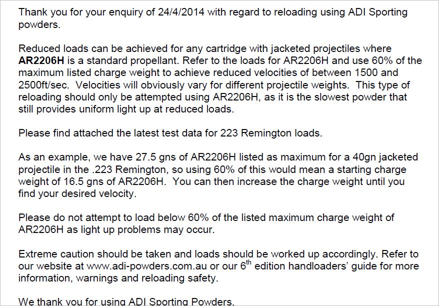

For the purpose of clarification. After asking about reduced (light) loads received this in 2014.
ADI letter.JPG (151.33 KiB) Viewed 7434 times

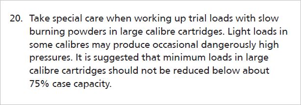

Also this is in the ADI manual page 31. You can load below the recommended starting load, just not too far below.
