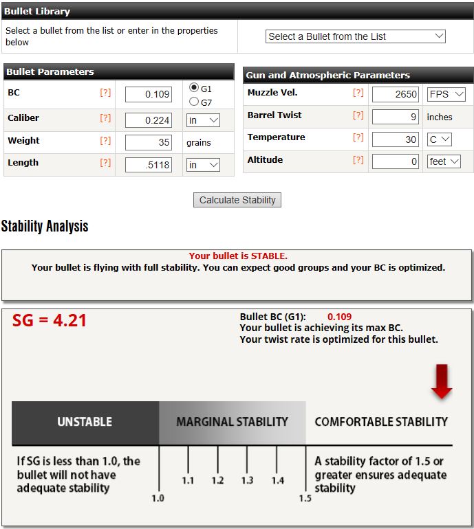

Again back to the original post, the twist rate is too fast for the short 35grn projectile, it is being spun too fast and cannot stabilise over its length, velocity changes are not going to fix this :thumbsup:
Apologies if a little out of context but lower velocities will reduce the projectiles RPM hence why backing off the load on my 22-250 a touch stopped the dreaded grey mist 6' out from the muzzle :)

Berger has a stability calculator on their site and I punch in what info was available and made an assumption on the BC based on the NTX version of the same weight bullet. The general rule is the heavier the bullet the faster you need to spin it rather then the opposite although there are optimal twist rates for each projectile but generally the manufacture's chosen rate works across a broad spectrum of types and weights.
http://www.bergerbullets.com/twist-rate-calculator/
Jump in if I've messed up the math as I'm keen to see if this problem can be sorted as I have the same rifle and a pile of 35gr projectiles I'd like to try out myself. That was the plan a while back, then I thought bugger it and bought a .17 Hornet :)
Even at 1000fps it's still listed as stable....
