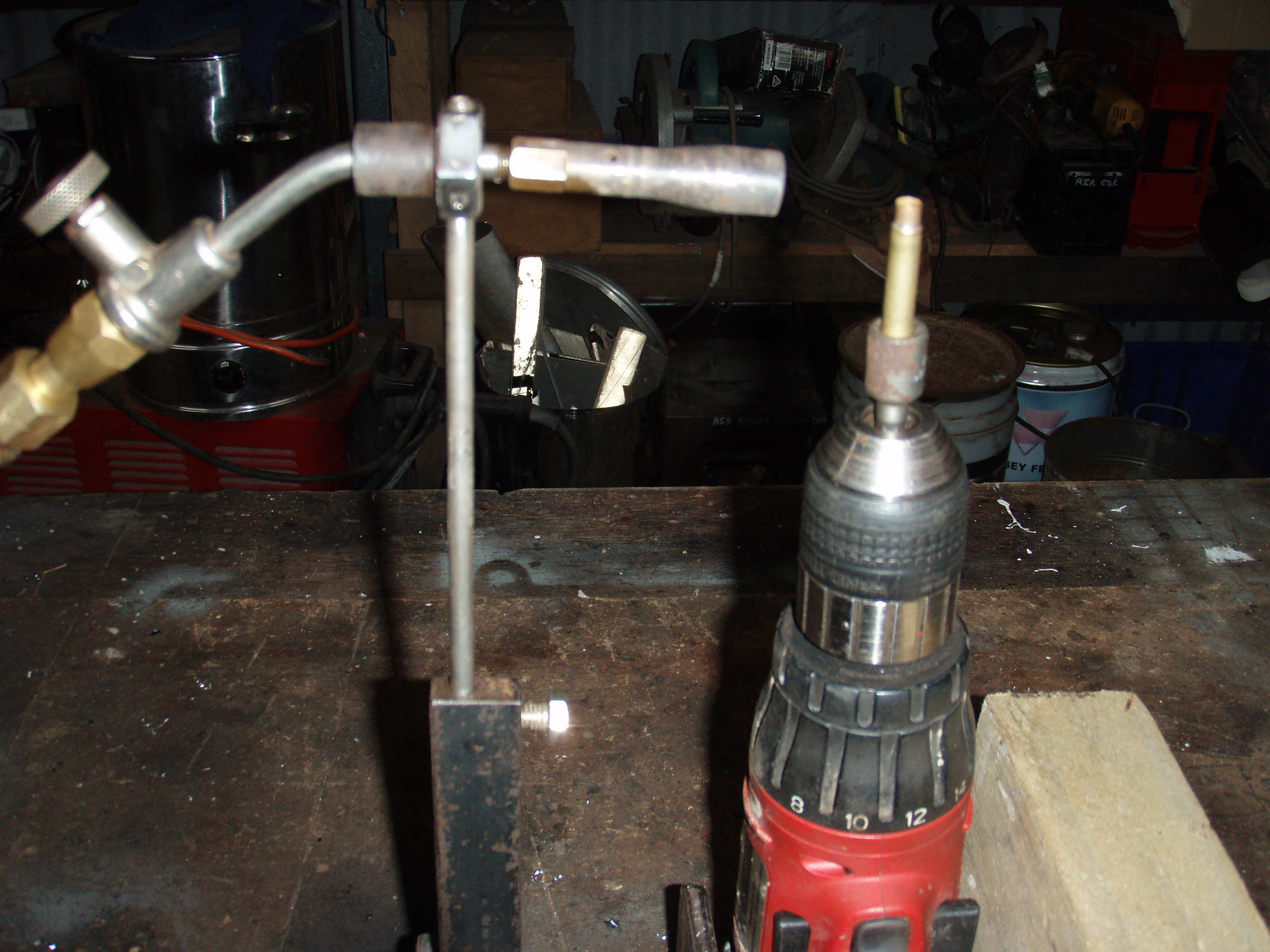

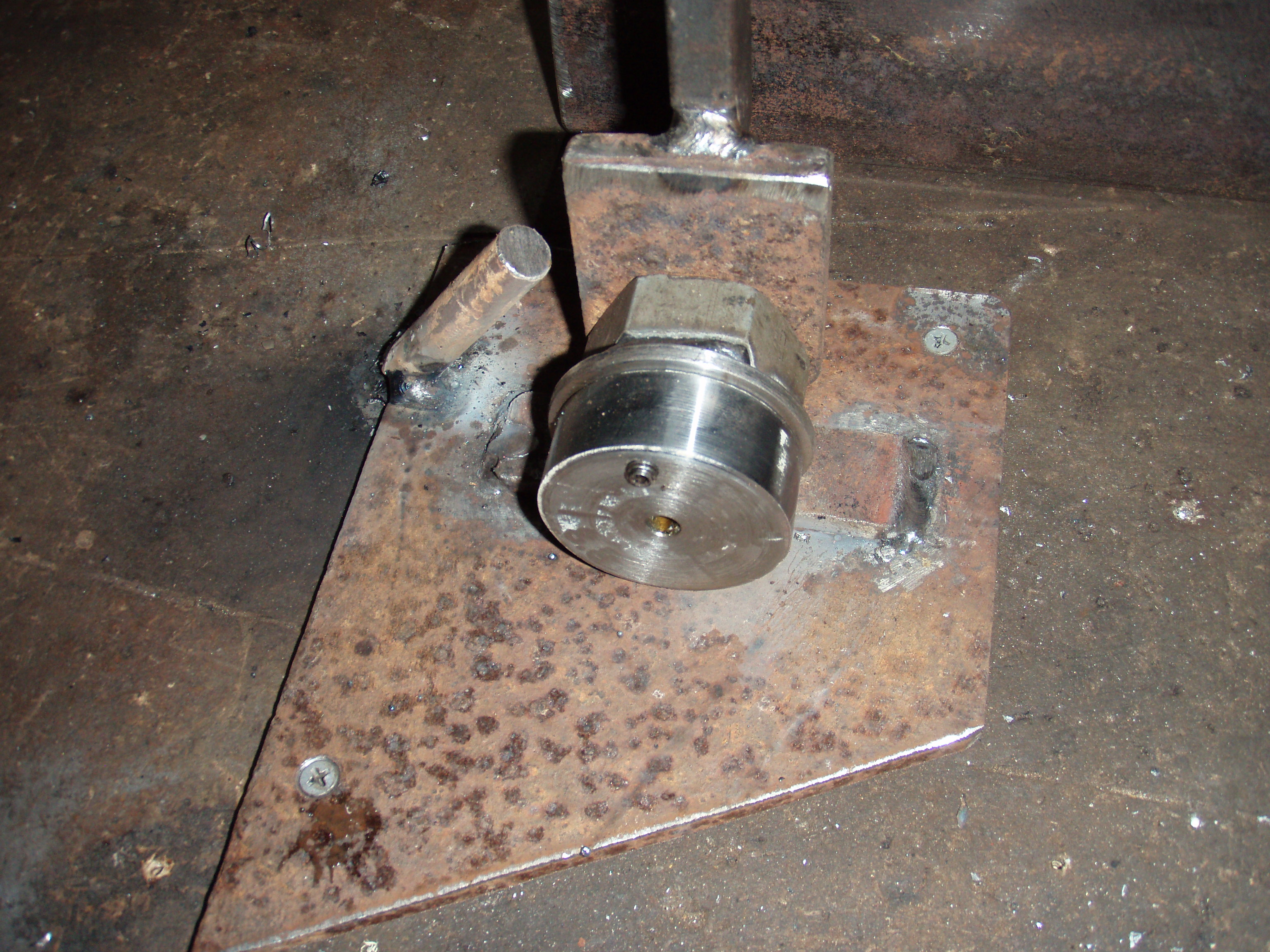

Post by Bills Shed » 03 May 2018, 3:13 pm
Swinging base
Case in position
As you can see it does not look pretty but it is as solid as. The trigger of the drill is just wired down so that it rotates approx 30 RPM or whatever you feel gets an even heat. The case holder is nothing more than a tec screw driver of the appropriate size. The drill is supported in its own cradle and so is steady and you do not touch the drill during the process once set up. Light the heating torch, put case onto spinning tech driver, swing heating torch into position, do your count, swing away heat and flick case into water.
Bill

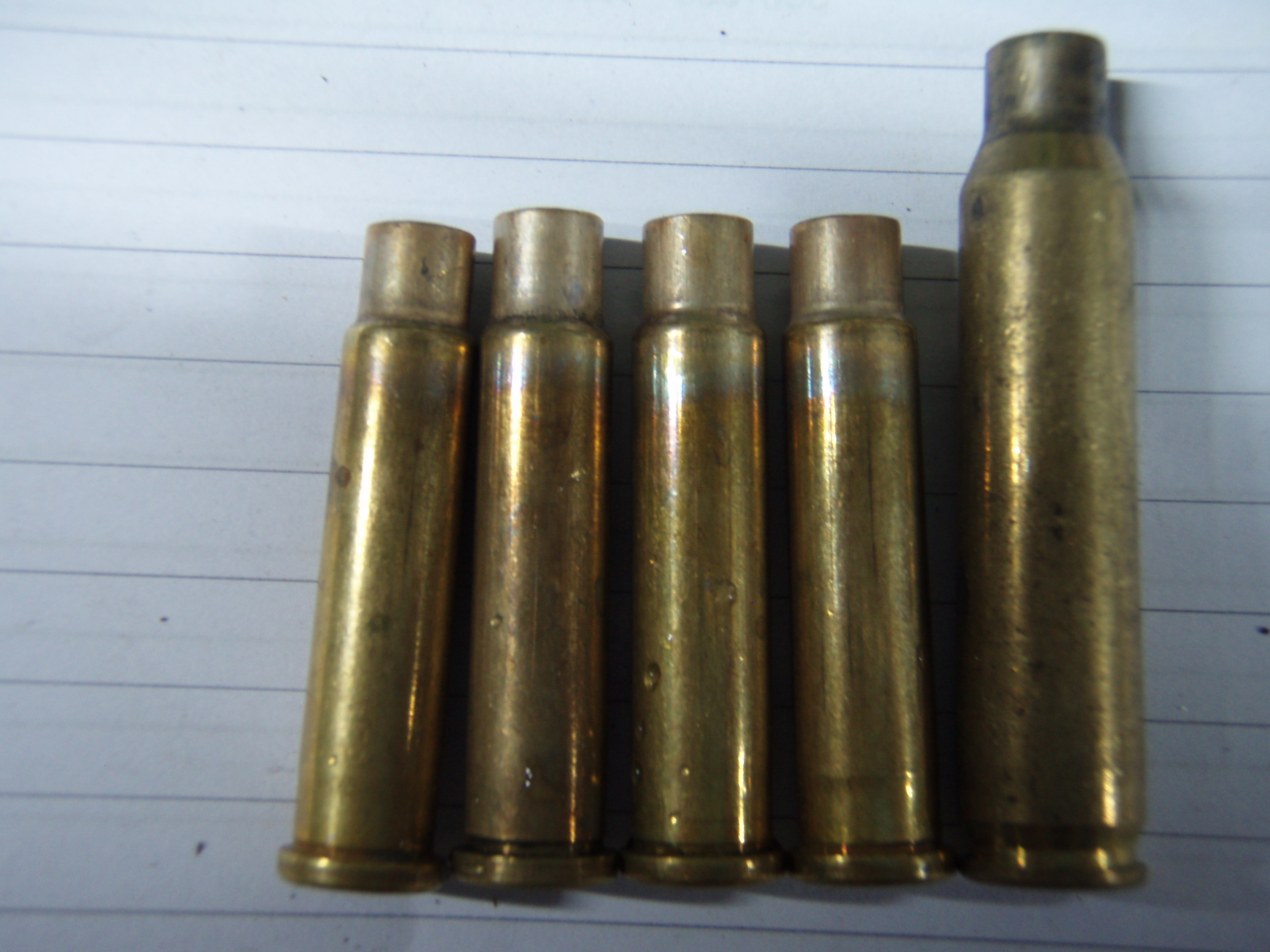

Re: How do you anneal your cases...?
Post by Bills Shed » 03 May 2018, 6:17 pm
Yep bloody thin, I actually did try a cig lighter!....not quite. As to annealing the hornet, it is quick. Darkened room, keep an eye on the colour of the neck, the dullest of red is more than enough. Depending on how you set up your heat source, about three seconds would be about it so do not hang about. Bigger cases, longer time. You may lose a case or two in the set up but you learn real quick.
Bill
Annealed KHornet cases
Bills Shed

Post by Bills Shed » 03 May 2018, 6:37 pm
bigrich wrote:thanks bill. might look into getting some sort of small hobby gas torch specially for the hornet .how often would you advise annealing standard hornet cases ? cheers mate :thumbsup: :drinks:
That is a bit of, how long is a bit of string, but for a mild load and to be a bit preventative in regards to cracked necks, I anneal the hornet every three firings.
Bill
