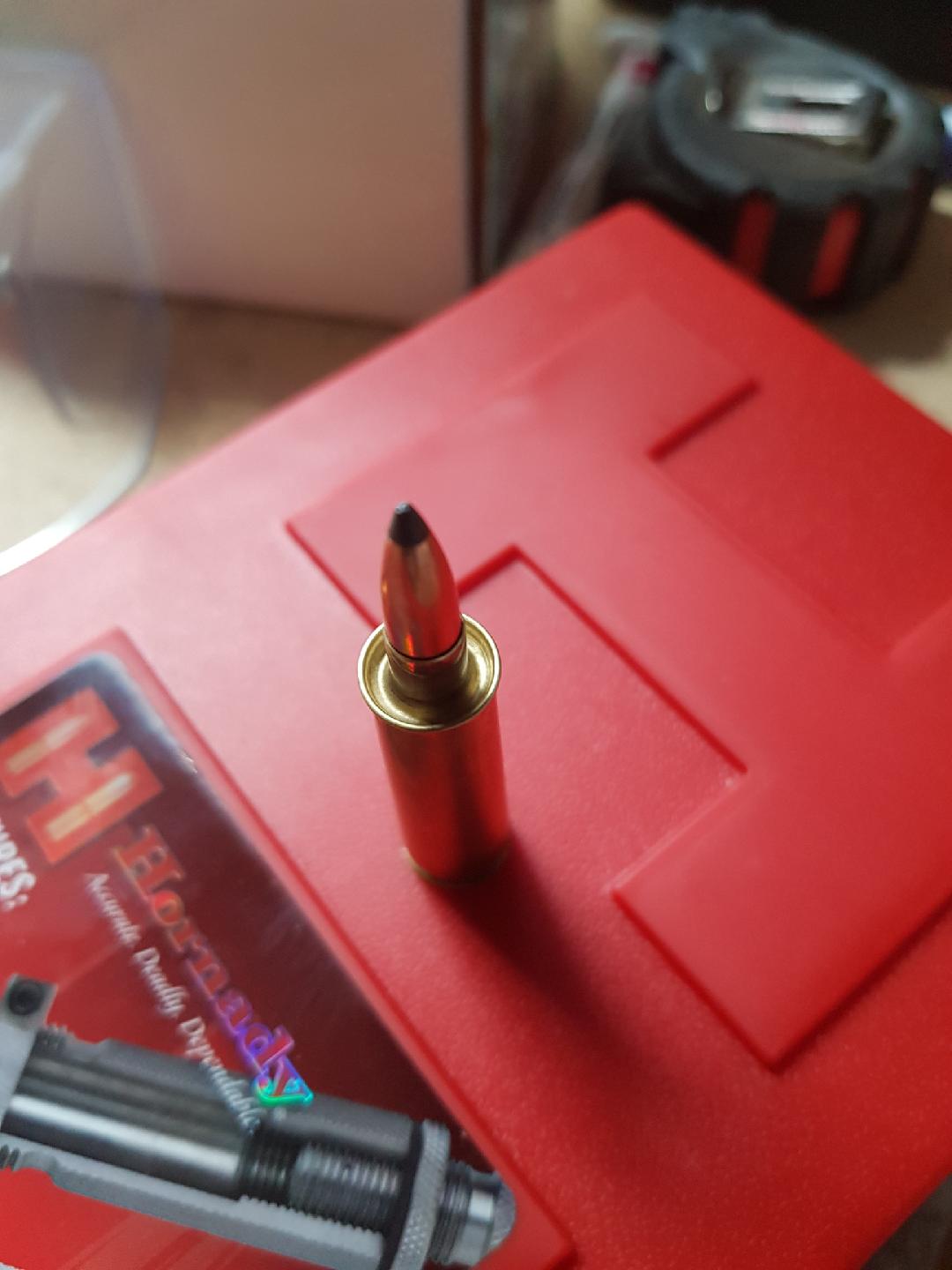

So I measured my chambers COAL tonight and it was 2.134", which is quite crazy considering that i had been loading my rounds .106" (2.7mm) shorter than my COAL.
I'm looking forward to seeing how they go.
I also measured my headspace and I tried to bump it back about .004 but I was having a hard time getting it consistent.
Is it normal to have variances in headspace measurements by +/- .001
Also should I be concerned it the projectile is only seated about .196 - .236 (5-6mm) in the neck?
They didn't feel loose or anything.
I did have one casualty though.
Diddums

That is a cracker of a casualty...ive had the odd dent in the shoulder from too much lube build up, & a split neck from lack of lube, but that ones a wee ripper...id frame it & give it pride of place on the top shelf of the loading bench...!!!
I pushed on the press a little too much and that was the end result.

Yes that is am issue with Hornady seating dies. a lot of seating dies you can adjust so the shell holder touches the die but not one of these. You have the seating die wound down to far it needs to be wound out a few turns. It is also a die that will put a crimp on if in too far which you dont really want either. I assume you re read the instructions and worked it out?
