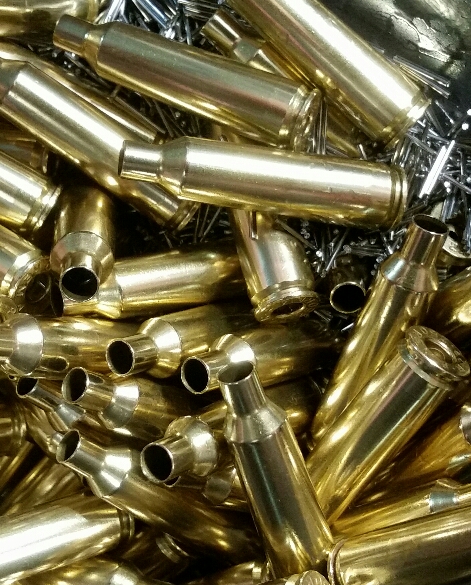

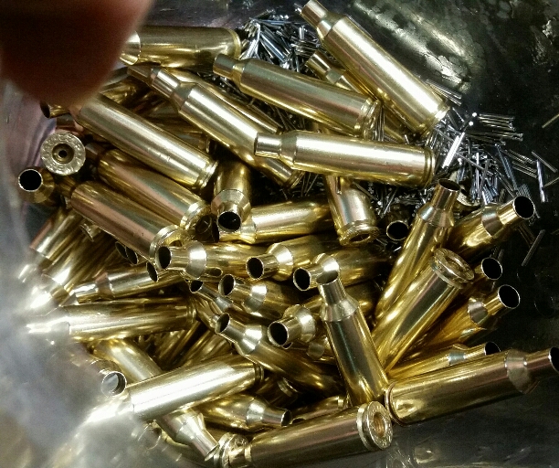

Ok...so...How much is this lemishine & how much you use per mix...?
This is the results i get with less than $5 worth of vinegar & citric acid ($5 worth does lots n lots of tumbles)...the pic is not enhanced in any way either...apart from its the one pic cropped differently...
Tumbled & rinsed...
2019-07-15 18.10.38.jpg (325.72 KiB) Viewed 15786 times

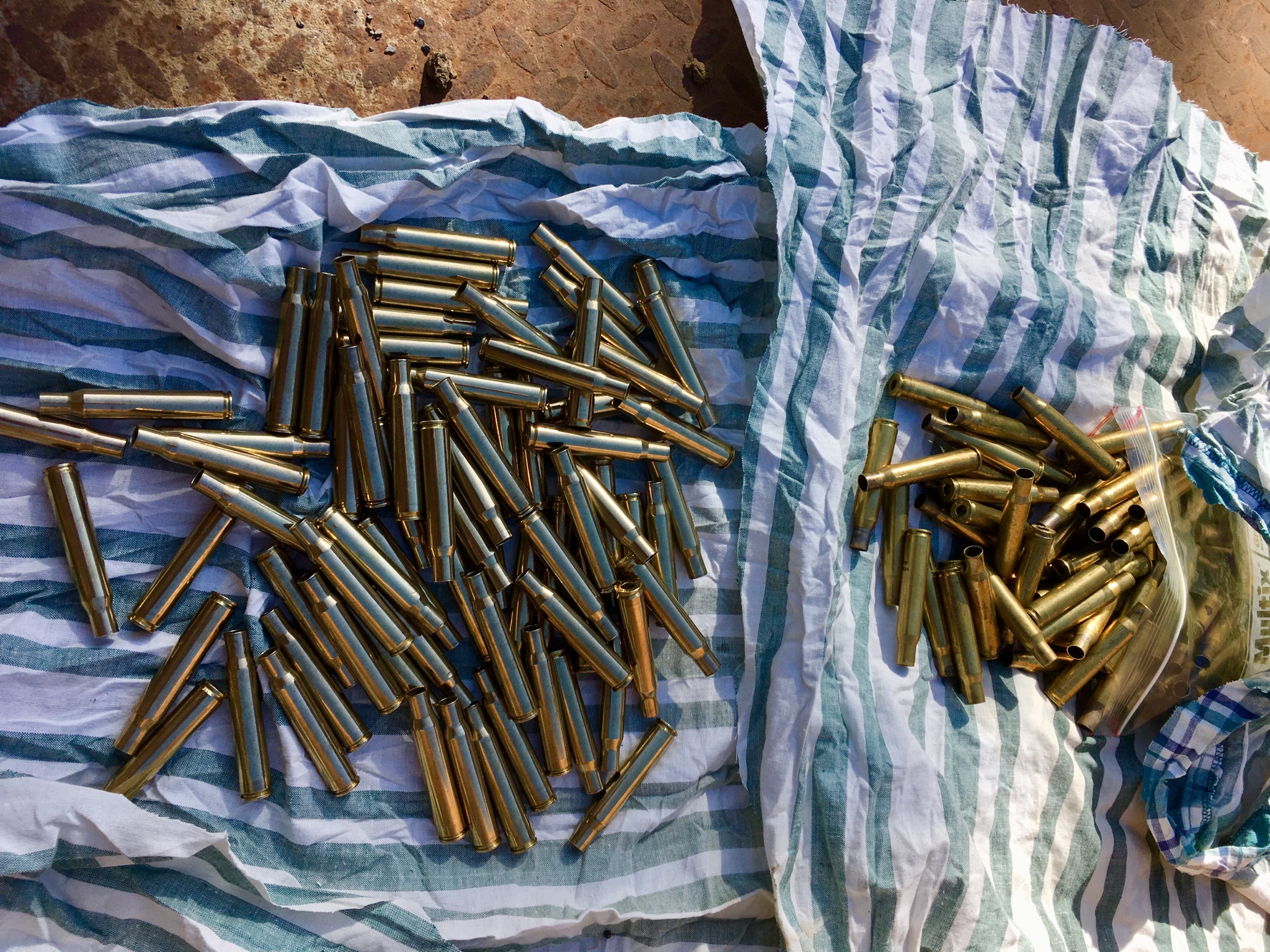

2019-07-15 18.05.03.jpg (295.58 KiB) Viewed 15786 times
