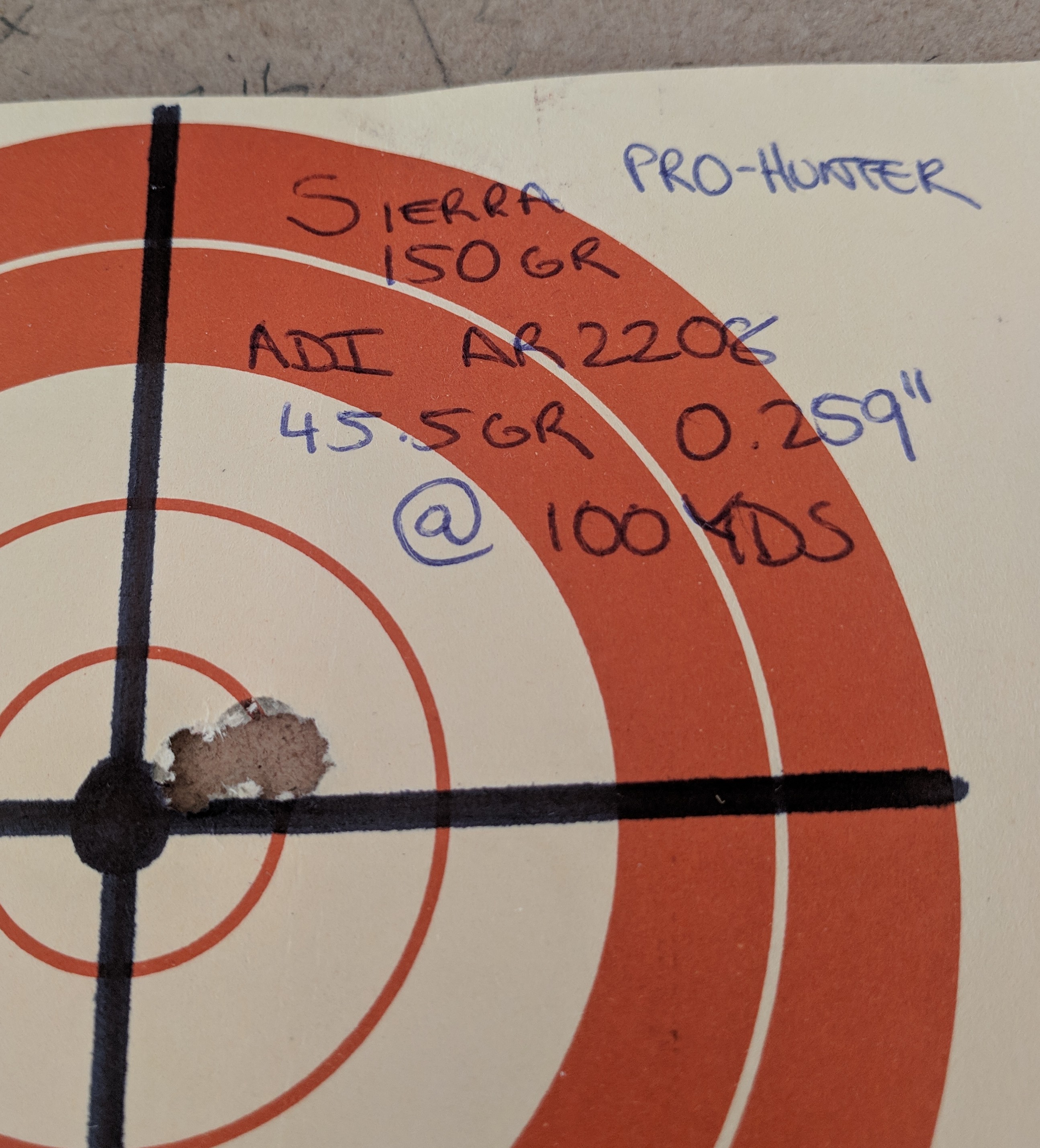

Post by Cal-ApeR » 22 Feb 2019, 7:39 pm
Final update. Went to the range the other day and settled on this load. 150gr prohunters pushed with 45.5gr 2208. This was my best group of the day, I also shot another 5 X 3-shot groups with the same load. All under 1". I also tested out to 200 with about 2" accuracy (3-9 scope at that distance was painful). Anyway I thought I'd end this thread with my results. Thanks to everyone for the advice, it certainly got me over the line. I have learnt a hell of a lot, particularly with OAL and how this rifle really likes then seated heaps further out.
Hopefully this thread helps someone who might be in the same boat one day.

Post by JimTom » 22 Feb 2019, 7:52 pm
Nice one mate. Have to be happy with that load. It's a cracker. :thumbsup:

Post by Oldbloke » 22 Feb 2019, 8:06 pm
I'd be very happy with that.
Reloading is certainly the way to go. Most rifles respond to a bit of experimenting. Even the cheaper ones.
