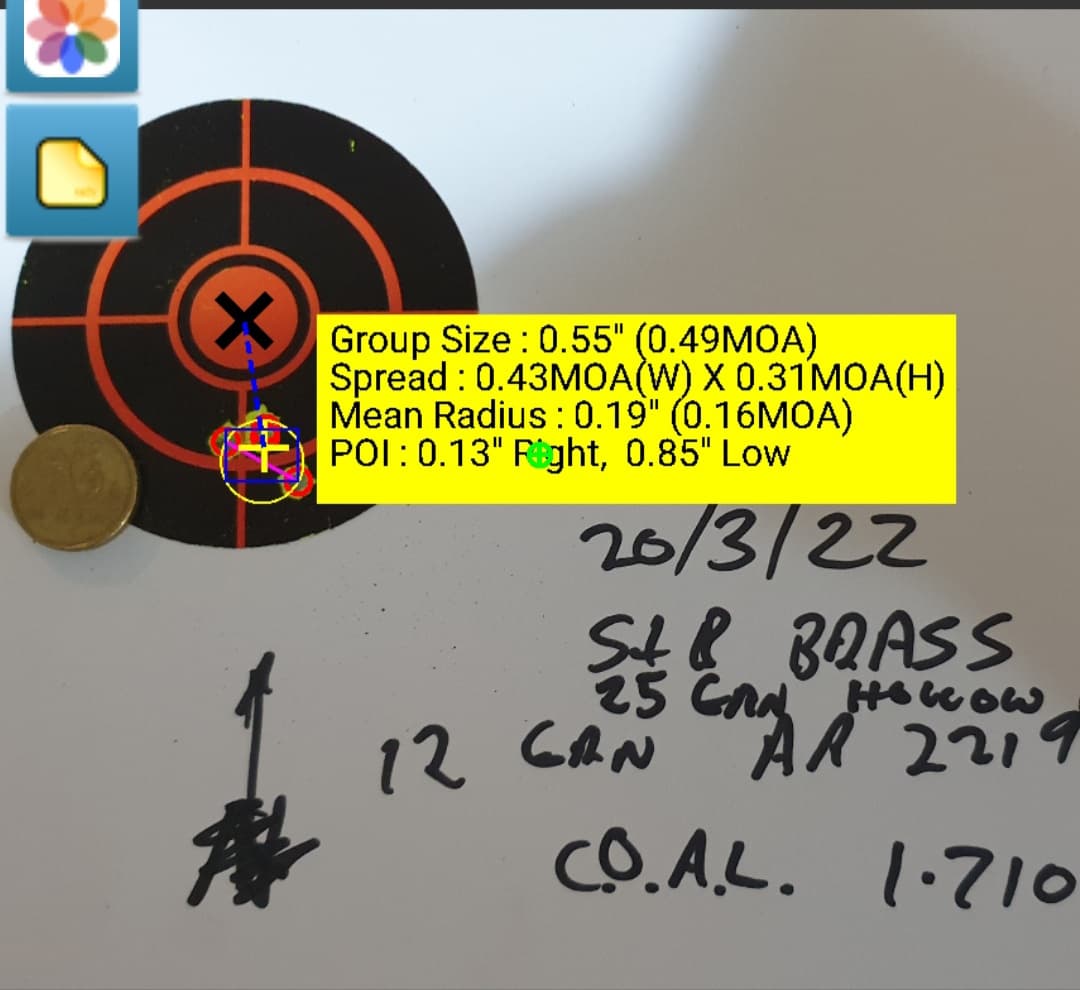

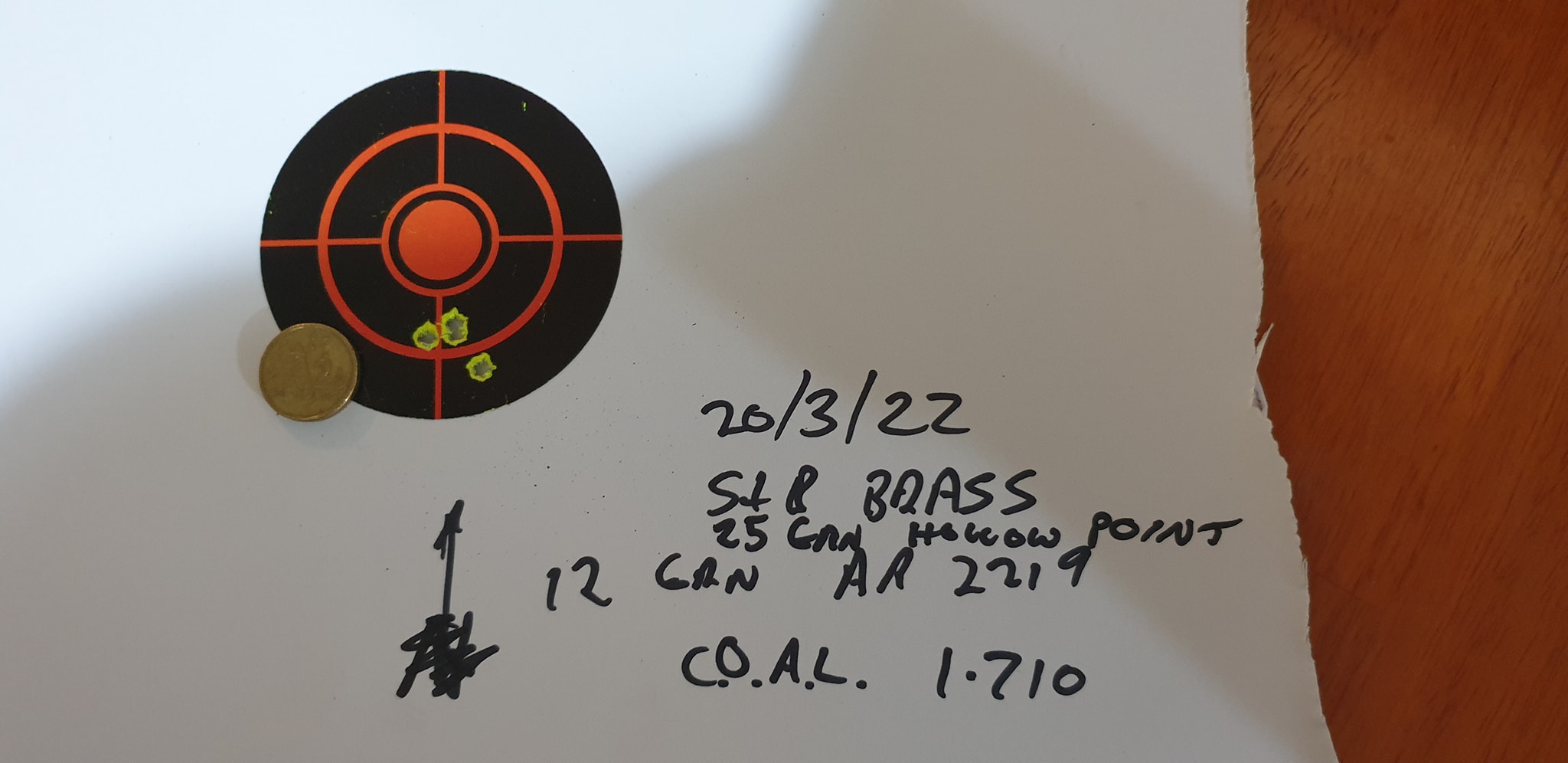

Post by ratpaker » 27 Mar 2022, 6:45 pm
Results with AR2219 and 25 grain hornady hollow points went very well!
ADI only list loads for 25 and not 20 grain...
Still...0.55 of an inch i will take at 100 meters i will take!
ratpaker

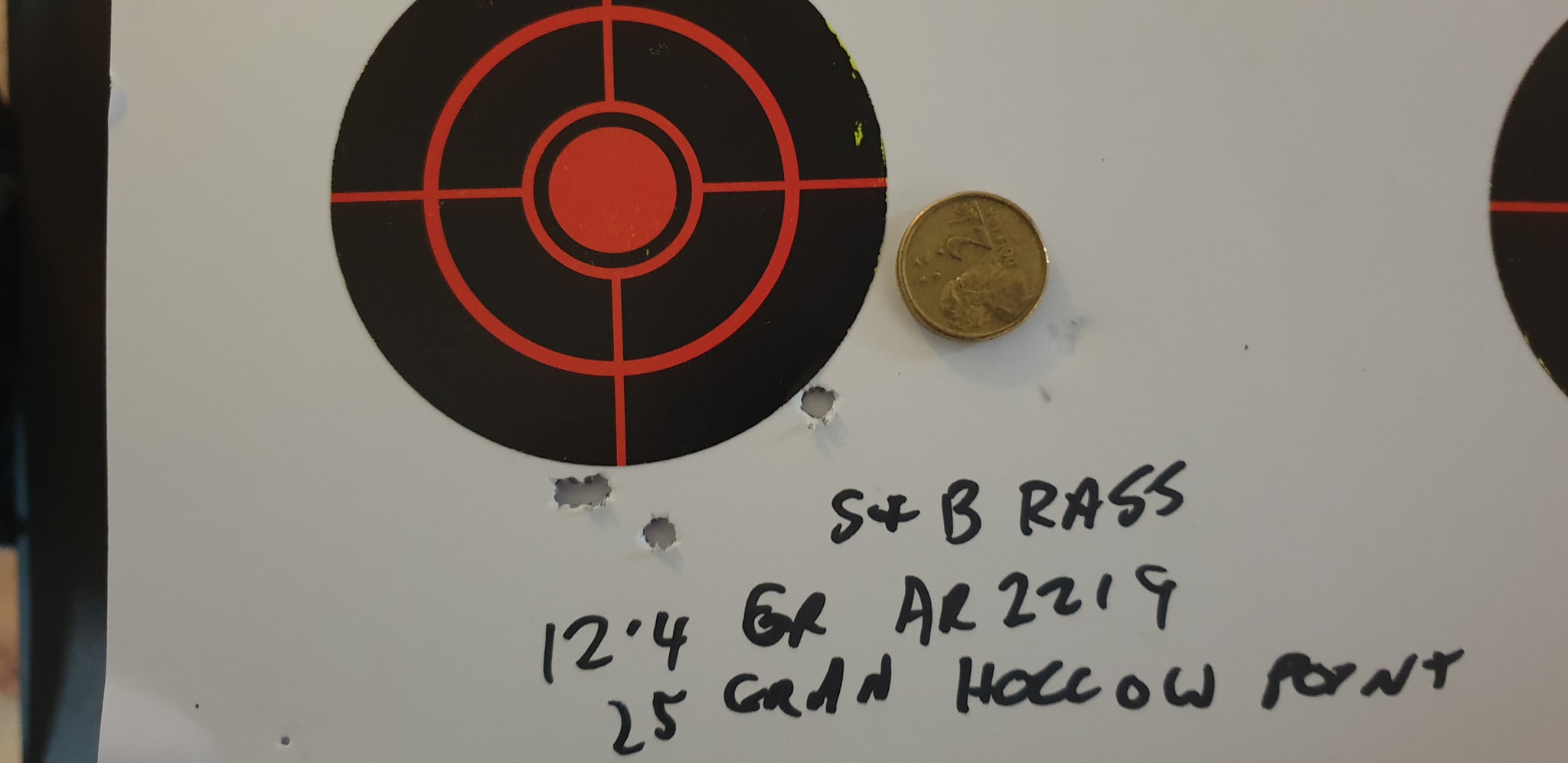

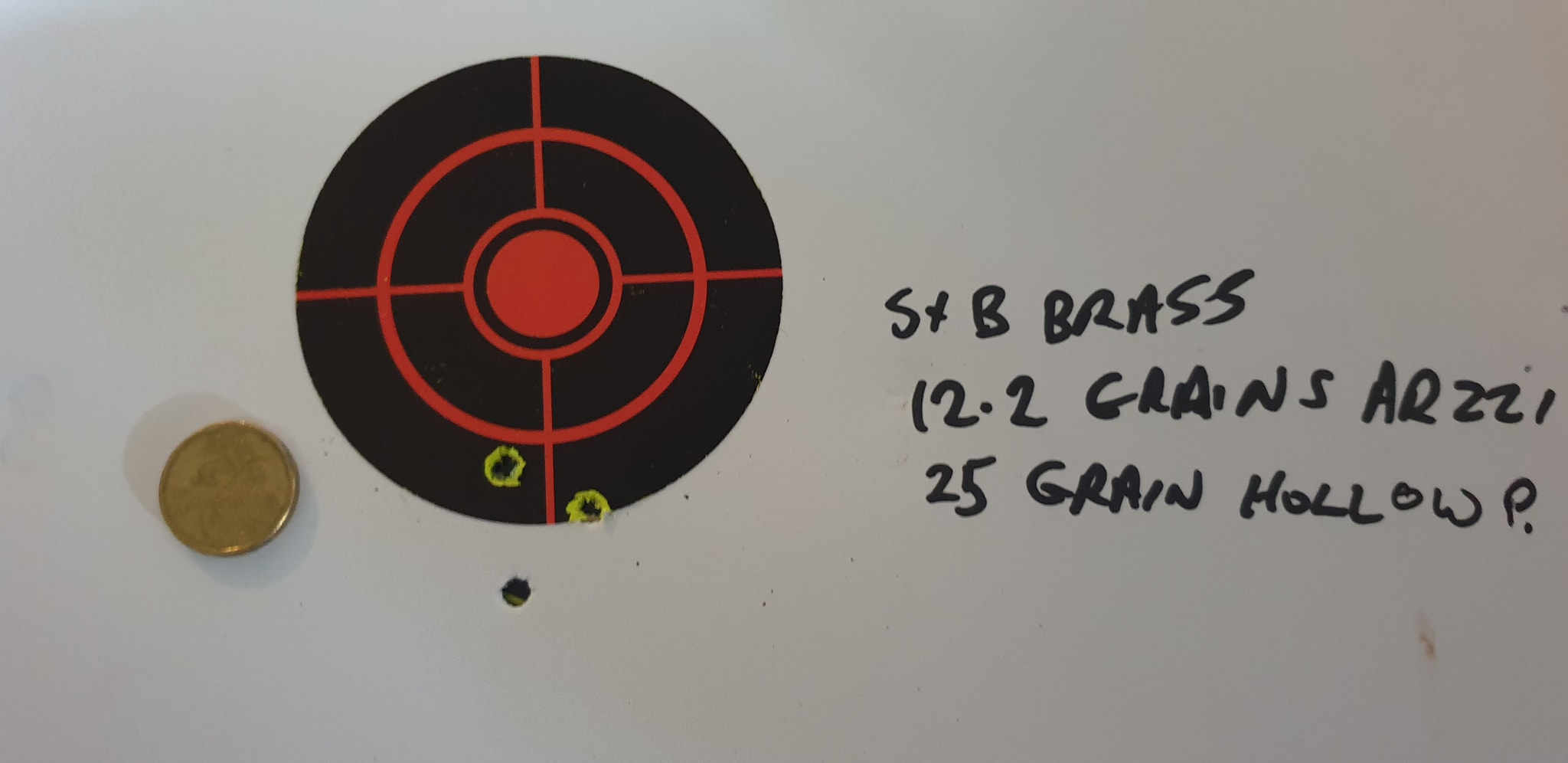

Post by ratpaker » 28 Mar 2022, 3:10 pm
Thanks Bill.
I'm pretty happy with the results.
Its a very low pressure load too according to the ADI data.
I'm shooting the minimum load of 12 grains...maximum is 12.8.
Minimum load is 30600 psi breach pressure from memory.
Odd thing....as I went up the scale from 12, 12.2 and 12.4 grains, the point of impact got lower at 100 meters?
The other weights grouped ok but 12 grains really seemed to be the sweet spot in my rifle.
