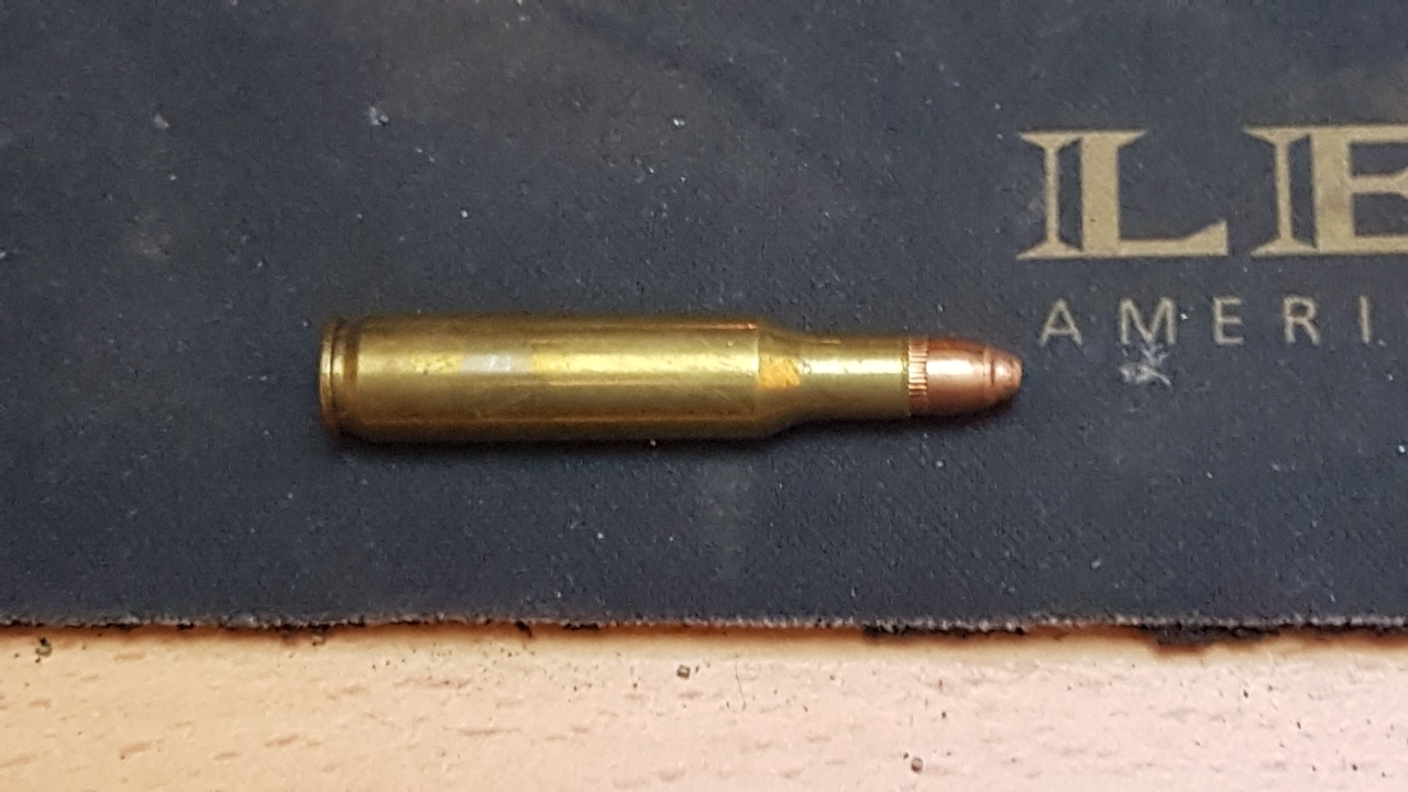

Did some digging around in my ammo storage and found a heap of the old 222 rounds that I loaded with Winchester 22mag prodgys .
