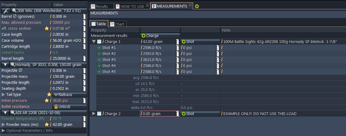

Posting my results from today's testing
No4 Mk2 308W
Lapua Brass, case volume 56g H2O
Hornady 150g Interlock SP # 3031
CCI #200 LRP
42g AR2208
COAL 2.800"
According to the GRT tool, this combination will produce max pressure of 40071 psi with muzzle velocity of 2610 ft/s
I had to resight the rifle which required replacing front sight blade from 0.045 to 0.075 and a couple of small windage adjustments
1 x 5 shot Chrono results
Avg 2596.8 ft/s
SD 14.1 ft/s
ES 35.0 ft/s
Min 2586.0 ft/s
Max 2621.0 ft/s
1 x 5 shot group (different set to what was chrono'd), group size of 1-7/8" shot at 100M using battle sights off bench with front rest/rear bag with light breeze R-L
I am comfortable shooting this load in my No.4 and will stick with it for a bit and get in some practice then stretch it out to 200 to see how it goes. According to GRT im leaving some powder behind however with my eyes if I can keep it consistent at 2MOA or under at 100 using irons then its prob as good as I am going to get and don't see any point in tweaking an further looking for a more optimal load as I dont want to go under 42G and everything to the right of 42 just increases pressure which I am wanting to keep around 40kpsi. I dont usually use loading software however GRT was free and I was curious to see what it came up with. The velocity was bang on which gives me some confidence in it however as I have no way of measuring pressure I have no way of knowing how accurate the tool is in regards to this but if I do a rough backwards calc using the ADI data for a 42g load compared to their recommended min of 44g then I think it is going to be close. Only time will tell I guess
