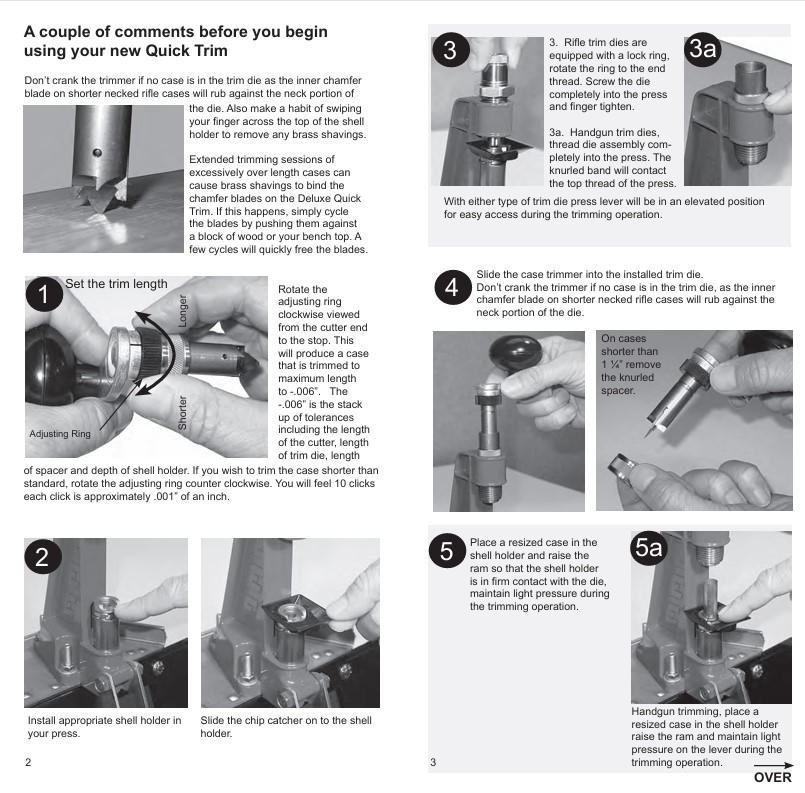

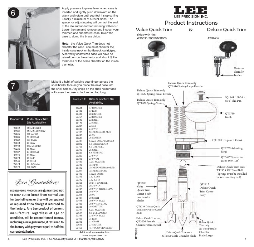

I couldn't find a spec sheet saying what length they trim to, but 2.494" is the SAAMI spec for it. The cutter is adjustable though.
https://leeprecision.com/files/instruct/QT3989.pdf
Wrong one. Not adjustable. But I guess you can grind a bit off the guage/shaft
Wrong one. Not adjustable. But I guess you can grind a bit off the gauge/shaft
Oh, the rod ones, yeah if you want to adjust that it'd be harder, but it's very likely you won't need to go shorter than SAAMI spec.
Re: Reloading press
Post by Oldbloke » 17 Jan 2025, 2:14 pm
Yeh, been thinking of buying them. I think it would be fine. But puzzles me why Lee would contradict every reloading manual around.
