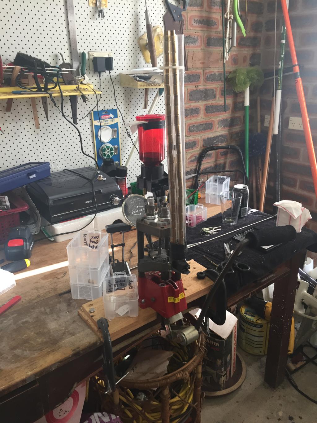

Here is my reloading setup.
Not really porn, unless you like cheap nasty porn :lol:
The Lee Pro 1000 i got for $90 as it was "broken". I stripped it down, gave it a deep clean and it works fine.
I can crank out about 300 rounds an hour.
Can't complain for that price!

I clean each case using vinegar, dishwashing liquid and hot water in a tupperware container and sit it on top of the washing machine while its washing :)
I sort of do both. Every third case usage i deprime on the press and clean out the pockets. then prime on the press, Otherwise i just run the press in full with cleaned cases.
At first i had a heap of problems with the primer feed tray and then primers flipping over but i made the following modifications to the press and pretty much cleaned that up:
* The indexing rod is loose at the top and wobbles around a bit which knocks around the base plate. I tape up the top with electrical tape to tighten the movement but with out impacting the operation of the indexing.
* Primer feeder, i 1000grit sandpapered the shaft which the primers slide along and then graphite grease it every so often and use compressed air to keep it clean.
* I had to readjust the index screw after making the modification to the indexing rod as it became a lot more precise in its movement and was knocking primers off the primer plate.
Other than that if i keep it full of primers and powder it feeds cases, primers and powder all day with out issue. Last run i made 1000 round and had one primer issue not being seated properly, fixed that up quite easily.
Its no Dillon and it is not for the faint of heart, however for $90 i cannot complain and i would pick up another one without hesitation.
My biggest gripe is the powder thrower, the autodisks dont like smaller loads and can be inconsistent in humid conditions and lees chart of which hole does what is not correct for any powder i have tried in it. With trial and error i now know that hole 46 throws for me 3.7gn of AP50
I only use mine with trail boss and there was no data for it and being a large volume powder and me just loading a plinking round I'm not to fussed.
Although it s**ts me that as the brass indexs around to the bullet seating station it flicks some powder out everytime.
But like you say can't beat it for the price.
Yeah ok so thats another gripe.. :) however i have a couple of cans of compressed air. The trick to this press is keeping it clean and free of powder.
Me too, not sure how to stop that happening, it flicks some out as it drops into the detent even if you go slow.
For a 124/125gr projectile I'm using the .43 hole which gives me 3.2gr of AP50. I check the powder charge occasionally and haven't had any charge issues as yet. I live on the Gold Coast, although not 'on' the coast as such, and don't seem to have any real humidity/temperature issues.
Do you use the primer feeder on yours?
Yep. When I bought the press I was aware of the primer feed issues but and tried to pre-empt them with the little button vibrator on the feed tube.
Here is a short clip of my Pro 1000 in action, have a look at the 28sec mark and you'll see the primers feeding with the vibrator turned on, they practically shoot into the press! - https://www.youtube.com/watch?v=puNXFst7_bc
Definitely.

Hollywood, my 43 hole throws 3.2 grain too I think.

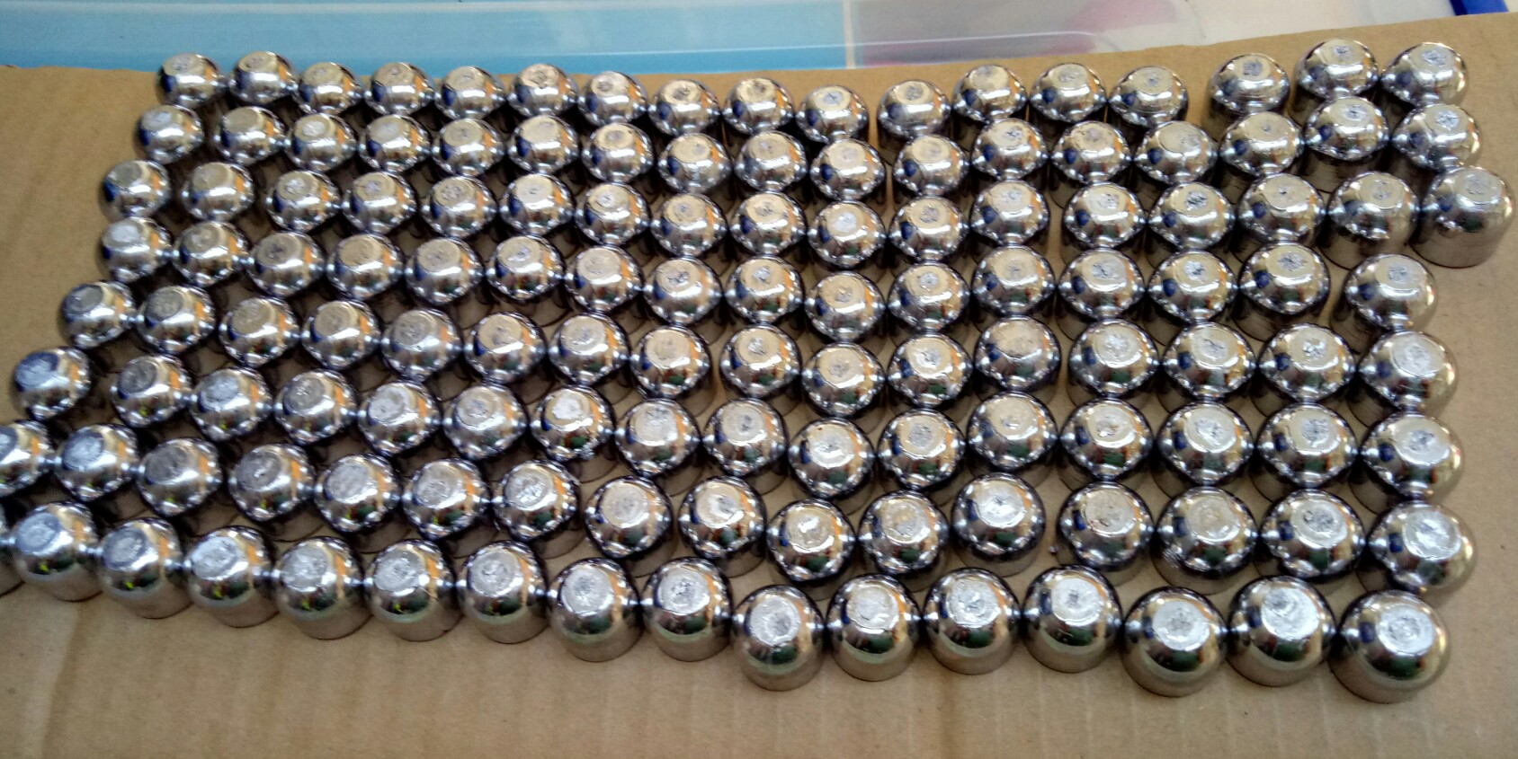

I got busy with a 1oz Lee mould.
Re: Reloading porn
Post by Oldbloke » 19 Mar 2017, 5:55 pm
Trouble is, tight in the sg choke.
Will hone it out a bit.

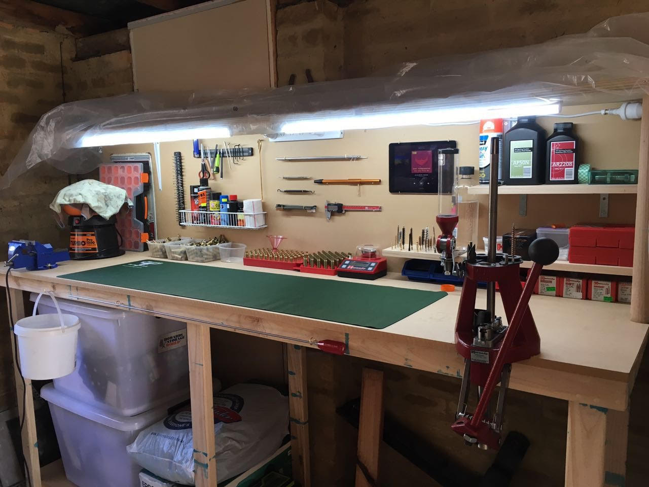

My very own reloading bench.

Nice, looks brand new :)
Posts: 2727
Re: Reloading porn
Post by junjun » 27 Mar 2017, 9:07 pm
very brand new. Set up about 4 weeks ago. Done about 300 rounds so far. Plenty to learn. Very satisfying reloading too. Too bad hard to find enough time to do it.

Neat and tidy bench, well done.

Nice job mate, but wheres all the mess?
It's my OCD to keep things nice and tidy. I have used the bench a few times now, and still very tidy.

Not wanting to be 'that guy', but your powder on the shelf should be locked up. Hate to see you get in strife during an inspection due to an oversight

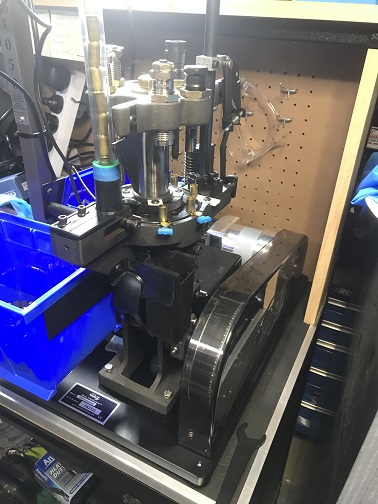

My latest edition...Dillon Super 1050 bolted to a Mark VII 1050 X Autodrive. It's in the garage processing 20kg of 9mm whilst I'm inside typing this watching it via an IP camera. Picking up another 25kg of brass from Wayne at Australian Once Fired on Thursday by which time the Mr Bullet feeder should have arrived ready to start punching out loaded rounds at 2100 per hour :) From the box arriving this morning to the first case hitting the bin was under an hour, piece of piss to setup and get running.

bentaz wrote:Nice looking bit of kit, what do you plan on doing with that many 9mm's? Do you have a market already?
Zombies need more then a double tap to despatch and drop bears need 3 solid hits to stop them :) These are all lead round nose for range use and I've got a few customers that buy in thousands. Its become viable to automate and allow the human bipod to focus on reloading for the big guns :)
