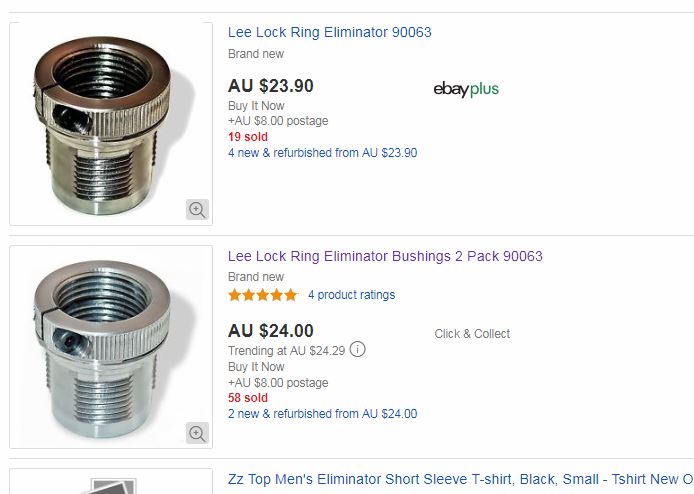

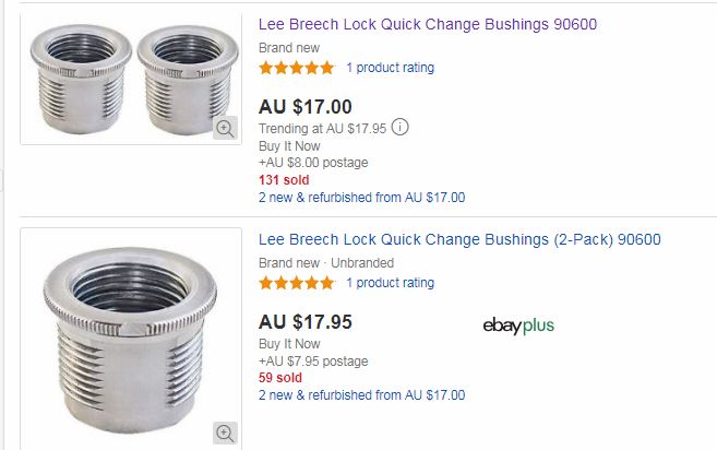

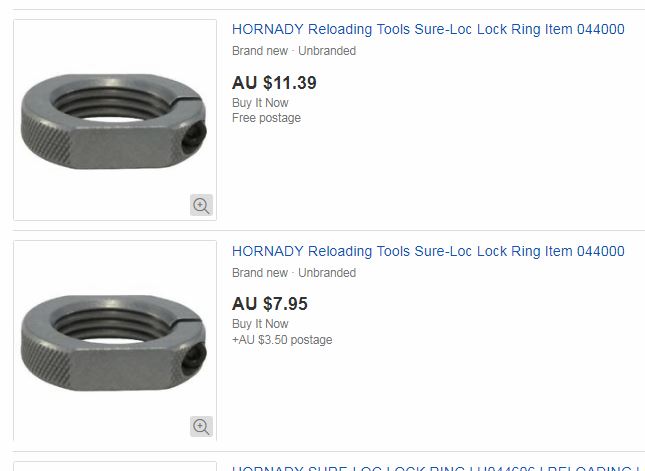

Jon79 wrote:What's the thoughts on the Lee reloading kits? thinking I might actually dip my toe in the reloading waters and it might be a cheaper way to see if its for me or not and could upgrade if i catch the bug.....would be reloading 223, 243 & 308 ammo
The Lee Breachlock kits and Lee dies are brilliant.
I'm loading from .38 Special up to .30-06 and 8x57mm on it. I have four Lee presses, two of the O-Frame, a C-Frame and the Hand Press.
Get the kit with the Hand Primer in it, although you might decide to get the bench-mounted primer later on. The hand primer can cause cramps for me after a few hundred cases. I don't like the press-mounted priming system. If I decide to prime on the press I just put the primer into the ram by hand.
You will need additional Breachlock bushings to save having to unscrew the dies. If you're not planning to load lots of different calibers you might prefer the Lock-Ring Eliminator bushings ($12 each), but the standard bushings ($8.50 each) do work fine, and are cheaper. You can use the Hornady Lock-N-Load lock rings ($11 each) if you prefer, but you still need the bushings so it's a lot more expensive option than the Eliminators.
