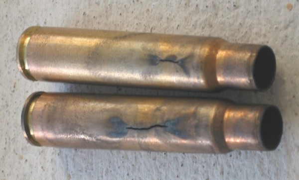

Post by inervate » 21 Apr 2016, 9:26 am
Gwion wrote:The act of sizing would work harden the neck/shoulder and cause splits, etc. Case body would last ages, i would think.
Most commonly yep. You do still get body-only failures though.
Weatherby Varmintmaster .224 Wby Mag
Tikka T3 Hunter Fluted 30-06
Marlin 57M Levermatic .22 Win Mag
inervate
Posts: 73
Re: My first Trail Boss Loads for 223rem
Post by Gwion » 21 Apr 2016, 12:12 pm
OOh! Are those low pressure/velocity Trailboss Loads?
If so, how many firings before that lovely mess???
