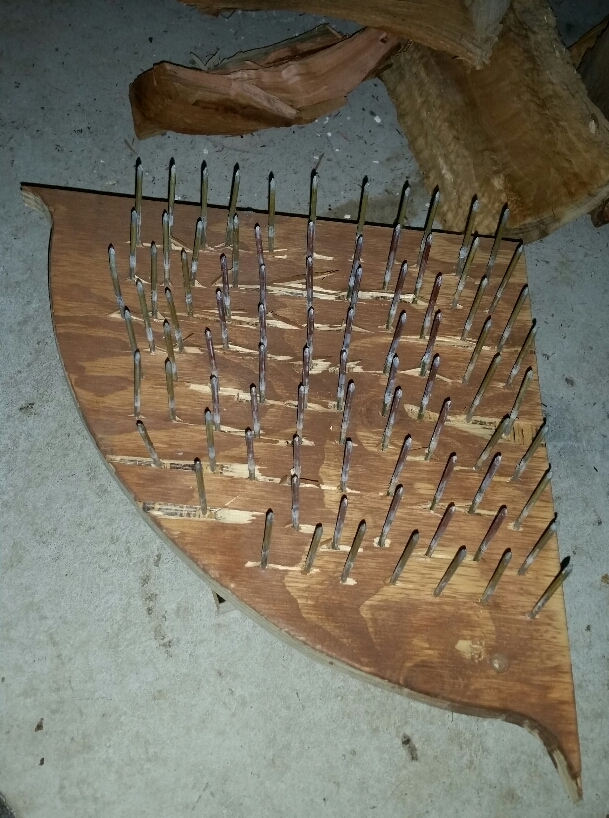

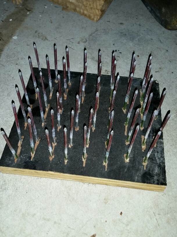

If anyone's interested...i dont dry with a towel...
I use a couple ply boards like this...
Just slammed a few rungs of 1st fix galv nails through bit of ply...this ply is off-cuts of form ply...

Case dryer
2019-08-02 21.26.05.jpg (438.3 KiB) Viewed 3604 times
Here is another bit...
Guess what its from...?
Case dryer
2019-08-02 21.41.09.jpg (425.94 KiB) Viewed 3604 times
Its the corner off-cut from my camo portable shooting bench...
I was too lazy to even cut the corners off before i fired all the nails through... :lol:
(Heres a pic of the bench on page 4 of this thread...)
viewtopic.php?f=14&t=8826&start=54
I make sure the nail isnt sitting in the flash hole when drying & either sit them in front of the combustion heater in winter, or outside during day in summer.
It leaves the slightest mark on inside of neck (some kind of galvanic reaction i guess) but i just brush that out with a nylon brush before priming.
