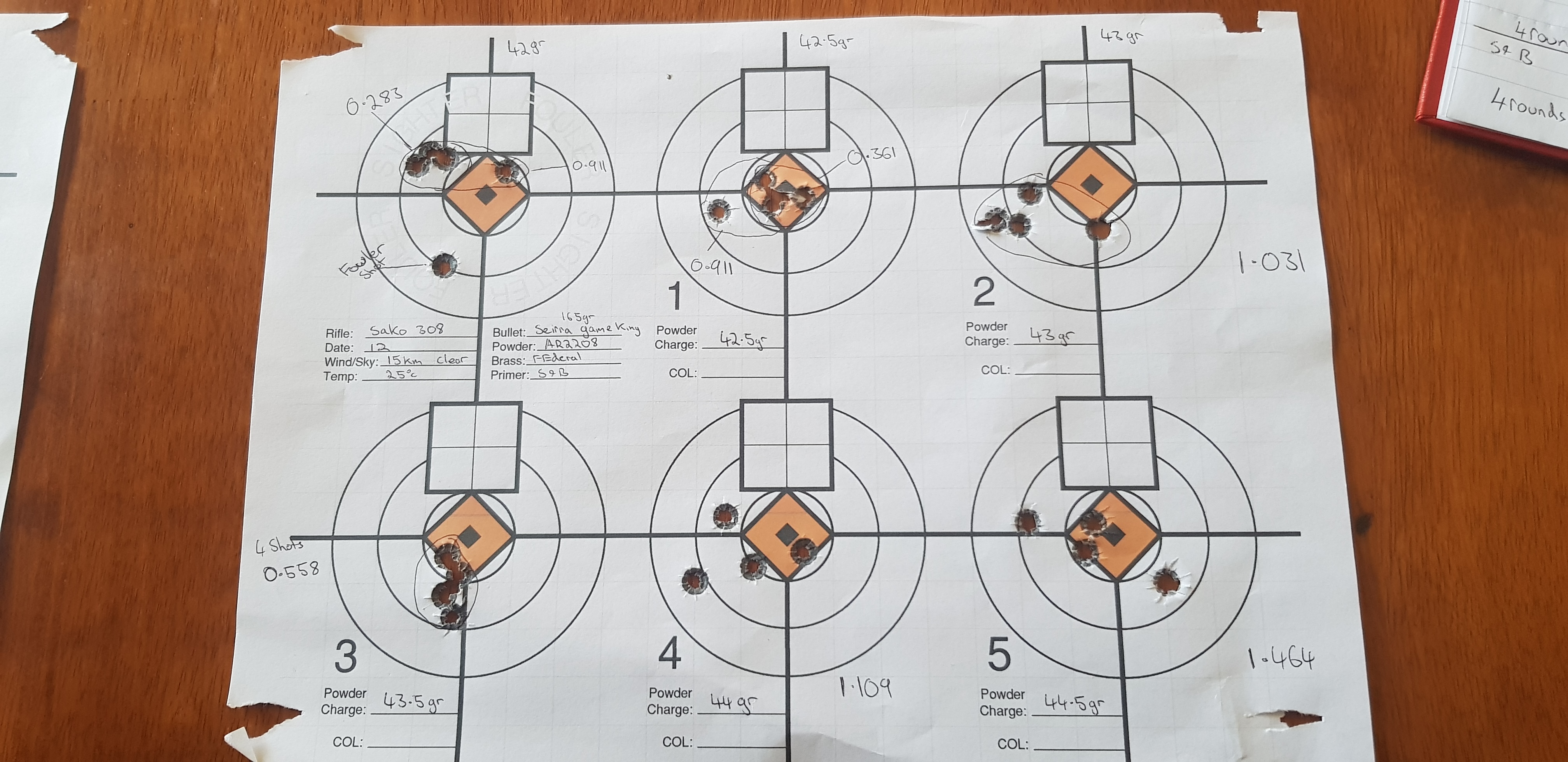

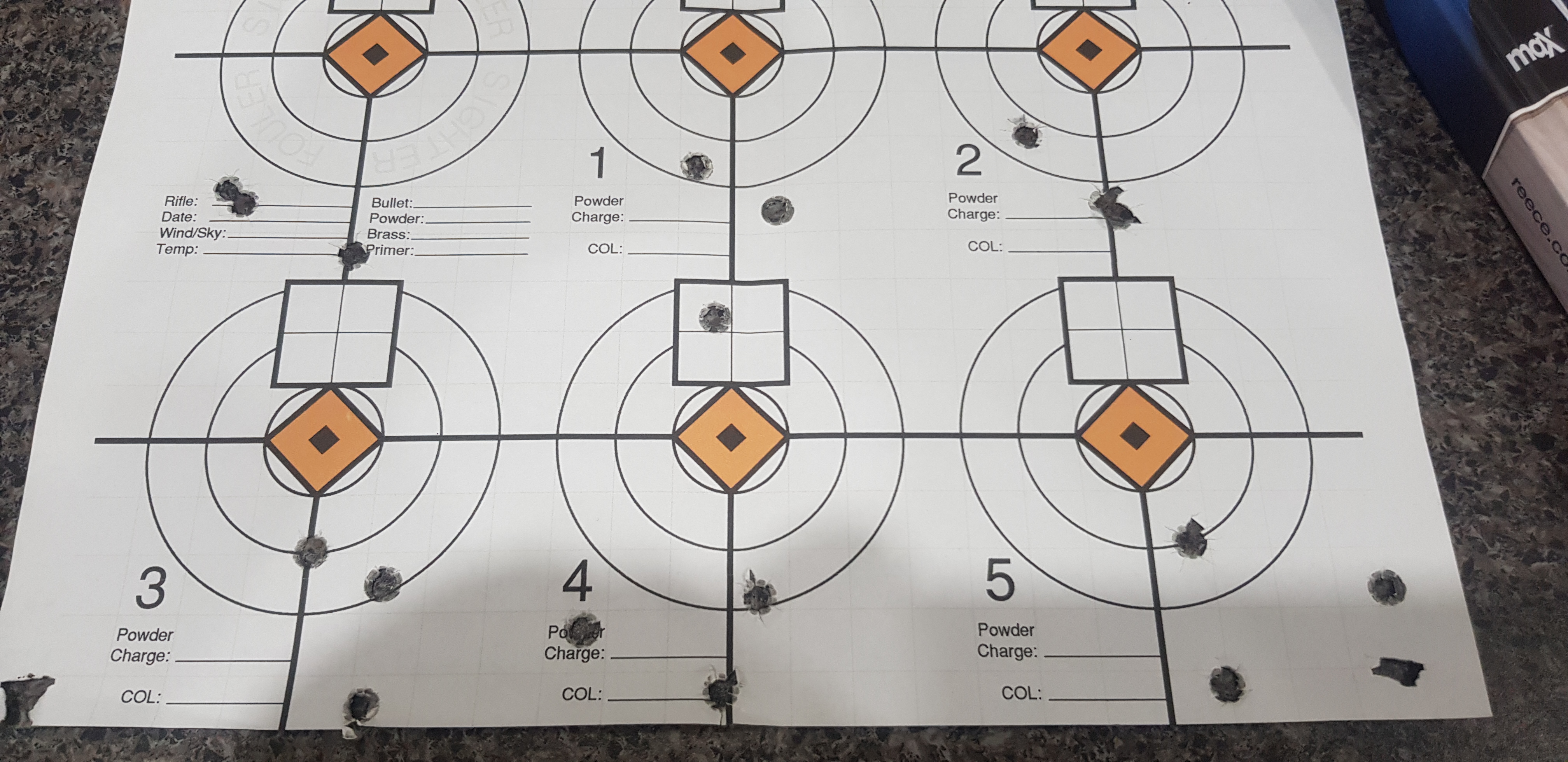

Post by Sako 85 » 06 Apr 2019, 11:50 am
Hi Everyone,
Thank you for all the advice. i have just gone out and shot my second round of re loads from the best group in my first trial increaseing the charge .1grain at a time. all groups shot consistantly smaller then my first but still not where i want to be yet (there was abit of wind on the day).
i am looking for opinions on whether i should keep trying with the Bench mark 2 or leave it for my 223 which i want to start loading for at a later date and try the 2208 that i have recently purchased.
i have attached a photo of my target
loads starting at 39.5gr moving up .1gr at a time all seated 0.030 off the lands
target 1 and 2 are both 39.6gr BM2 1 had a federal primer 2 had rem primer.
Sako 85

Post by JimTom » 06 Apr 2019, 12:00 pm
mate I only do 0.5 gr increases when loading for .308
0.1 might be a little to extreme, and I doubt most scales would be that accurate. Mine are accurate to 0.2 gr.
Re: 308 loading advice
Post by TassieTiger » 06 Apr 2019, 12:13 pm
Opinions are like a* - here is mine;
Dial the scope up, all shots are, consistently low.
The groupings are pretty inconsistent - so as long as fundamentals are 100% right, something has to change.
The inconsistency might be powder related / speed burn but it’s hard to tell.
Personally, I’d try the 08 and as others have said - go .5 because .1 is just to finicky.
Here is what I’d do IF I were in your shoes - and it is only a step forward, it’s not my normal.
Id reload 5 shots at ADI lowest rec weight and then 4 shots each in .5 increments up to max rec plus one 4 shot group over max by only .5
1st reload shot of new batch is ALWAYS from the hip. Then discount the worst of a 4 shot group and then start looking at tightening up powders and look at seating depth...

Post by Sako 85 » 06 Apr 2019, 6:56 pm
Thanks Jim Tom and Tassie, i will try some 2208 working up in .5gr increases. The adi site says that 46gr max load is compressed is it safe to go .5gr over the that? I would keep an eye out for high pressure signs.
Also what would you recommend for a starting seating depth for 165gr sierra game kings? The last lot i shot were 0.030 off the lands.
i am new to this and appreciate any advice from people with experience

Post by SCJ429 » 06 Apr 2019, 7:56 pm
Sierra Game Kings are very forgiving regarding seating depth so 30 thou is a good a place as any to start.
When going over a max load I would do it slow and steady, 0.2 of a grain is better. Just load one of each powder weight to see how far you can go. Use a long drop tube if you have one. If not a bit of tapping the case will settle the powder. If you are getting a crunch when seating the pill it is time to stop.

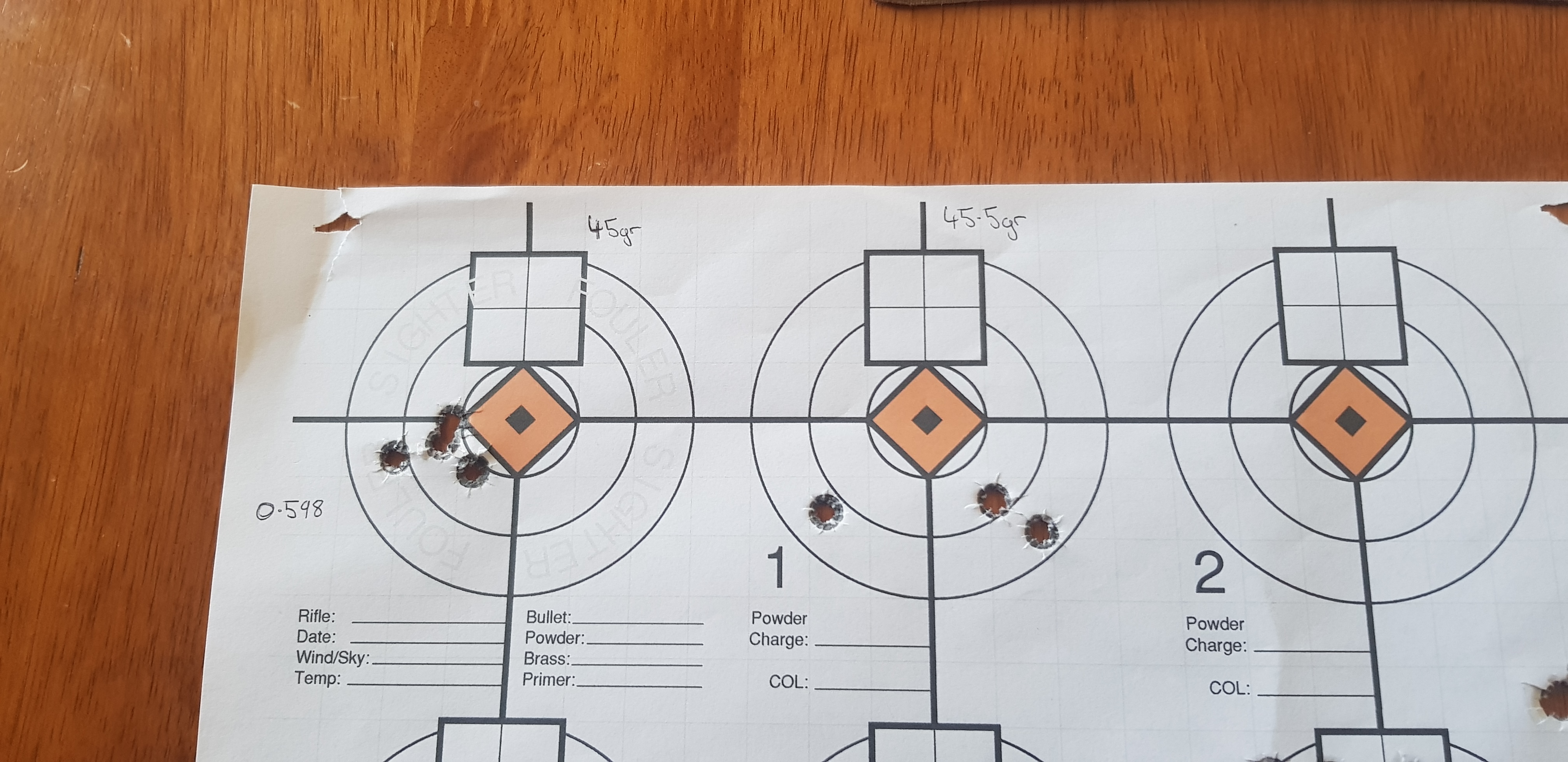

Post by Sako 85 » 12 May 2019, 2:59 pm
Hi everyone,
I just tested my next lot of reloaded ammo for my 308 using AR 2208 have had much better results then the BM 2.
I have attached my targets just wounding which loads i should keep working on maybe with the seating depth. They were all seated 0.030 off the lands starting with 42 gr working up to 45.5 gr.

Post by JimTom » 12 May 2019, 4:09 pm
Mate you have several loads there around or under 0.5”. If it is a hunting load I’d say that is well and truly good enough. You could piss fart around with seating depth, spend another $50 or so doing it and maybe get slightly better accuracy, or you could be happy with what you have. If you have OCD like me then by all means try different seating depths.
Post by Oldbloke » 12 May 2019, 4:14 pm
JimTom wrote:Mate you have several loads there around or under 0.5”. If it is a hunting load I’d say that is well and truly good enough. You could piss fart around with seating depth, spend another $50 or so doing it and maybe get slightly better accuracy, or you could be happy with what you have. If you have OCD like me then by all means try different seating depths.
Agree. Just pick a load and load up a heap. 45.5 looks the goods to me.

Post by Sako 85 » 12 May 2019, 4:30 pm
Cheer thats what i was thinking because it is just a hunting load, do have abit of OCD to. I was thinking it might not be worth the time as the ones slightly off to the sides of the groups could have been shooter error or wind
Sako 85
Posts: 13
Post by JimTom » 12 May 2019, 4:38 pm
Yes mate, I reckon you have it nailed.

Post by Oldbloke » 12 May 2019, 4:43 pm
JimTom wrote:Yes mate, I reckon you have it nailed.
If your worried just shoot the two tightest groups again to confirm.
Post by SCJ429 » 12 May 2019, 5:15 pm
I am wondering about the 43.5 load that you measured at 0.558 but it looks more like an inch. Are your measurements correct?
