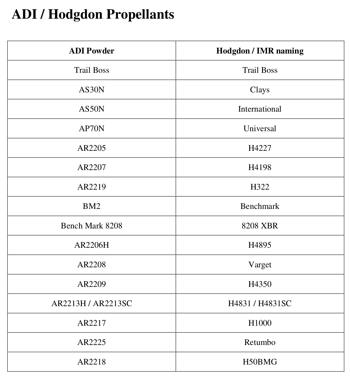

Re: Heavy 45/70 Loads
Post by Oldbloke » 22 Dec 2017, 1:19 pm
These are the equivelents
Post by sungazer » 22 Dec 2017, 2:03 pm
According to the ADI website the fact that they have the same part numbers would also make sense.

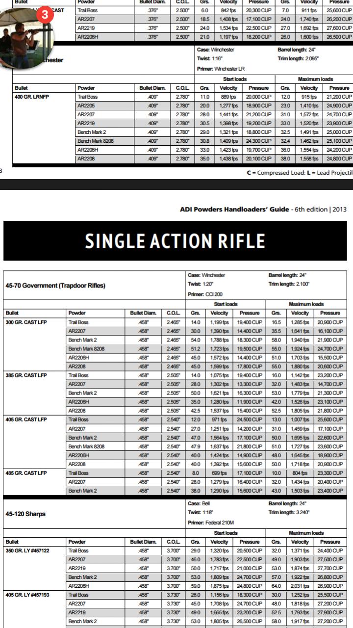

So are you shooting it out of a lever action or a single shot ? I seem to remember it was a single shot ? If so,you can seat the bullets out a bit further to squeeze in some extra powder
Posts: 4182
Post by bigpete » 27 Dec 2017, 9:26 pm
Posts: 4182
Post by juststarting » 27 Dec 2017, 9:29 pm
bigpete, single shot break action. H&R handy rifle.
Thanks for the data. Appreciated. Will start building test loads.
