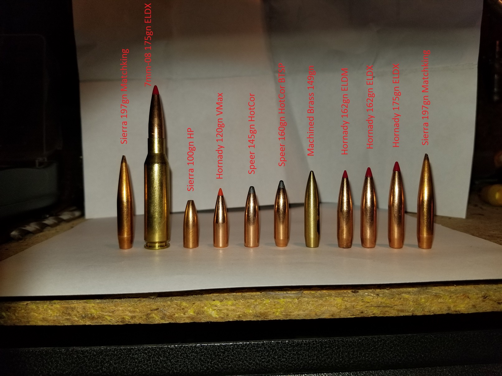

I bought some of these to try out (actually, I just bought them because they look so cool - six-calibers long).
Anybody already tried them?
I really don't expect them to stabilise in my 9.5"-twist 7mm-08.

How will you get them down & out the barrel with no room for powder...?

Plenty of room for powder :-)
They seat only .100" longer than the 175gn ELDX.
The ELDX sits on 37.4gn of AR2206H but I'm only looking at 35.5gn under the SMK to start with - that's only 5.5gn more than I run in the .204.

I don't plan to use them for anything more than ornaments, but I'm going to shoot some just to see if they might stabilise. If they miraculously do stabilise, then I might get some more and see what sort of accuracy I can get out of them.
I've already noticed minimal variance in bullet length, but far less than I'd expected with a bullet of this design. More than 50% fall right on 1.7230", with two longer than that, the longest is 1.7245", and the shortest is 1.7135". But all of them are .9170" to the ogive in the Hornady .30-cal comparator. I was thinking it might be worth filing the points down so they're all the same length, but weight variance is excellent, from 196.94gn up to 197.04gn, with about 40% right on 197.00gn. I think they're extremely consistent. If they don't stabilise, it might be worth experimenting by shortening the point by .010" at a time to see how short they need to be to stabilise in my barrel.

bladeracer wrote: If they don't stabilise, it might be worth experimenting by shortening the point by .010" at a time to see how short they need to be to stabilise in my barrel.
Gees man...you've got too much time on your hands....
If i had enough time to be doing that id buy a lathe & learn some tool making skills...

I can't see how shortening the point would affect stabilization as it is a function of riding surface as much as mass. Overall projectile length has no bearing on the matter. Looking forward to seeing your results with 2213SC if you go down that path as I intend to buy a 7mm Rem Mag this year and want to load some heavier than factory projectiles. All my other 7mm are military and I stick to milspec 173g 2300fps for them, Cheers.

The length of a projectile plays a part in stability. A projectile with a boat tail design may not achieve stability where a flat base of the same weight may shoot perfectly well. Lead free bullets are long for their weight and often do not stabilise in slow twist barrels.

I already make my own brass bullets on the lathe :-)
Bullet length is what determines stability, not weight or bearing surface.
