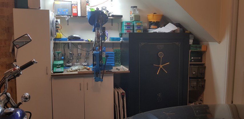

I think most people that live in a city these day are space poor I have my safe under the stairs with my reloading bench beside it i bought a tall cupboard and short from Bunnings fitted a heavy bench top also from Bunnings cut tee slots in the bench so i can mount presses in different positions normally i have an RCBS next to the Dillon with a puller set up in it

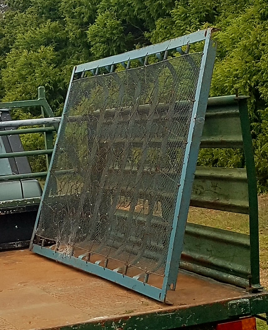

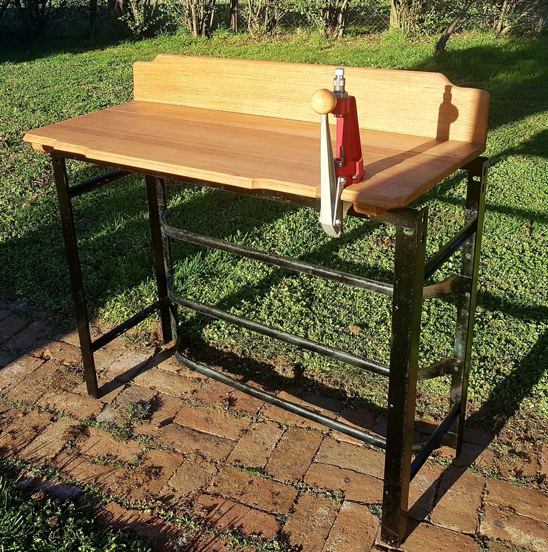

I made my little bench from an old single bed, the spring base for the frame and the wooden head and foot for the top.
Webp.net-resizeimage (5).jpg (702.1 KiB) Viewed 10799 times

Nice job mate

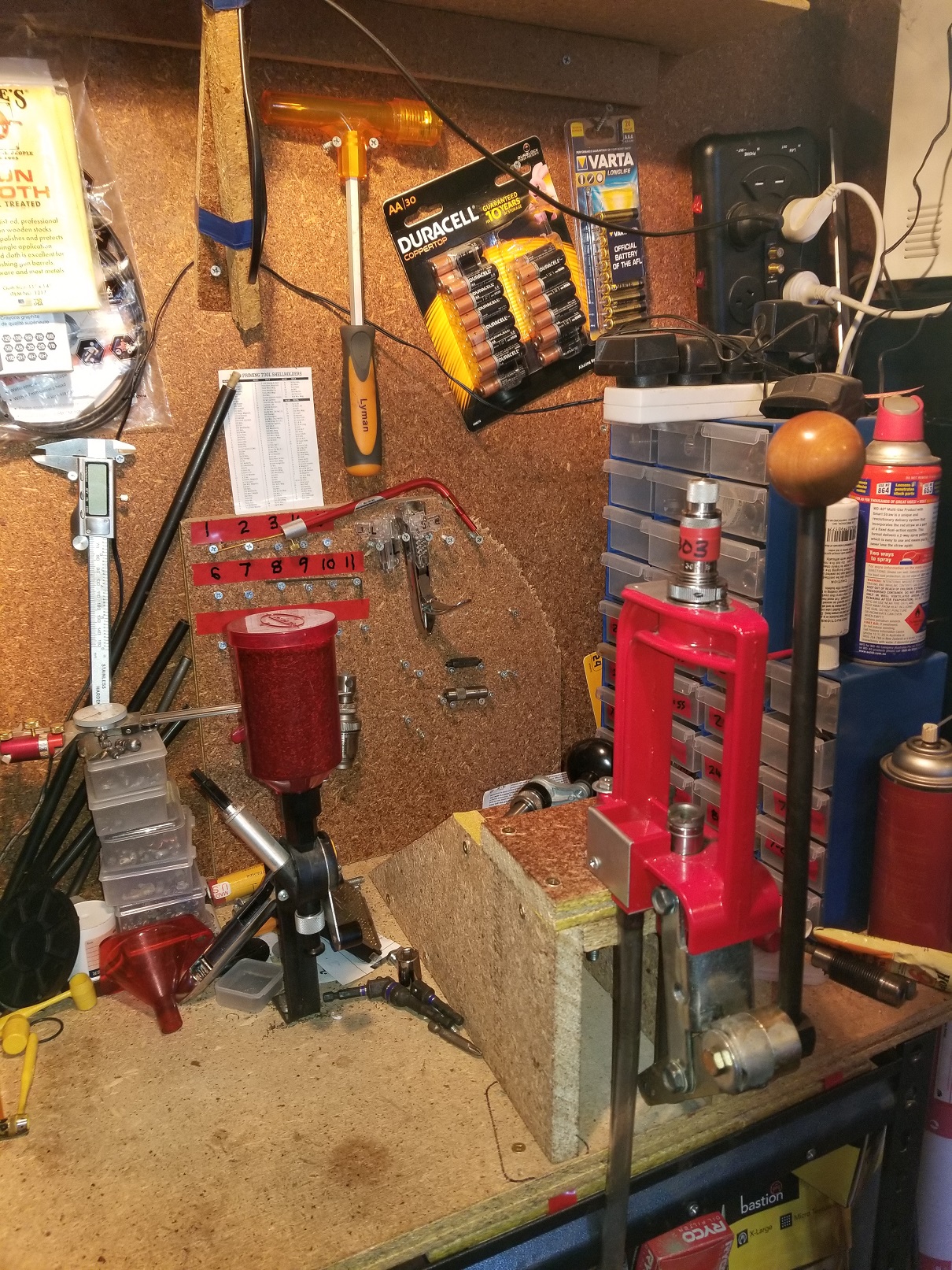

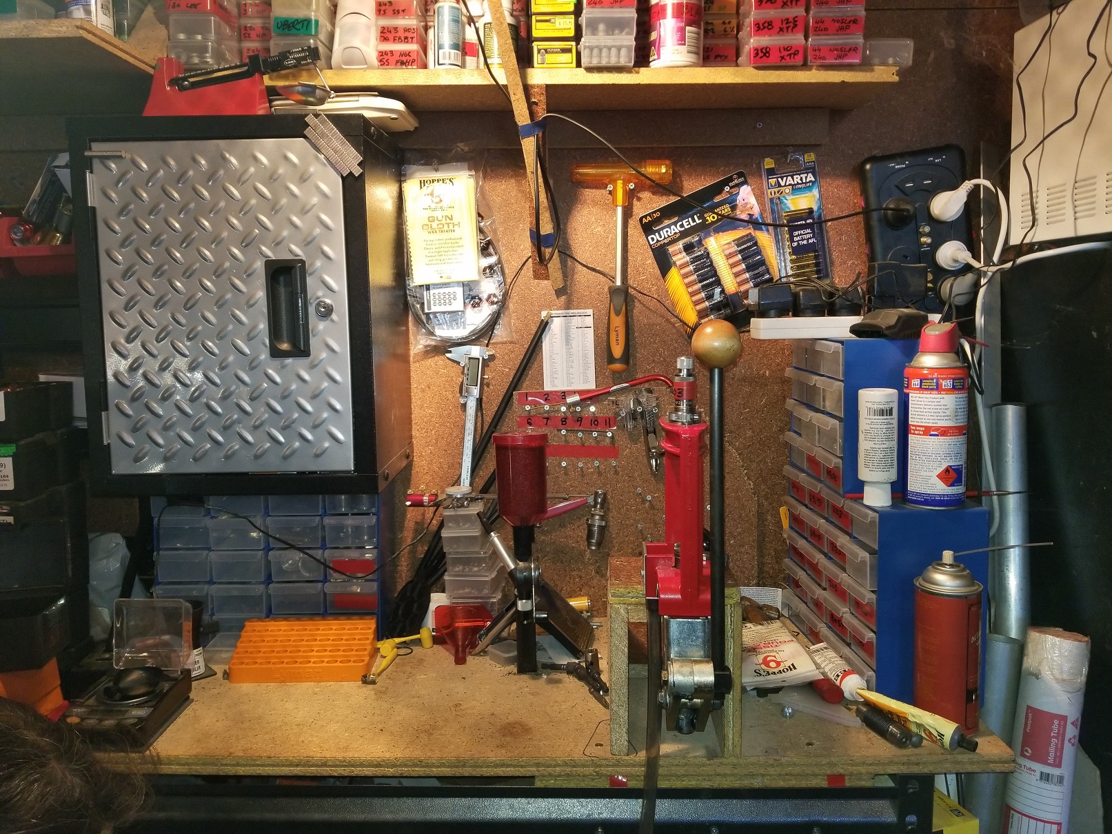

This is my setup currently.
A pair of cheap Bunnings storage shelf units, a piece of 19mm Yellow-Tongue flooring for a bench top. The press is mounted to a riser which is screwed to the bench with a single screw at the rear. The bench top is held down by the piece of Yellow-Tongue screwed to the wall, with some items hung off it but I prefer to keep those items in plastic boxes on the shelf above my head, where most of my bullets also reside. Three units of drawers for my dies, and a lockable cabinet for primers and whichever powders I'm using currently.
I have a spotlight overhead which is annoying. I've bought four-meters of flexible LED strip lighting but I need to cut it into lengths, mount it in various places around the bench, and wire all the pieces together. Just a matter of finding time. The past few weeks I've made about 3000rds on it in .204, .223, .243, 6.5x52mm, 6.5x55mm, 7mm-08, .303, .30-06, 7.62x54R, 8x57mm and some .44 Magnum. Some of them I need to shoot some development loads so I can make up the rest of the batches.

Just a friendly tip. I would be keeping power leads, lights etc away from the bench. Could be an ignition source.
One flash and you're ash. A technical term.
Re: Reloading bench
Post by bladeracer » 03 Jul 2018, 9:54 pm
Oldbloke wrote:Just a friendly tip. I would be keeping power leads, lights etc away from the bench. Could be an ignition source.
Worth remembering for sure, but I don't have any power leads on the bench, just the 12VDC lead to the scale, which is virtually impossible to not have in the area you are weighing powder on the scale.
I'm curious though (I can't smell), do powders give off any kind of vapour with a flashpoint? I would think any spark big enough to risk igniting solid powder is likely to do me more harm than a powder ignition might?
Some years ago I had a poorly-thought-out idea and connected a lead directly to a washing machine motor...and plugged it into the mains. The flash-bang that blew the circuit and melted that side of the power point was probably as big as it's ever likely to get, but I'd be surprised if it could ignite smokeless powder a foot or more away from it. I might have to pour out some powder next time I'm welding and see just what the likelyhood is.
Now I'm also curious what temperature the powder burns at :-)
