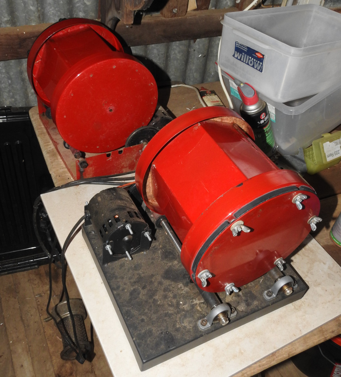

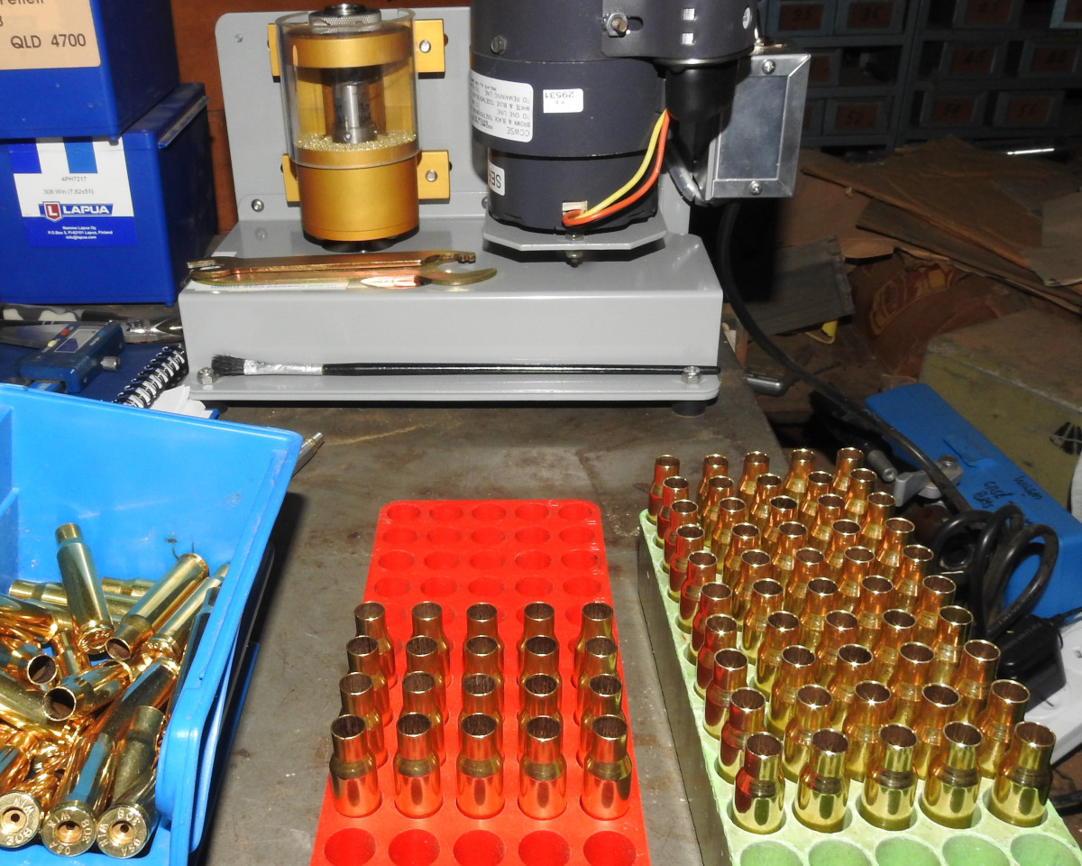

Tumbled brass being processed (Straight out of the tumbler on left, trimmed in middle, and chamfered/de-burred on right on right)
DSCN2158 (2).JPG (439.69 KiB) Viewed 13918 times
My 2 tumblers paying their way...
DSCN2181 (2).JPG (397.49 KiB) Viewed 13918 times
