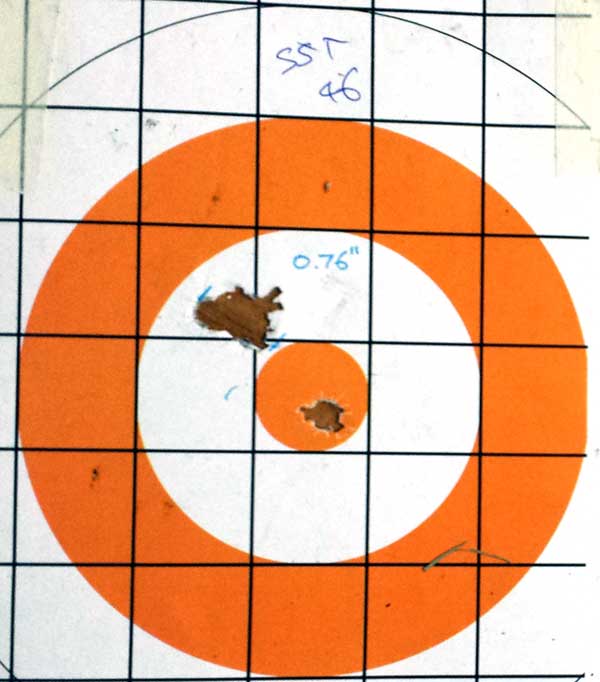

Ah!
I found the picture on my phone with the right charge for the SST's.
I'll post it tonight, but FYI I shot a 0.76" group with 150gr SST's with 46gr 2208.
Haven't tried 45.9 or 46.1 grain powder charges yet either so may still get some more accuracy yet.
The above is on a stock Ruger Hawkeye.
Also, just FYI shooting 0.6" - 0.7" groups with my .243 with 87gr pills and 2209 powder. So another good results with ADI powder there.
Stock Ruger Hawkeye again for the .243.

Post by Lorgar » 11 Jan 2014, 3:59 pm
Here is that group with Hornady SST's that I mentioned Cruze.
Hornady 150gr SST group
That 0.76" is a 5 shot group. 1 flyer on the bottom left there...
Not on the bullseye because I was testing a bunch of loads and not bothered. The grouping is very good though as you can see.
This was with AR2208 again, 46gr of powder.
