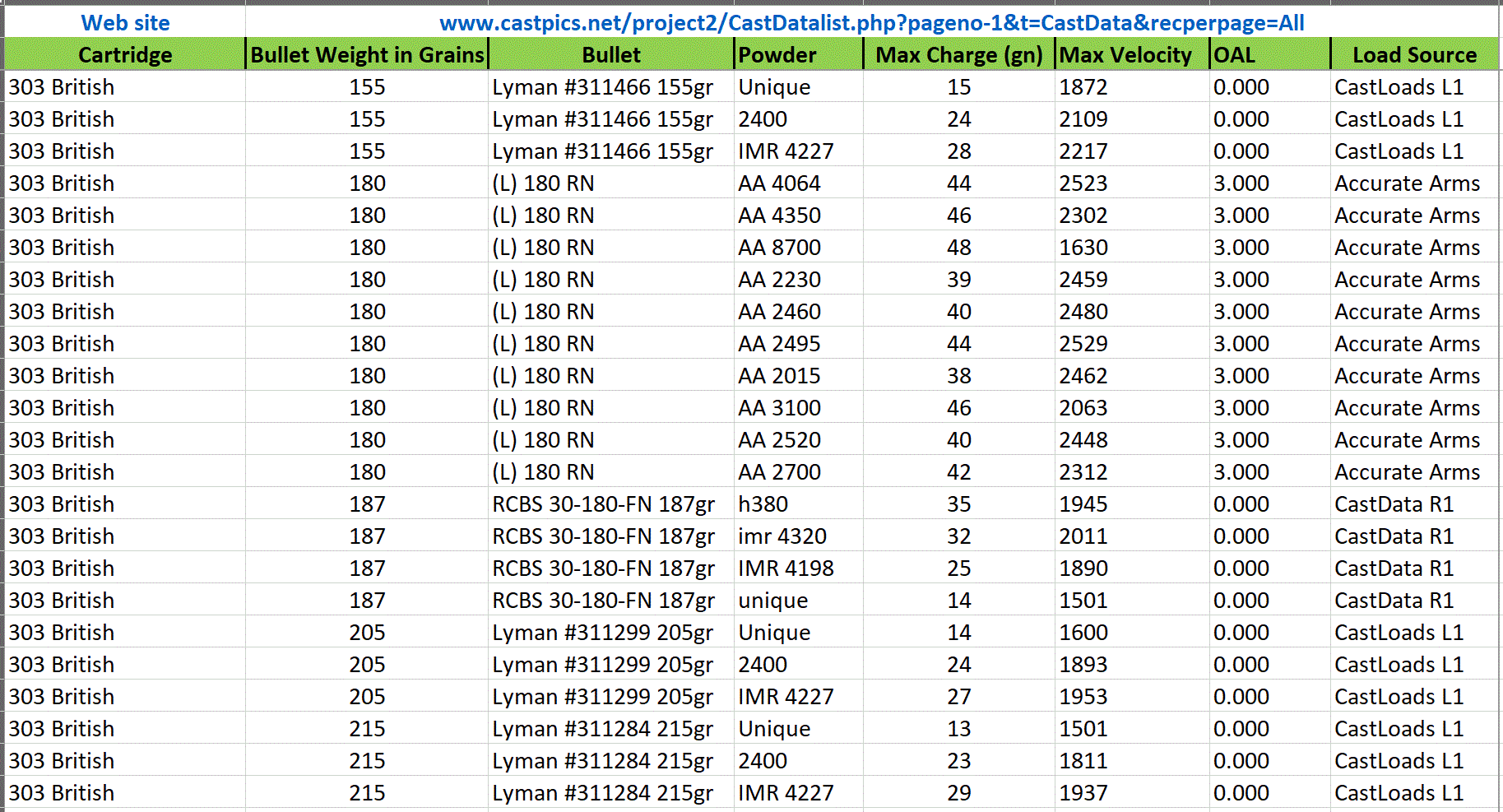

Re: Loading cast bullets in .303
Post by No1_49er » 28 Aug 2018, 10:51 pm
cast 303 load data
Cast bullets_303Br.GIF (150.21 KiB) Viewed 11577 times
This might help. Not ADI, but may give you a clue.
