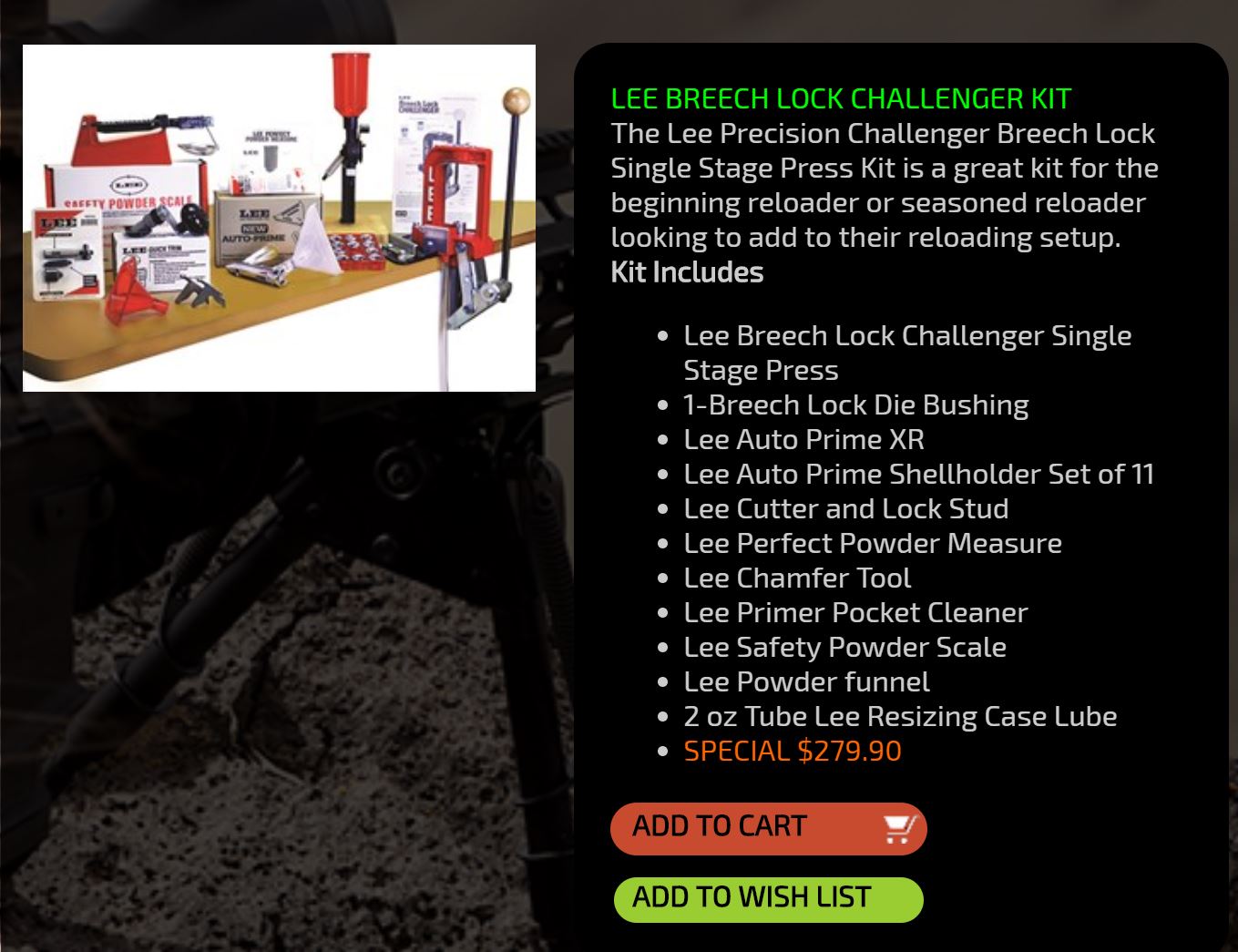

Post by 2freeq » 02 Sep 2018, 4:54 pm
Hi all,
As the title indicates i'm weighing up wether to learn how to reload. I would be starting with .223.
If i was to buy this LEE reloading package,
https://www.horsleyparkgunshop.com.au/p ... -press-kit
What else do i need equipment wise?, The ad doesnt state exactly whats in the package.
Do i need a tumbler?
Reamers and deburrs?
Better still is there a "shopping check list" i can copy as a basic start up pack?
Howa 1500 .223
Marlin XT22SR .22LR
Lithgow .22LR
EMEI Chinese side lever .117 Air Rifle

Post by No1Mk3 » 02 Sep 2018, 5:11 pm
G'day 2freeq,
The Lee kit has everything you need for basic reloading, including a deburring tool. You don't need reamers of any sort for basic reloading, nor do you need a tumbler unless you are doing a large number of cases (100+). 2 packets of brass can be cleaned quickly and easily by hand watching telly of an evening. I started reloading with a Lyman 310 tool, no chamfer tool or scales or anything else and made good hunting ammo in 303, 8mm and 30/30 for several years until I bought my first press. the Lee kit will get you away much better than that and you can "grow" later on. You will need dies though, Cheers.

I bought the same kit, but I don't like the press-mounted priming system.
I would recommend the kit that includes the hand-primer instead.
And the Lee Ultimate .223 Collet Neck Die set.
Get the .223 Lee Quick-Trim die as well.
You will want a dial or digital caliper for checking case length.

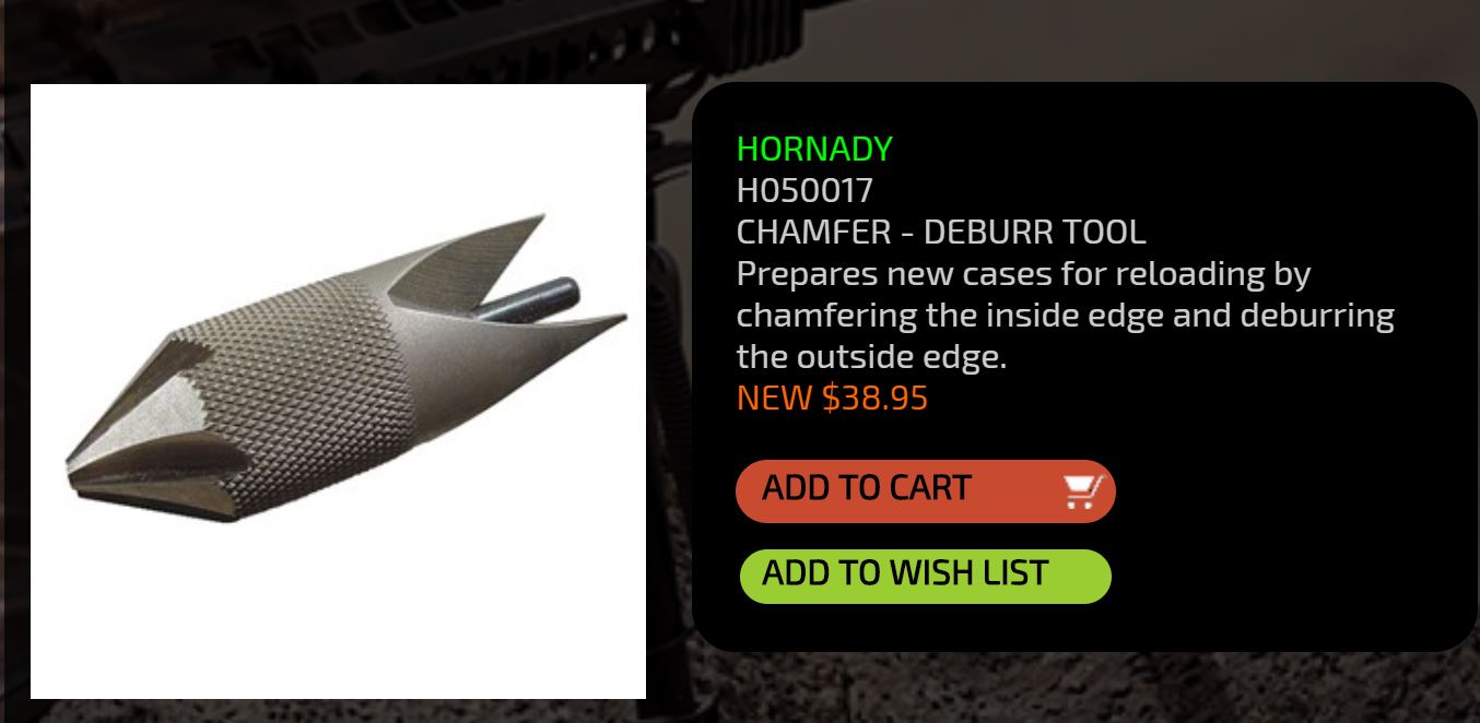

The kit comes with a pocket cleaner and chamfer tool. But if you get one of the better ones you can put it in the drill press to really speed up chamfering the mouth and pocket.
An impact hammer is useful for when you seat a bullet too deep, just tap it back out a little and re-seat it correctly.
I love the scale pan/funnel combo but they don't really work on beam scales.
The Lyman Bleacher Loading blocks are excellent, and cheap. You can stack them up and work down from the top when loading large batches but keeping a small footprint on your desk. https://www.ebay.com.au/sch/i.html?_from=R40&_sacat=0&_nkw=bleacher+loading&_sop=15
If you don't throw your brass about to get it filthy you won't need to clean it.
Chamfer tool.JPG (85.23 KiB) Viewed 6255 times
Lee Kit.JPG (174.3 KiB) Viewed 6255 times

Ok gimme a second I'll post up some stuff with part numbers you will need mate. Info gathered from here and my research when looking
The kit you looking at 90050 comes with most things needed but is missing a few things. You will need some quick change bushings these allow easy swap of dies #90600 or look at other brands that make better ones.
It comes with the quick trim to trim and chamber the brass, but you will need caliber specific die, for 223 it's #90179.
You will also need dies specific to your caliber. You can get them individually or in a RGB kit with 2 dies, the 3 die kit or my preference the delux kit #90694 this one comes with the collet neck size die which the other two don't come with. Full length die, bullet seat die and crimp die. 90% off the time ppl only neck size. And apparently 90% of the people don't use the crimp die
I personally find the lee scale is cumbersome to use but it's as accurate as any digital can be once you grasp how it works.. infact it will be 100% repeatable and never jump or move. So in a way better but slower. There is a pin you can use to lock the weight makes your life easier. Also ensure the left arm of the scale is in the middle of the frame.
The kit comes with a primer pocket cleaner you can use its reasonably ok. The chamber and debur tool is... s**t. Get a LE Wilson one which is the same as the hornady above and rcbs one... but even though L E Wilson make them for the others i found LE one to be the cheapest. Definitely get a kinetic hammer as you will make the odd mistake and want to pull the projectile and start again. Lastly get a loading block makes life easier and the ones in shop are cheaper than the 3d printed ones.
Regarding cleaning can use steel wool, a wet SS pin tumbler, a dry walnut media tumbler or a ultrasonic one. Upto u, I got the ultrasonic one reasonably good at cleaning one you get the mix right... some ppl like the brass to look super shiny and they keep telling me I need to get a wet tumbler.

Post by Gsauce224 » 02 Sep 2018, 9:43 pm
Okay so this is my first post here after lurking for quite a while, reading a lot of the threads and whatnot. I recently got into reloading for my 22-250 (like maybe just over a month ago), this is what I bought as a result of months of looking into what I needed and if I was being excessive or not.
Press/Kit - Lee Breech Lock Challenger Kit ~$250 (this is great, comes with everything you need to get started, including hand priming tool)
Reloading manual - Lee Precision Modern Reloading 2nd Edition $50 (This is a must, can be any reloading manual just make sure you get one, its a great resource, I read this before even attempting to reload)
Dies - Lee Ultimate Die set ~$85 (I got this mainly because I wanted the collet neck die, on its own its around another $60+)
MTM Loading Block - $15
Craftright digital calipers - $30 (crucial component to reloading)
Lyman Case Prep Multi Tool - $50 this beats the case prep tools that come with the Lee kit, but they arent necessary, I used the ones in the kit before buying this, it just becomes a pain on the fingers if doing 50+ cases.
Case length gauge and shell holder - $15 (this is great for trimming when combined with the cutter and lock stud in the reloading kit, very consistent)
Thats pretty much it for the hardware side of things that wont need replacing anytime soon (or ever), unless of course you want to speed things up with digital scales, auto powder throwers etc. But thats too hectic for me.
On top of all of this you'll need to decide on powders, primers and projectiles, and of course brass. So far I havent had to do any major cleaning of my brass other than wiping them off and cleaning out the primer pockets, but I only load about 25-50 rounds a session.
