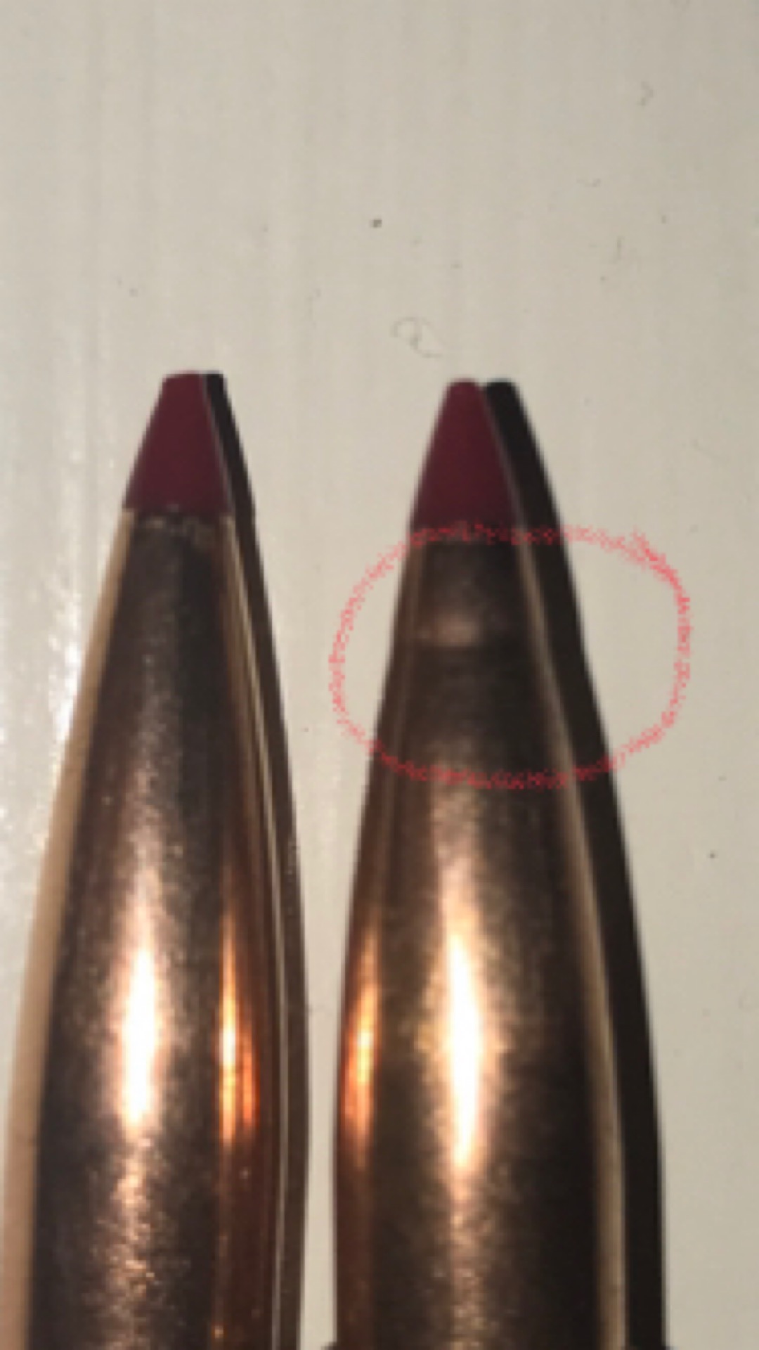

G’day Gents.
I have an issue I am hoping the brains trust can solve.
I have been loading some Hornady 143gn ELD X for 6.5 Manbun and have noticed a slight deformation of the projectile upon seating, as per the attachment.
When I seat the projectile there is a little more resistance than what I would class as normal and the projectiles almost look like they’ve been machined when they get seated.
Projectiles end up with a slight ring around them that is visible and can be felt.
I have pulled seating plug out of die and discovered a ring of copper commensurate with what is happening to projectiles.
I have tried giving seating plug a clean with brush to remove the “fouling”.
Do you think I have a dodgey seating plug in the die?

It is quite normal JT. To stop it happening you can get one of your projectiles and lock it into your cordless drill. Cover it with valve grinding paste and gently run it up the seater plug. This will smooth out where the seater hits the bullet ogive. You then will not see any marks on the seated projectiles.

Post by straightshooter » 30 Sep 2018, 1:31 pm
DANGER WILL ROBINSON
That ring is due to a compressed powder load!
The bullet seats and compresses the powder until it reaches a point where the powder refuses to compress any further.
At that point something has to give and in this case the weakest link is the projectile ogive in contact with the seating stem.
Bubba ing your seating stem won't help at all.

Post by Sergeant Hartman » 30 Sep 2018, 4:58 pm
My lee die do it a bit.. but not that much. What setting die are you using
Re: Problem seating projectiles
Post by Oldbloke » 30 Sep 2018, 5:44 pm
It's just a combination of a softish bullet and the shape of the mandrel (die) not matching the bullet shape. Just need a mandrel that is a better match.

Post by Homer » 30 Sep 2018, 6:44 pm
G'Day Fella's,
Jim Tom, I can think of only one possible cause, undersize inside case neck diameter?
Measure the inside diameter of your case necks. They should be no smaller than say 0.260", and better still, around 0.262" diameter.
You may need to lubricate, and then neck size all of your cases first, before bullet seating.

Post by sungazer » 01 Oct 2018, 8:34 am
The standard Redding Die does not have a Seating stem to suit the VLD bullet shape. You can purchase another seating VLD seating stem that will more accurately fit the nose shape of those pointy projectiles. Lee are even worse and often hit on the very tip of the bullet where there is a lot of variance as well as not supporting the bullet so it can become of centre not concentric.

Post by marksman » 01 Oct 2018, 12:06 pm
if your seating stem was not suited to the vld style projectiles it would be seating off the projectile point not the ogive, polish your seating stem
the reason this is happening is as Homer said the inside diameter of the neck is to small, to much neck tension
you can remedy this by, chamfer your inside case necks better or vld chamfer for an easier entry (maybe), dry lube the necks before seating (maybe),
neck turning your cases or use a bushing die with a looser diameter neck, neck tension should not be more than 3 thou :thumbsup:
to check your neck tension measure your case neck wall, x 2 and add the projectile diameter
then measure a loaded round and take that off the case neck walls x2 and projectile diameter
that will be your neck tension :drinks:
your ammo should not have ring marks on the projectile like that, I will guarantee when you seat the projectiles into the case and have those marks you are also bending the neck of the case that will cause big runout and crooked ammo that wont shoot for ****** :thumbsdown:

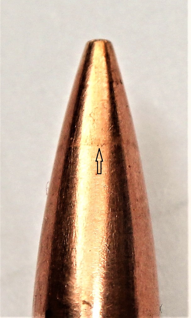

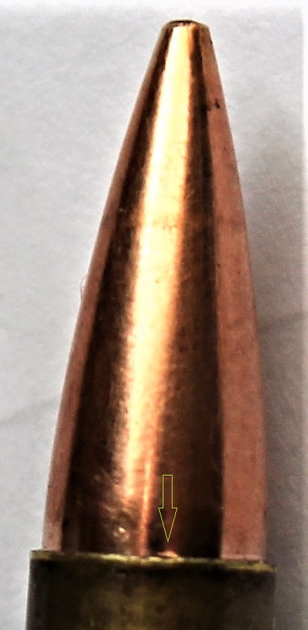

The top pic is of the mark my Lee die makes on the Nosler RDF 70gn and Nosler 50gn Ballistic Tip.
I read somewhere on here someone mention the case taking a scrape out of the projectile as it is seated but can't remember where. I noticed this today, shown in pic 2, it has been loaded into freshly trimmed and chamfered case. Can anyone point to what might be the cause of this happening occasionally?

The ring is caused by the seating stem, you will need to polish it. The case scraping copper off the pill can be cured by chamfering, reducing neck tension and some lube in the case mouth. Have a look at Marksman's advice earlier in this thread.
Accurate shooter had an article about polishing seating stems and tipped match kings deforming the tips when the seating stem cannot accommodate them. It was written by Sierra bullets, good advice from a world class bullet maker.

Post by Gaznazdiak » 02 Oct 2018, 9:17 pm
As the ring is only cosmetic I'm not bothered about it, it's nowhere near enough to disturb flight.
The thing I'm having trouble understanding is that, as I mentioned above, the case had been freshly trimmed and chamfered.
I use the Lee chamfer tool with the zip trimmer and looking at the result with a jeweler's loupe it seems uniform and clean on each case but every now and then I get the result above.
I've rolled the loaded rounds in the zip trimmer and to my eye they seem to be aligned with the overall case axis, with no perceptible wobble.
The batch involved were weight batched as well as the pills but when I tested them in 3 round groups, they were about 2.5 inches at 200m. Every group had 2 within 1 inch and one flyer out at 2.
It's got me scratching my head, I can usually get boringly predictable 1 inch groups with the Nosler 50gn Ballistic Tips but the RDF 70gn are giving me a headache.
What I can't understand is that I've used them before with excellent results, so I'm obviously the variable causing the issue.

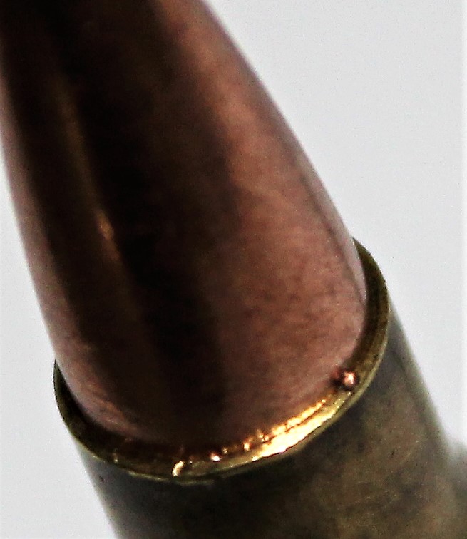

Post by Flyer » 03 Oct 2018, 1:53 pm
Gaznazdiak wrote:The top pic is of the mark my Lee die makes on the Nosler RDF 70gn and Nosler 50gn Ballistic Tip.
It might be my eyes or the photo, but to me that neck doesn't look like it's been trimmed evenly. In fact, it looks like there's a rough spot right where the mark on the projectile is. I get dents in the top of my 223 brass sometimes and need to trim a bit extra to get them out. You can feel it when you chamfer the neck as the chamfer tool doesn't spin smoothly as it catches on the edge. Sometimes the dents are too small to see with your eye, but you can feel them.

Post by Gaznazdiak » 03 Oct 2018, 4:02 pm
I'm a bit slow, just reread your comment, Flier. That under the arrow in the second pic is a small shaving of copper that the harder brass of the case has scraped up, sort of like a small inward dent in the neck would cause, so maybe some of the cases have some damage.
I have a tight-arsed habit of putting my wieght batched brass in clip seal bags instead of plastic storage boxes. They live in those bags for their lifetime and come into the field with me and I put the empties back in with the unfired to keep the batch together, this might be a possible cause of small dents.

Post by Flyer » 03 Oct 2018, 8:57 pm
Gaznazdiak wrote:I'm a bit slow, just reread your comment, Flier. That under the arrow in the second pic is a small shaving of copper that the harder brass of the case has scraped up, sort of like a small inward dent in the neck would cause, so maybe some of the cases have some damage.
No, I'm talking about under the shaved copper, there appears to be a rough edge around the brass. In fact, if you look at the top edge of the brass, to my eyes it doesn't look straight, it looks like it is slightly jagged. It might be the photo - possibly uneven light - but it doesn't look like it is flush trimmed. I admit I'm also a bit OCD about reloading and have an electric trimmer (Trim It II) and after trimming each piece of brass I'll turn it by hand just to ensure it is trimmed evenly.

Post by Gaznazdiak » 03 Oct 2018, 11:43 pm
Hey Flier,
On further investigation(seems OCD is contagious) I worked out that the batch in question has only been fired 3 times and I trim after 4 firings, so it hadn't been trimmed or chamfered yet after all and you were right on that being the cause of the scrape. Photographing with my camera instead of my phone gives a better look.

Post by Flyer » 04 Oct 2018, 12:01 am
Problem solved :)

Post by SCJ429 » 04 Oct 2018, 9:29 am
If you outside chamfer second you can push the case neck inwards which might shave copper off the projectile. This often happens with electric powered tools. Inside chamfer second and if you are keen you can smooth things out with some fine steel wool.
