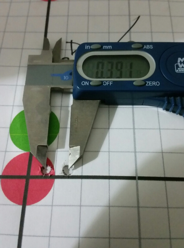

In trying to re-sight my 204 in today, ive also had gòod results with my annealing test.
After 5 firings my groups have opened up (a couple of firings ago) to .7"-.8"...sometimes out to nearly an inch.
So i finally FL sized, trimmed, chamfer deburr & annealed the cases.
Then i neck sized them again...
So the load i use shoots a relatively consistant .3"-.4" at 100m (110yds)-(before they opened up a bit)
While i was only shooting 2 shots at a time for this exercise today (sighting in), the 2 shot groups (not really a group i know) but the pairs of shots are at .4"-but now at 200 yds...!!
204 200 yds 3-5 mph wind chopping from 11-1 o'clck
2018-10-28 22.38.39.jpg (292.73 KiB) Viewed 6963 times
Im pretty happy with that...so far the effort to anneal & re-prep all the brass looks like it was worth it...for me anyway.
