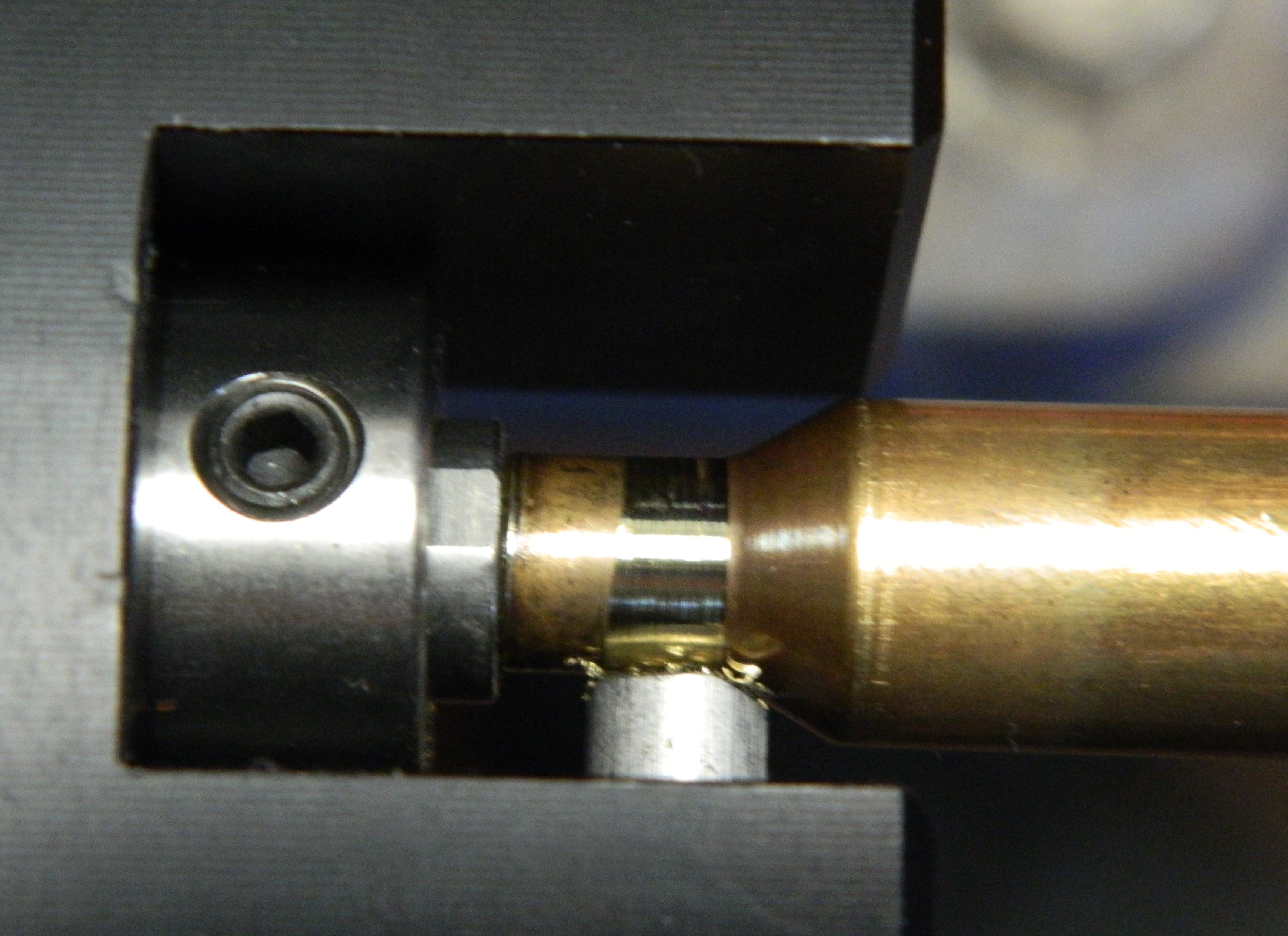

I initially started doing this by hand............
DSCN3080 (2).JPG (983.88 KiB) Viewed 7773 times

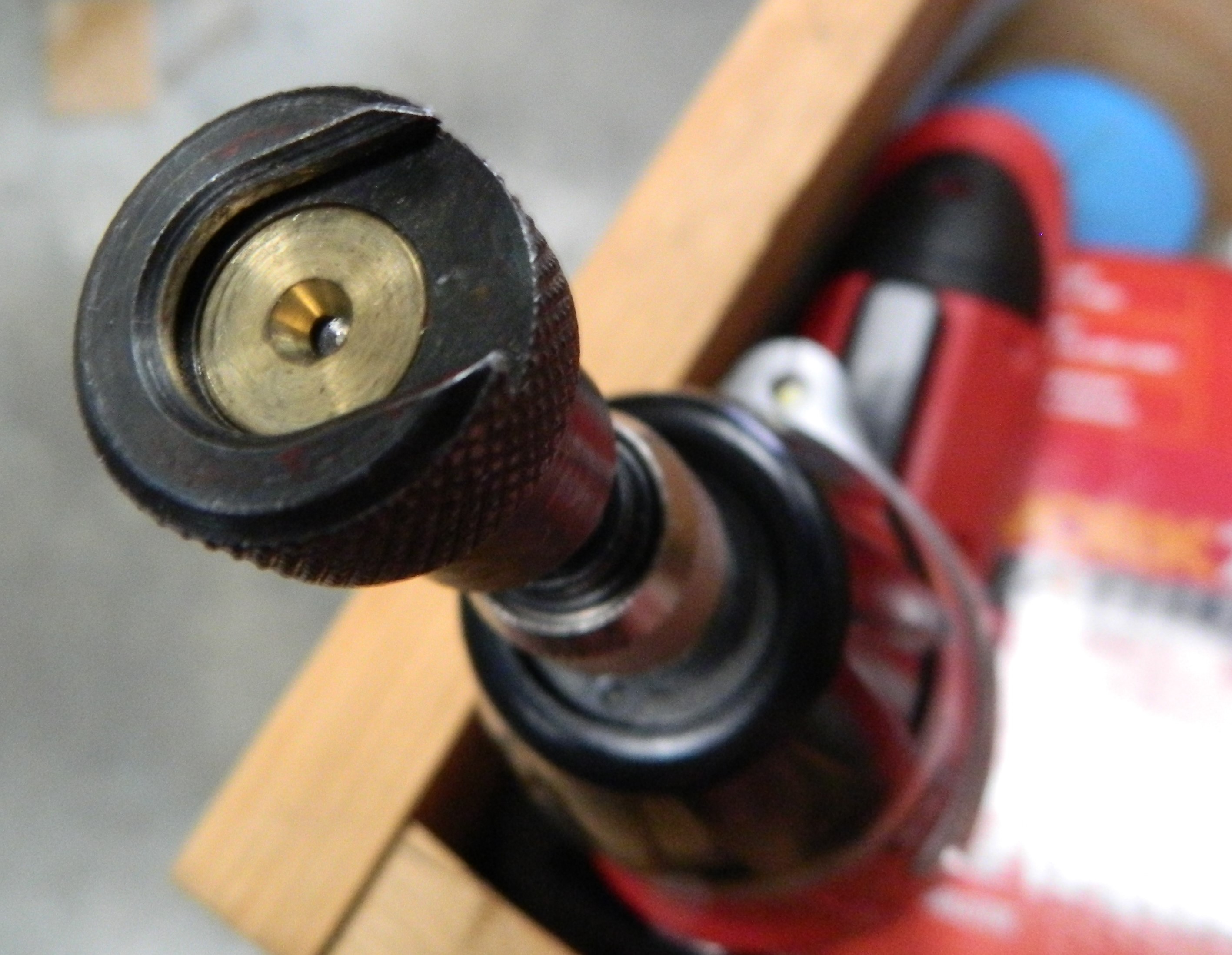

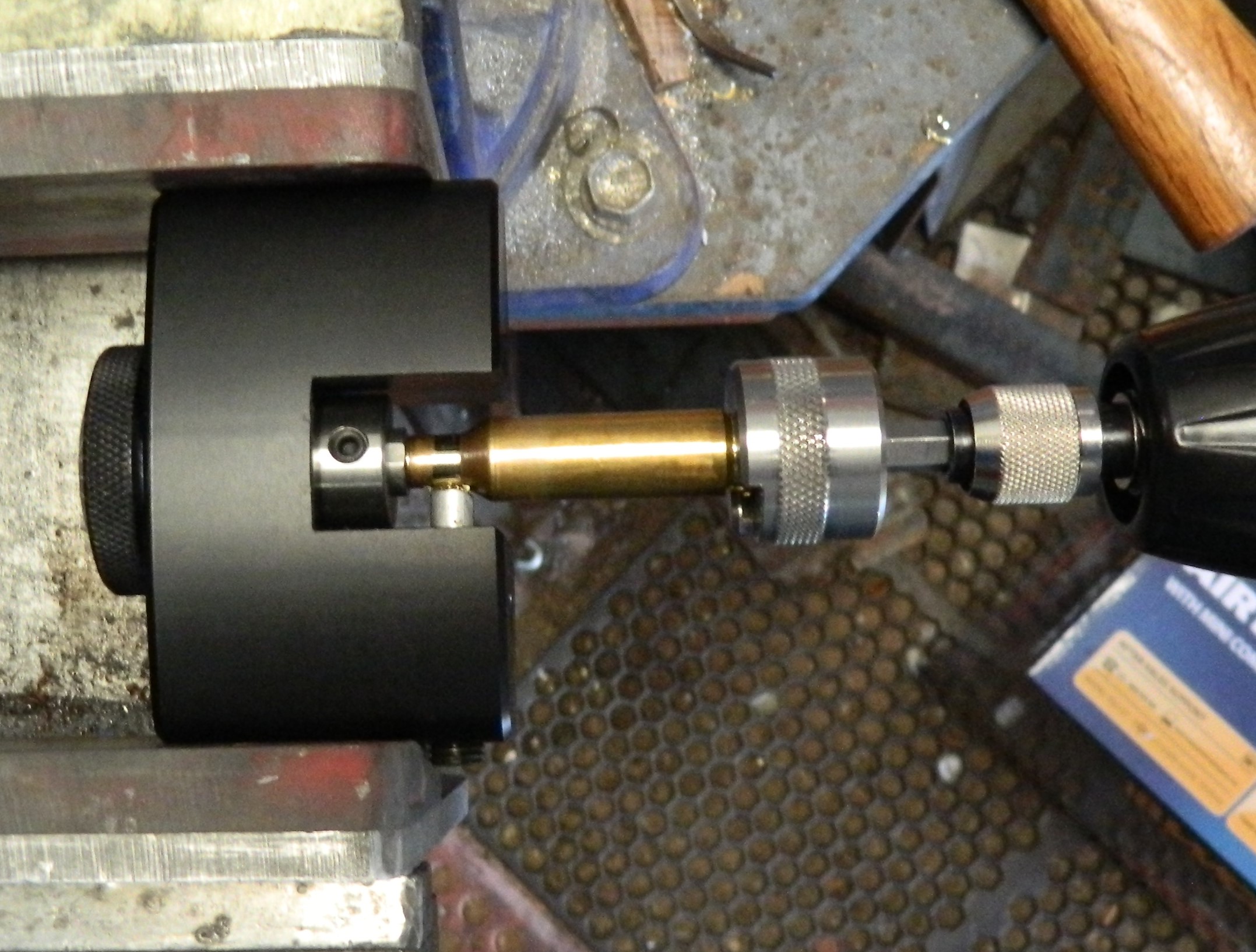

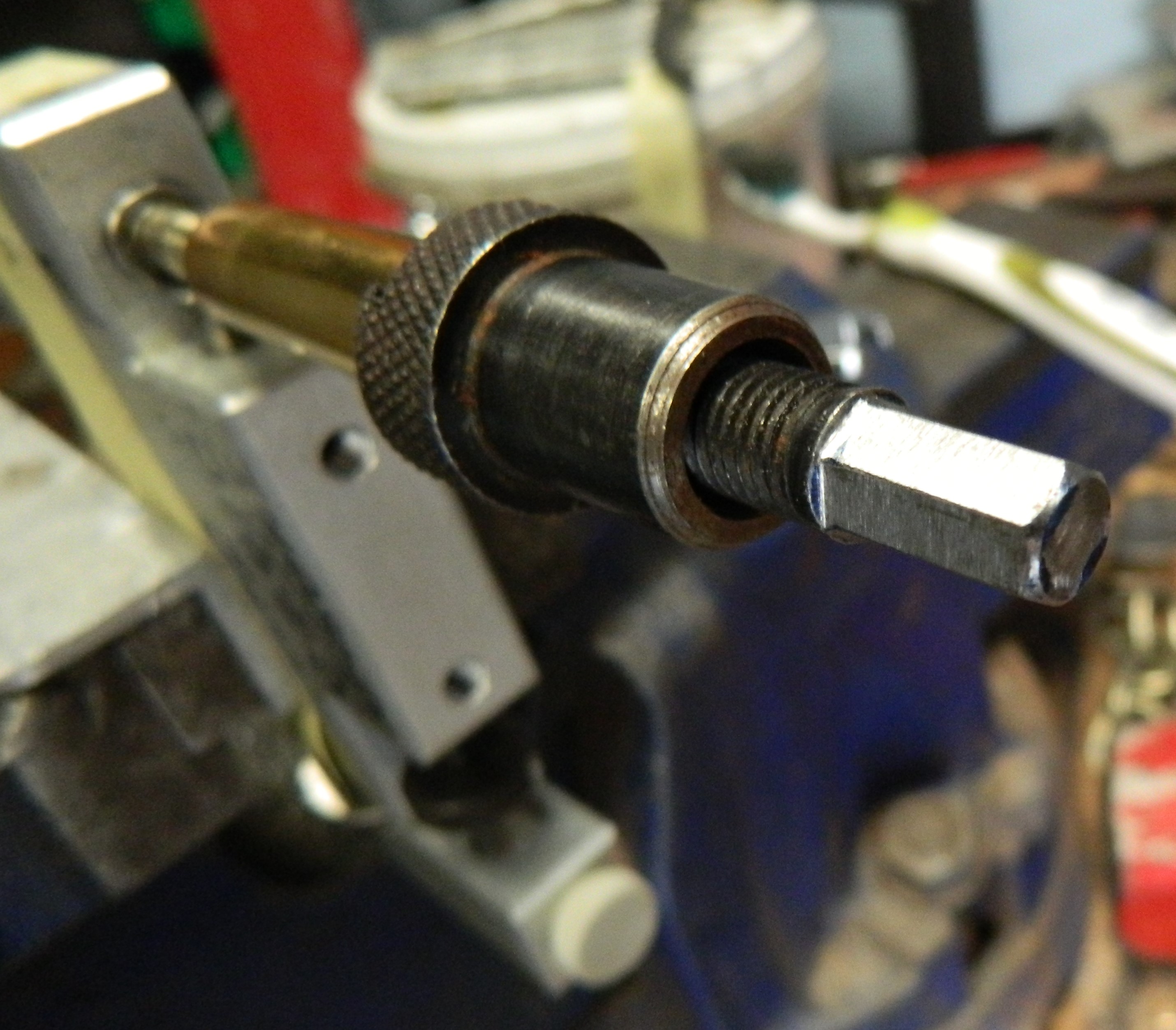

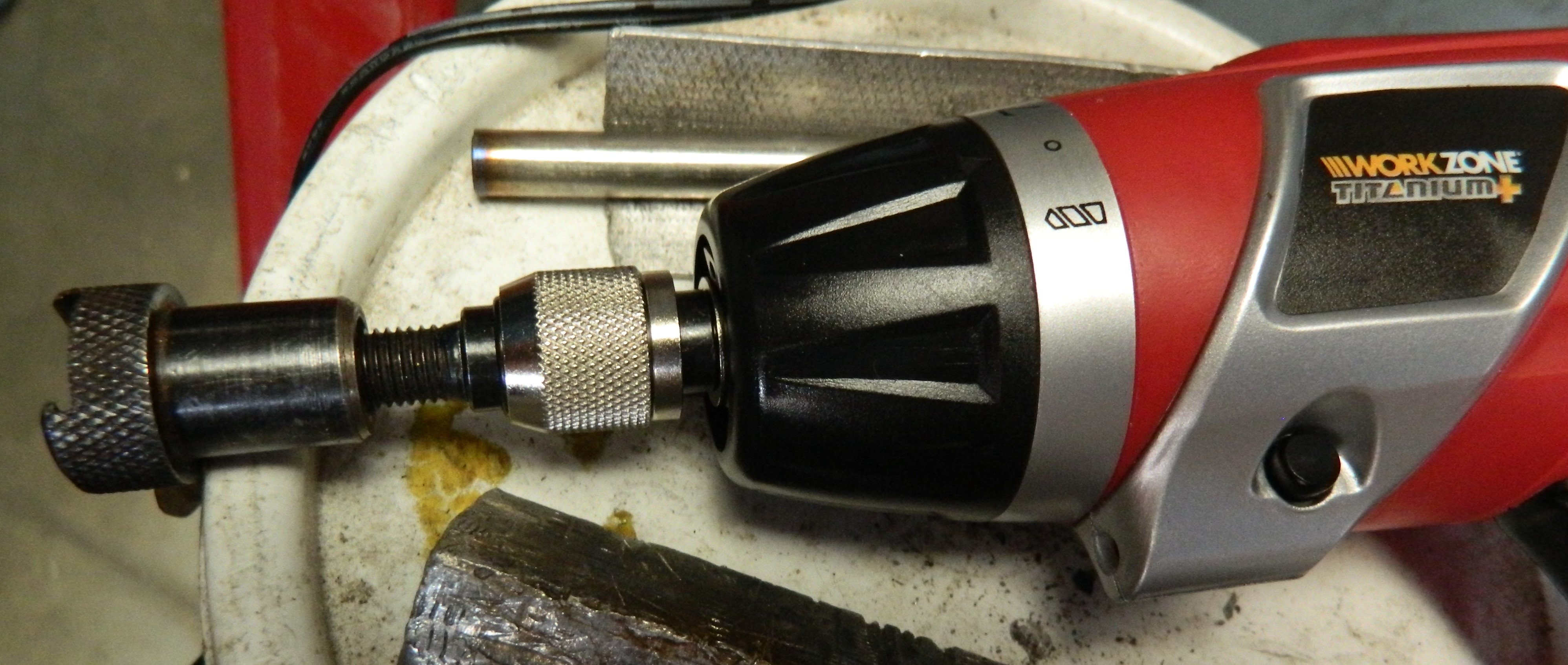

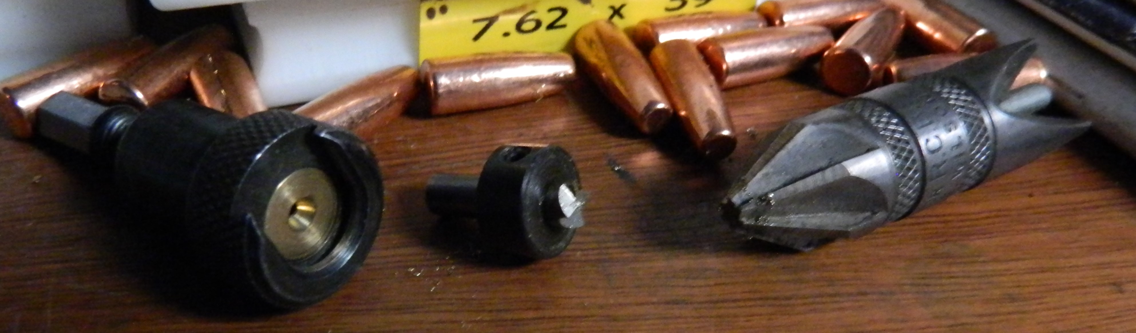

But as I was doing this, I remembered that I had a Case Holder (Simplex brand?), which I then modified, so I could use a cordless screw driver.
I first machined off the Hex head of the 5/16" bolt, and then made it and part of the bolt shank, into a 1/4" Hex drive, to fit the cordless screw drivers, Quick Change chuck.
I also counter bored the inner face of the case holder, and machined up a Brass insert, to fit in there.
This speeded up the job and it appears it was doing a better quality job, over doing it by hand.

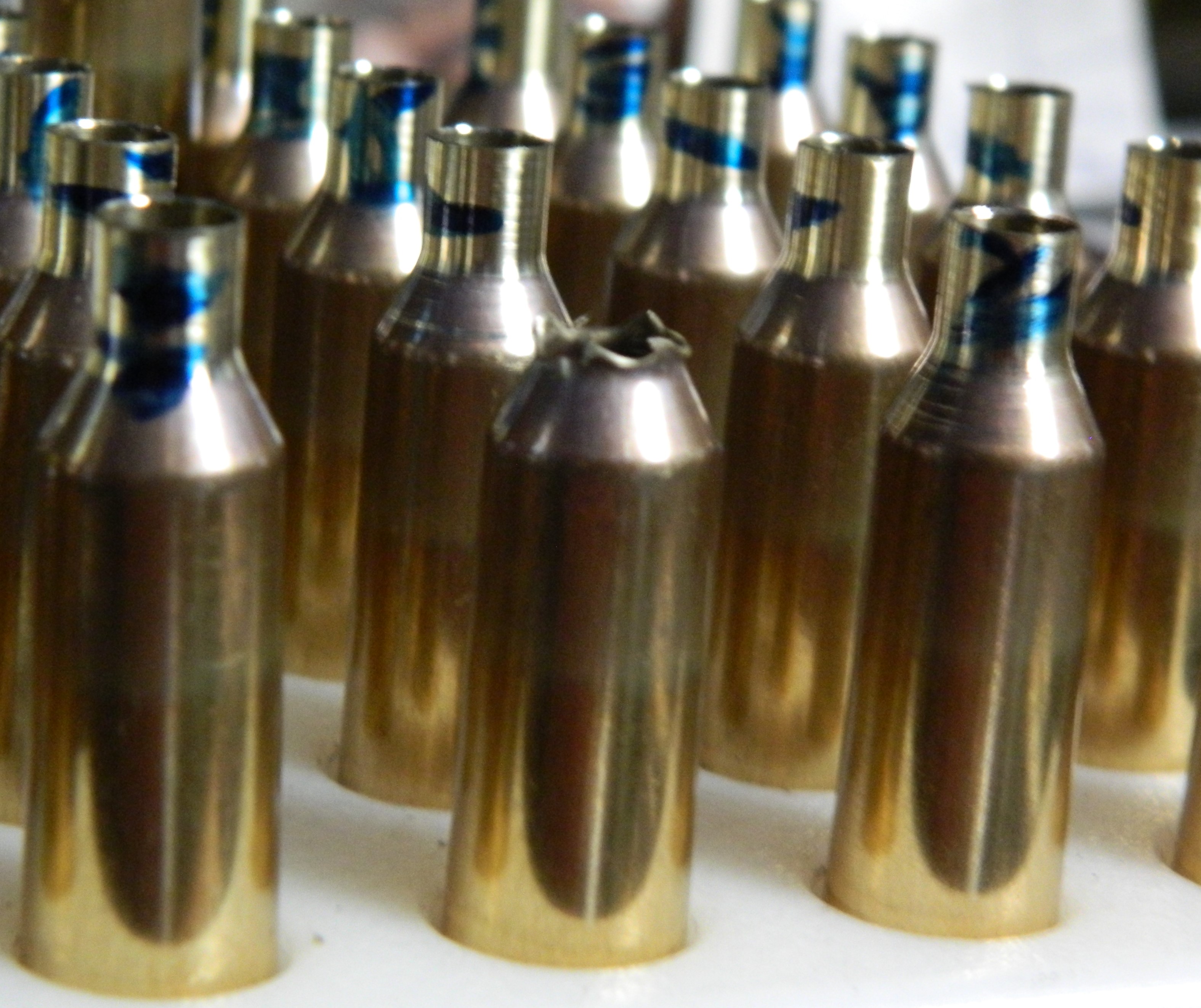

But, Speed sometimes comes at a price......... at $1.78 retail price per case, it could also be expensive, if I pushed it to hard to soon......... BUGGER!
I also debured the inside of the case neck and uniformed the Primer Pocket, while I was at it.

Not a bad effort although the reverse way I go about it which probably caused the stuffed case. How much are you cutting per pass and how are you measuring the case neck thickness. ?
Don't know if you would like some hints for a better job in the future.
Already been accused of giving someone a lecture here so I'm not going to offer advice unless it's wanted...

I have never tried to turn a neck by just hand. I don't think it can do the job properly. By looking at your first photo it looks to me that the shaving coming off is too thick and then the second photo to me shows too uneven a cut like it's skipped some material. You say you aren't bothered doing a rougher cut then a finish but in my view this is required if you are taking a lot of material off. Also required if one wants the neck thickness to be as even as possible. Some of my cases like my 6.5x47L and 6mm PPC where the necks are required to be really thin (0.010" & 0.085") I do in 3 cuts with the last very fine.
In my view, I think holding the Neck Turner in a vice is not the best method. I use a K&M Power Adapter in a Cordless Drill on part low speed (less than 100 rpm) for my first cut. I hold my K&M Neck Turner in my other hand so I can just guide it onto then down the neck with virtually no pressure just letting it cut it's own lead then with a slight pressure at it touches the shoulder of the case. Then back it out slowly. I then do a second run down to the shoulder and back slowly. I have another Neck Turner setup for the second cut and do the same. If I'm only making the two cuts then the last pass I do at higher speed, say 3-500 rpm which seems to give a nice even final cut if anything at all other than a polish. Finally I run a kitchen scourer over the neck at highest possible speed for a polish, some use steel wool but I don't like the possible mess it leaves. BTW, I think I have a half dozen neck turners all set differently.
The neck that you show in a photo that has been torn off I would believe is the result of being too aggressive and lack of feel with the turner being in your vice rather than in your hand.

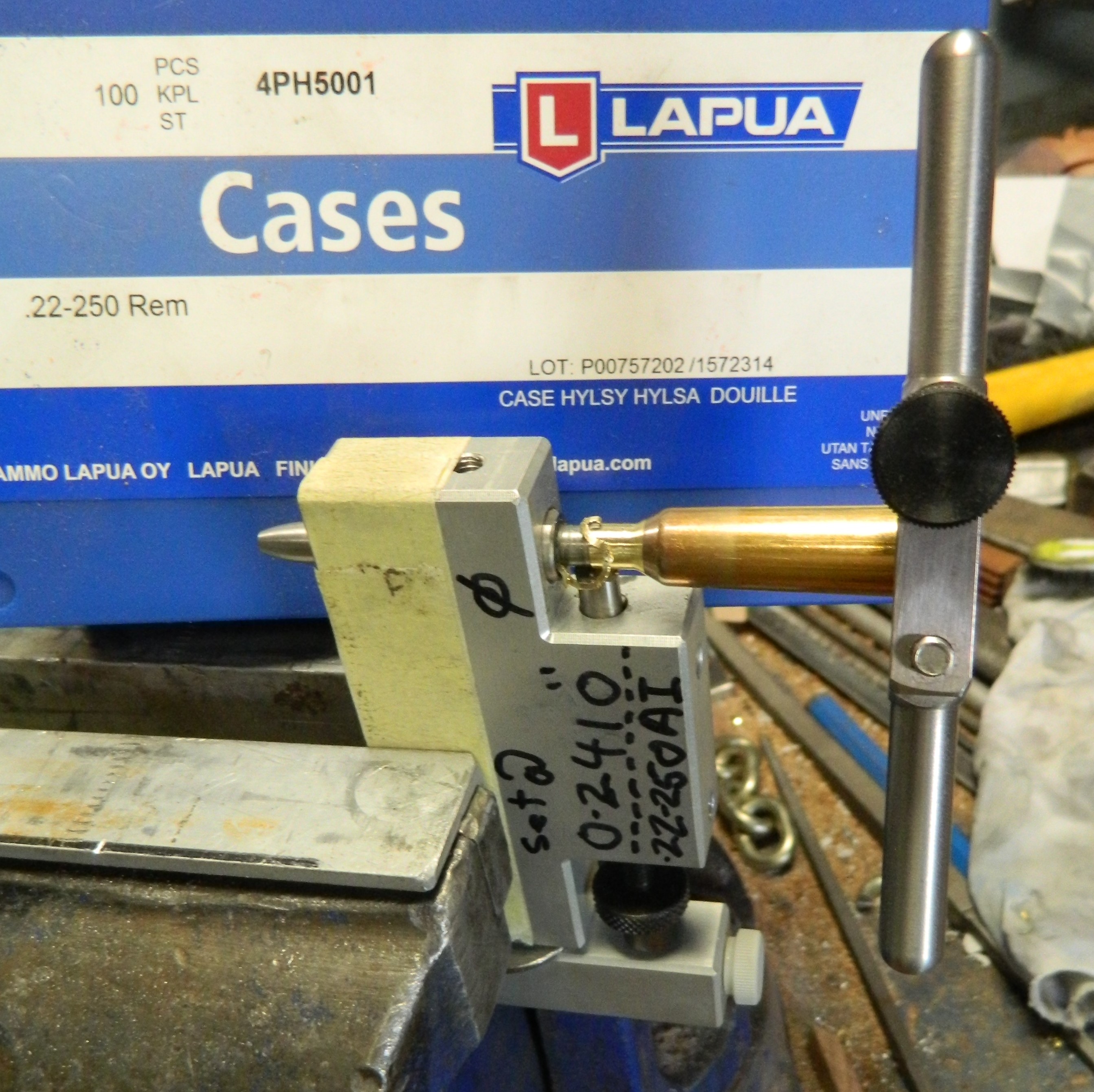

I use both a Mitutoyo Ball Micrometer (for neck thickness) then highly accurate normal Micrometer to make my final measurement of the case neck with a bullet seated in it making sure I measure the area of the bullet's pressure ring to ensure I have the clearance I require in a tight neck chamber. I do not use Calipres for any of these measurements as it's just not accurate enough of a measurement.
As I said, each to their own. I hope I have explained my method I use to get the best result from the time I spend. I know my efforts are rewarded from a few people I have done this for that win 1st places in national competition.

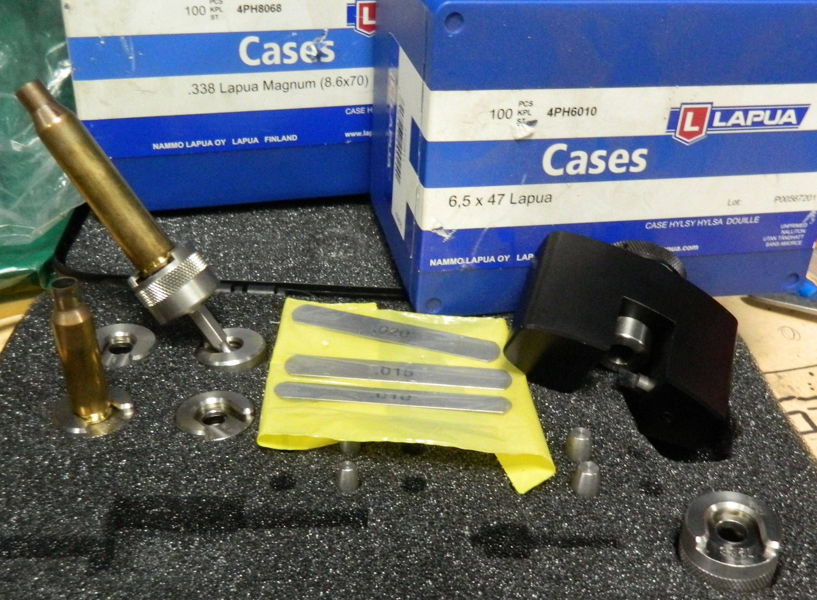

I have a 200 6.5 x 47 Lap cases and 100+ .338 Lap Mag case, the I want to even up the neck thickness on.
I'll get to this, some time over summer, and if I remember to, I'll take a few images, and post on here.
Both these rifles have minimum spec chamber neck diameters (but not Tight Neck).
I have been advised that evening the case neck thickness, might improve group consistancy a little.

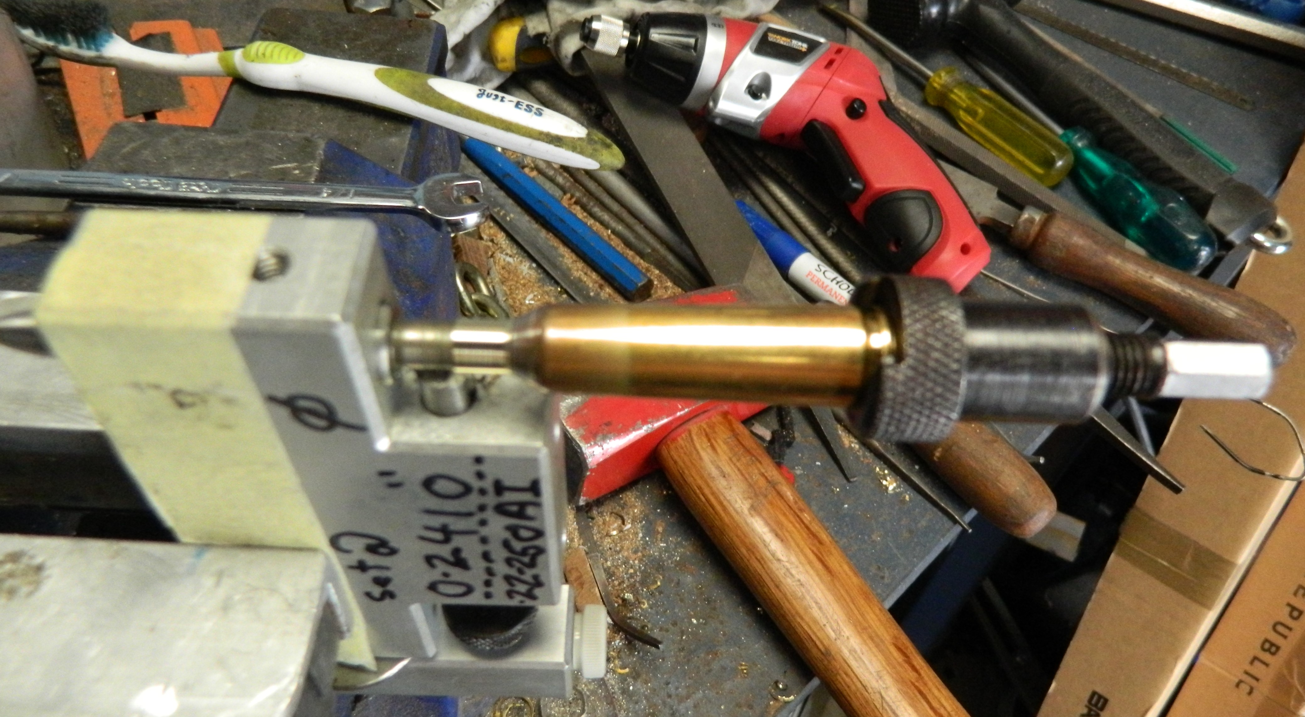

G'Day Fella's,

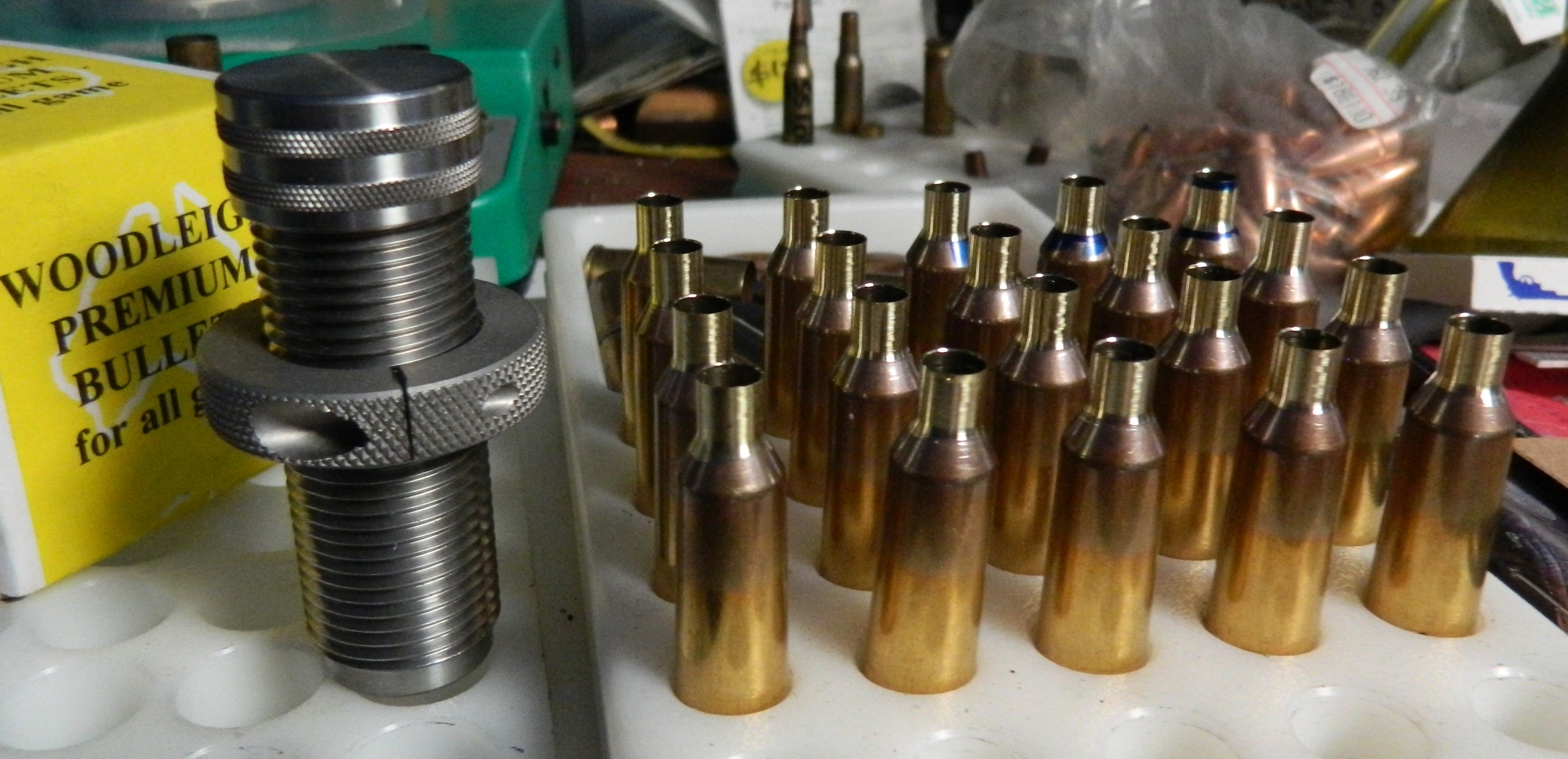

I finally got the 6.5x47 Lap cases/necks finished
As I suggested, this barrel has a minimum spec neck diameter chamber but not a tight neck one.
So, all I'm trying to achieve here, is to uniform the case neck thickness, nothing more.
The initial neck turn, shows a similar pattern with all the cases necks.
That being, the case mouth area, being a bit thinner than the lower section?
Here's some images;
I'll give these a rip down range, and see what occurs.
