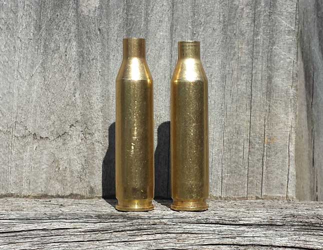

I guess you've got a .308 and are swapping to a 7mm-08? I'm thinking about doing the same and will have 300 brass to resize for it too.
I can upload a picture when I'm home later... I've resized .308 down to .243 in the past and could do it in a single pass with no problems, and .308 to 7mm-08 is less of a change than that.
I'll post a picture anyway just FYI so you can see the result.

Post by Lorgar » 22 Jan 2014, 4:46 pm
Lorgar wrote:I can upload a picture when I'm home later... I've resized .308 down to .243 in the past and could do it in a single pass with no problems, and .308 to 7mm-08 is less of a change than that.
Here's that picture, Harlow.
.243 vs .308 necked down to .243
Case on the right is the necked down .308, done in one pass. Left case is factory .243 brass.
The top of the neck on the right looks like it has rings around it, but that's just lube/grime.

Thanks for the picture too Lorgar. Looks good.
