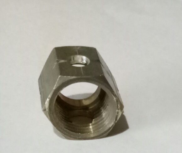

Post by Oldbloke » 13 Nov 2018, 8:49 pm
For a long time now I have measured to the bullet tip. As we know not ideal as there is sometime makers variation or minor damage causing some variation in length. I've compensated by measuring a few and calculating an average.
Anyone considered making one. Just looks like a nut with hole drilled in it. They are about $60 to buy. Seems a rip off to me.
I figure a 5.5 mm for 224 and a 7.5 mm drill for 308 will be just about right.

As KC said, it's just a hole. All that matters is that it is accurate enough to give you the same measurement consistently.
I bought the full Hornady kit with all fourteen caliber inserts, not a bad piece of kit at all.
The holes are 13-thou undersize, so .211" and .295". You ideally want the hole to match the rifling diameter so you are measuring the exact point the bullet meets the rifling.
If you don't have a lathe, drill the hole undersize, then hone it up to the required size with a split rod and a strip of emery cloth in a drill.
Or you could just buy the inserts and cut a slot in those so they fit your caliper without the holder.

Hey Oldbloke probably no surprise but I made my own. I do have the advantage of having a lathe not that it is really necessary. I got a small bit of round SS bar stock and drilled it out using ever increasing drill size until I got to the correct sizes. It is best to go a bit undersized then hone it out with wet and dry. I made one end a bullet comparitor and the other end for case shoulders.
Re: DIY Bullet Comparator
Post by Oldbloke » 17 Nov 2018, 7:15 pm
Done. Took about 15 minutes.
A 5.5mm & 7.5mm drill for 224 & 308.
Near enough.

I have made a DIY tool from a brass nut drilled with 5.5mm and it seems to work well.
My initial setup is just measuring the projectile before seating which I'm doing with a dial guage; I was worried that even a light micrometer touch might force the projectile taper in the hole too much and I figured the spring tension in a guage is light and constant.
I have a test calibration projectile that I drop in every few measurements and it gives repeatable +/-0.001" readings so the DIY tool does give accurate figures but no doubt some will argue that 5.5mm might not be the perfect bore...dunno. I was surprised at the ogive tolerance spread but I know for my rifle that 0.1mm makes a big difference to my groups.
