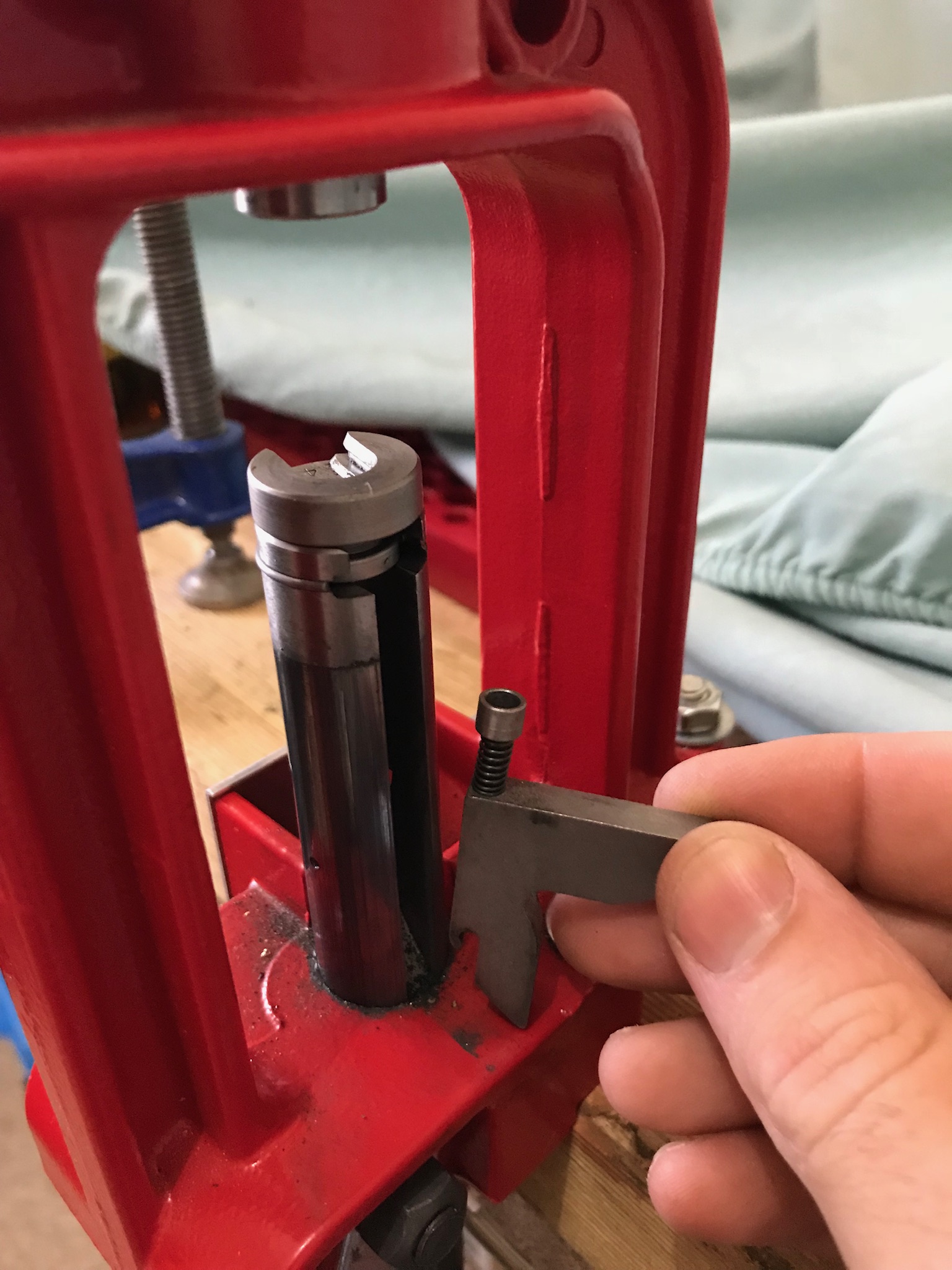

Here is a picture of the primer arm that slip into the press. A small primer and large primer one come with the press. Lee have a safety prime system that feeds the primers into arm on the press. I've only feed the individually into the press.
If you buy the Lee breech lock challenger kit it comes with hand primer. It doesn't come with the Safety prime setup to auto feed for press priming. But you can still feel what it's like by feeding primers individually.
It's confusing. I know!
The other thing with the Lee hand primer is it uses hand primer tool shell specific (shell holders). The press shell holders are different. Lee dies come with free shell holders for the press. The Lee single stage challenger kit comes with a packet of shell holders for the hand primer press.
Most of the other priming tools use the "press" style shell holder.
Cooper

The press comes with the two primer arms regardless of other priming systems. The press-mounted system is an add-on to the primer arms, it doesn't replace them. The hand primer is additional, you can still prime on the press.
https://www.ebay.com.au/itm/Lee-Reloading-Press-Primer-Arm-Large-BP2889B/362100184761
