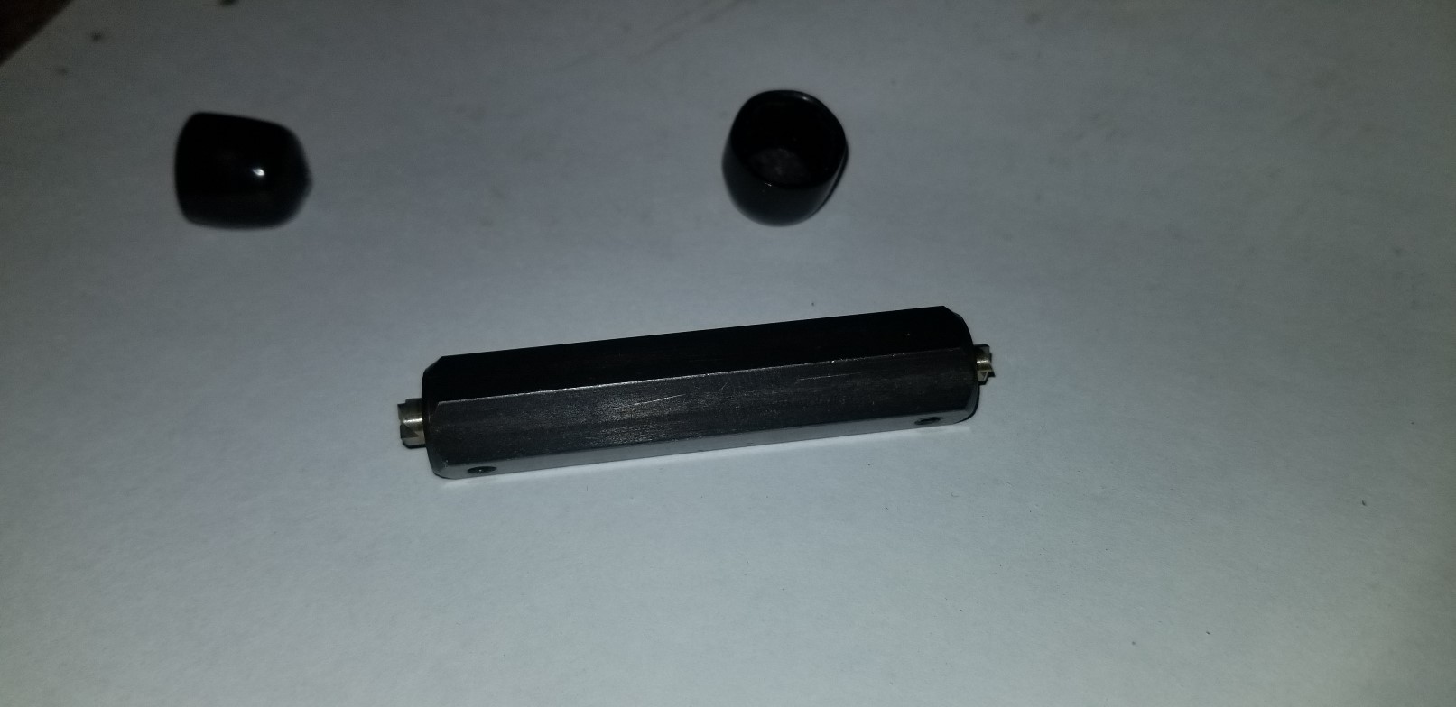

I have used two types of pocket reamer/uniformers before I got the one I have now.
I use them in the drill press and uniform my pockets in all my brass before I start loading it.
Although the first ones worked just fine, I managed to shear the spindle on one or maybe two of them.
The current one is made out of hex bar stock by a machinist in the US and I LOVE it.
For removing crimp I use a 10mm drill bit in the drill press, and then cut the pocket to depth.
