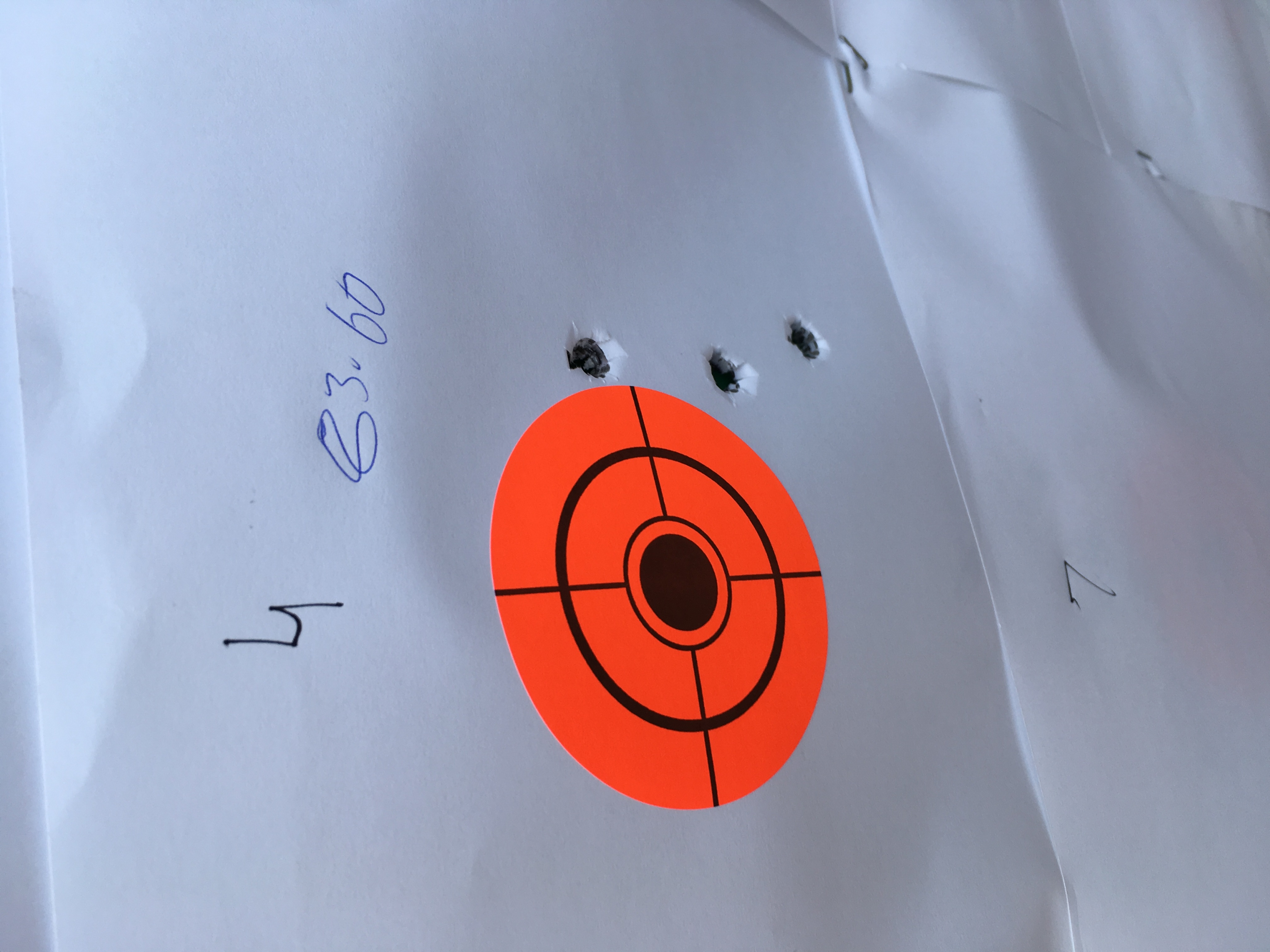

Spent a good portion of my monthly day off at my local quiet spot - new steyr pro hunter in 30-06 in hand.
M8 x 6 leo scope fitted.
Bench and vice set up at 120 yards.
Numerous 3 inch organge ctargets staples to a huge back board.
165 gn reloads up to max adi
200 gn reloads up to max adi.
180 gn Winchester hunting for comparison.
1st thing - 120yards with this scope is difficult in the heat. Orange dot shimmering but the gun vice helps secure cross hairs but still - maybe I should have moved closer for this set up time...

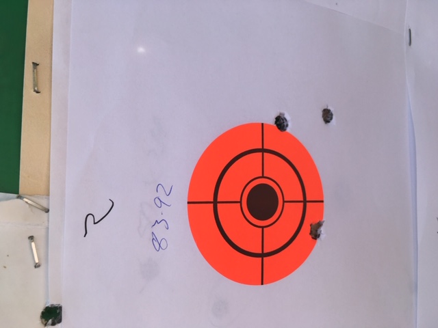

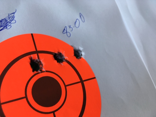

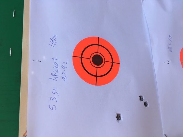

165 at 54gns - 90mm group...wtf?
The best I shot was a 35mm group with 58gn of AR2209. Not thrilled.

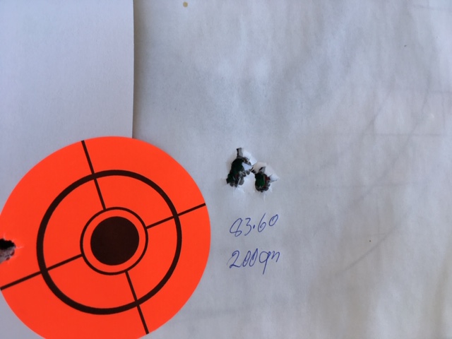

Let barrel cool and start on 200gns.
Similar thing. Some groups were 125mm.
I did find that max load pulled it in to 30mm but still - not great.
So zeroed scoped and tried Winchester hunting rounds (180) and well - I could hear the roo giggling at me. 2 shots were within 30mm and 1 was 3 inches away. Now I’m pretty reasonable at calling my pulls but .... I just don’t know.
I feel like I’ve wasted a day and a lot of ammo.
The rifle was effectively brand new - 20 shots and then cleaned.
I know the brand - steyr and my .223 is a varmint but an absolute laser.
All reloads were .30 from lands. The hunting rounds were another .60 shorter again.
To do??
Take the most accurate findings and try and develop around bullet seating depths?
Get closer and repeat to endure more consistent?
Write it off - hey, everyone has a bad day?
Take rifle back and stamp feet proclaiming that I am a farken crack shot but can’t hit cracks with this ?
The barrel is still finding its feet - put it down to experience and do over?
Procure a more familiar scope and start again ??
Happy to hear thoughts on this one. I did record everything for reference but with groups so wide, I’m not sure it means much.
I’m not knew to developing loads - but thus far, most have gone to plan...this one has me asking more questions than I have answers...??

Anyways - spent a few hours testing again today. Unfortunately it came out bloody hot again and at one point, barrel became too hot to touch - which was not what I wanted at all but it had only shot 6 bullets after being cold, so caught me out.
So kept distance at 120m.
53.0gns of Ar2209 powder pushing 200gn ELDX.
Shot off a steel rest that lightly cradles fore end and stock, mounted to a table. Free to recoil.
Noticed a fair bit of vertical stringing - 2 and 3 inches on some loads.
Be keen to hear people’s opinions except for the outright obvious.
Was concentrating on bullet seat depth this time out - charge remained same.

Too much vertical, looks like you are going too slow. One group that is OK next to other groups that have a ton of vertical. I would say if you shoot 8360 again, chances are it will have heaps of vertical. Do you know how fast they are going?
