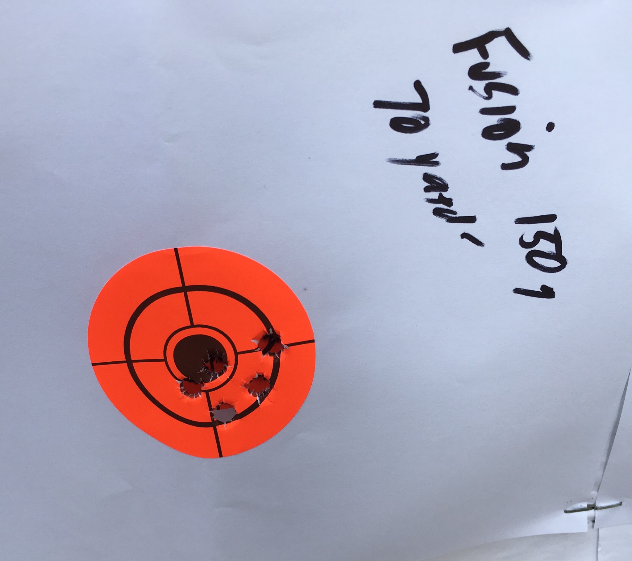

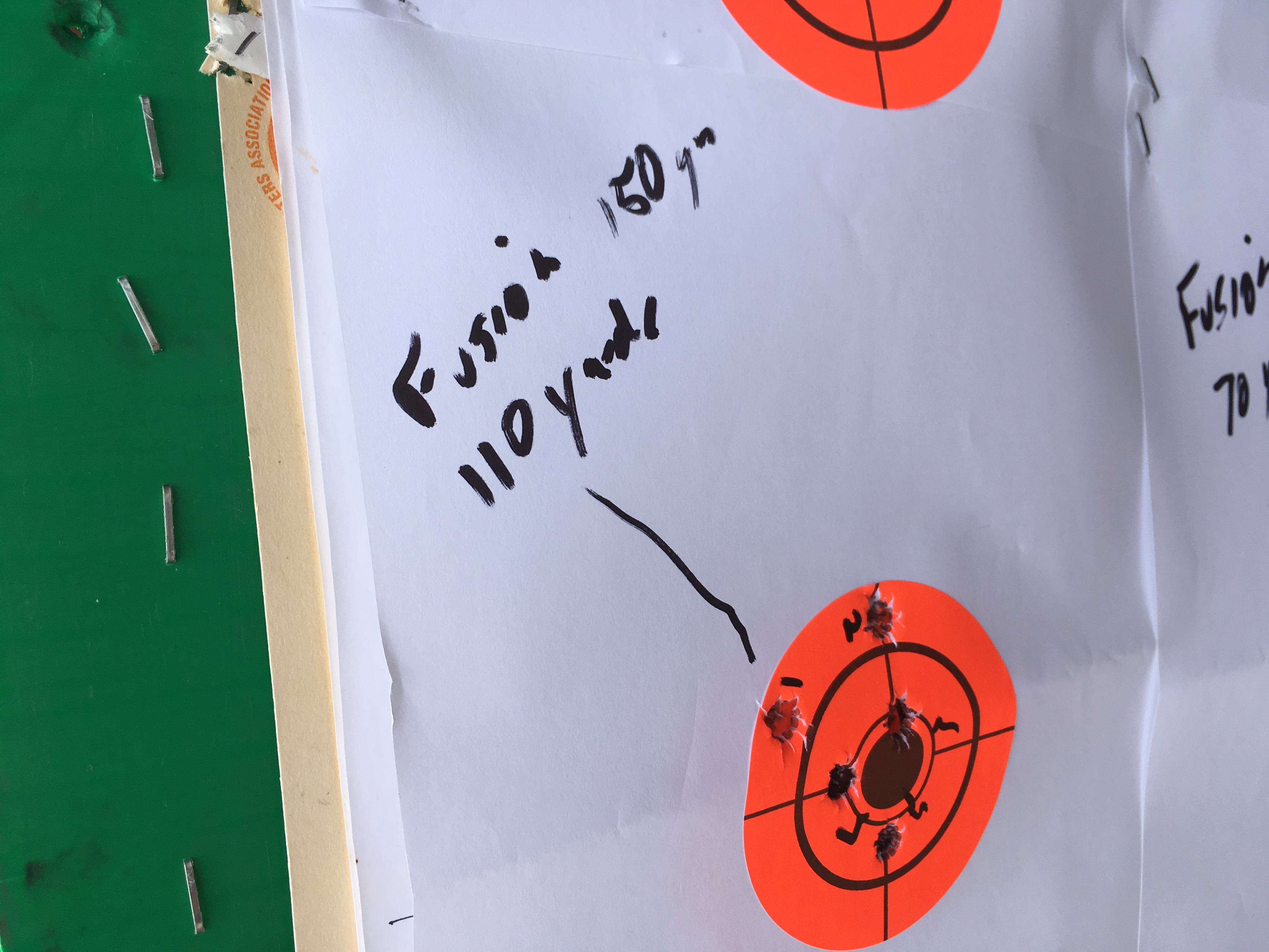

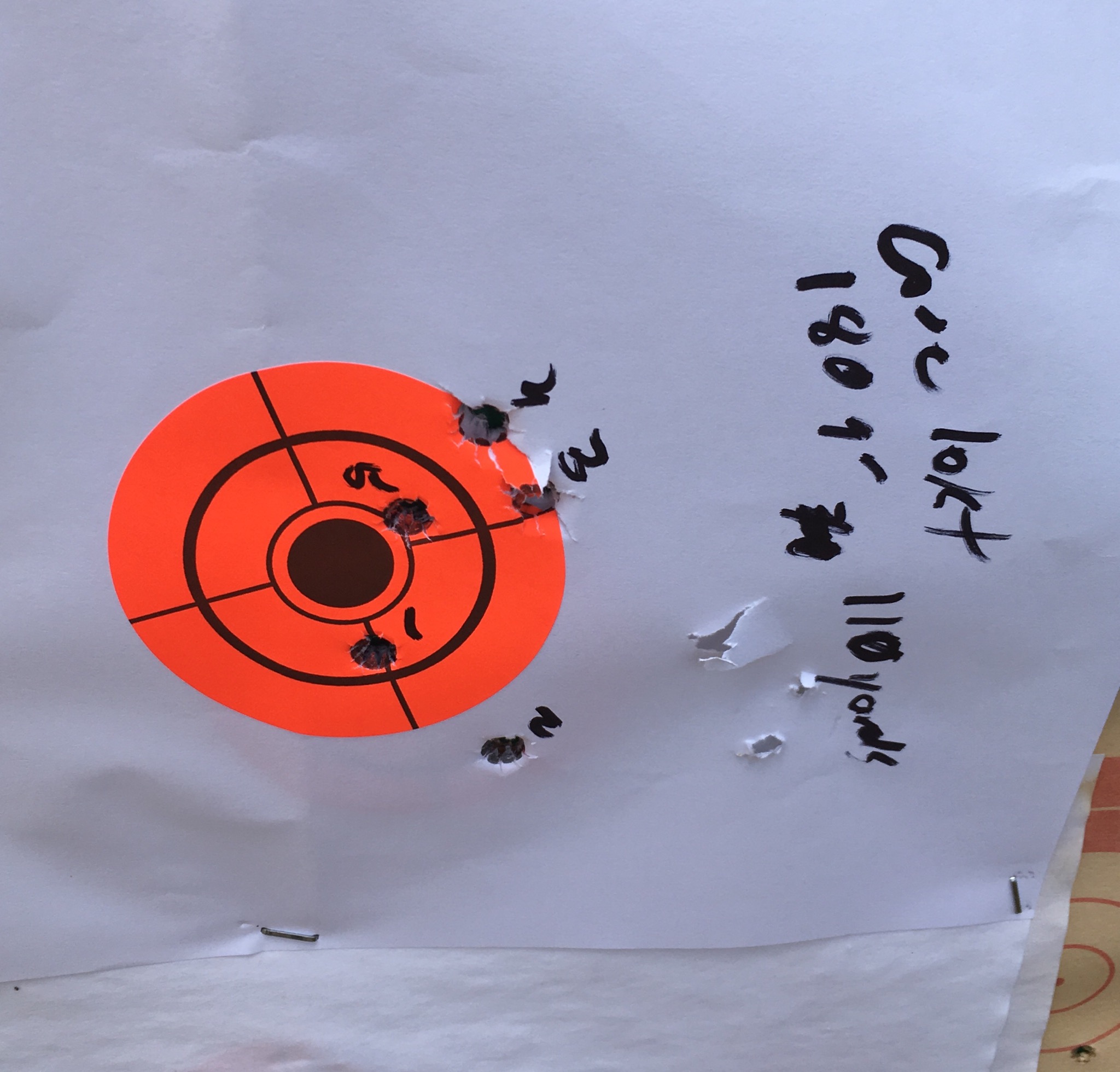

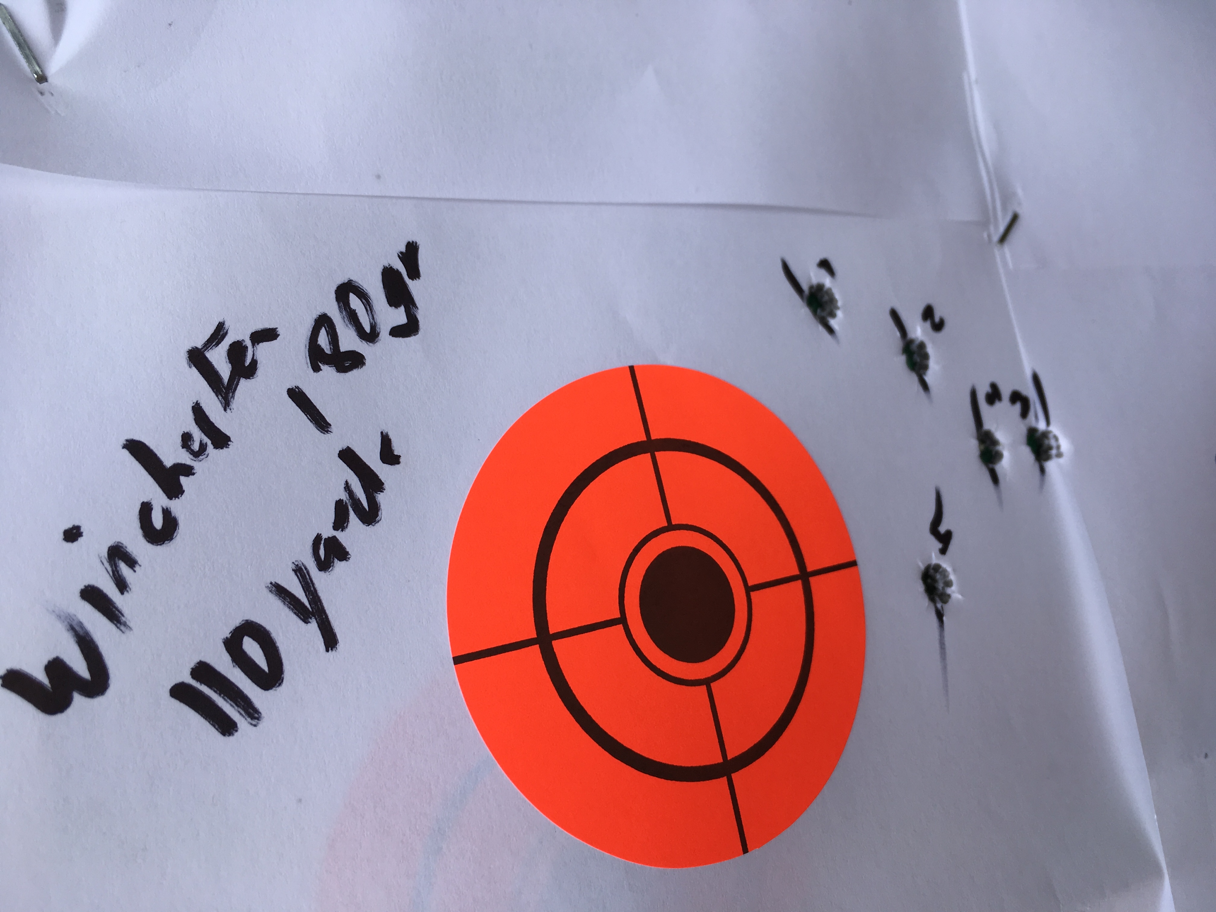

So...went up to range again and this time took a known local shooter - cost me a six pack to get his opinion - bargain lol.
He’s a guy I really don’t know very well but I know he has been shooting for a looong time in clubs and field.
He told me to bring only factory ammunition and he was going to shoot 5 shot groups from a rear bag and bipod rest. Took win 180’s, Core-Lokt 180’s and fusion 150’s.
He asked to go into 70 yards for the first 2x 5 groups - as he, like me thought the scope vs 3 inch decals were a bit of a mismatch. Anyway, he said he sighted the black circle each shot.
Here are his results at 70 yards and then back at 110 yards.
This took us a long time - 3 hours to ensure barrel was cool enough. I’m happy to see his results - pretty much emulated mine with factory ammo...he was not impressed but did say the 150’s would be worth developing and maybe 165’s. But as he pointed out - you don’t buy a 30-06 to shoot 150gn bullets...
Still waiting for winch Aust - has been weekend ...
Posts: 3704
Re: Confused with lack of accuracy 30-06
Post by Member-Deleted » 16 Dec 2018, 4:14 pm
That's not too bad if you load your own it'll get better just getting what your rifle likes :thumbsup:

Post by TassieTiger » 16 Dec 2018, 8:21 pm
Thanks again for all replies.
The person that helped today knows I have a 260 tikka that will drop 140’s into the same holes at short distance (100-200m) - and that’s why he said, you haven’t bought an 06 to shoot 150’s...not saying they can’t or won’t.
From my research, the 06 only shines above a 308 in the 180-200gn area, other than that - an 06 is wasting powder to a 308, so that is predominantly where I wanted to focus this 06 on - thinking it would be a fair assumption to expect a $1400 rifle to shoot what I’d consider as a staple - 180 grainers to at least close to manufacturers claims.
I do know shot placement etc is more important and my sister rifle - steyr 223 would take Tassie deer all day long (not the drop bears though!!) but that’s not really the point here.
If you bought a car with a 0-60 time advertised as 4 seconds but it only did it in 9, would you say well - it got there in the end? Some might I guess...
If you look at the 180’s - even at the 70 yard mark, they are 3-4 inch groups ...what’s that about the long distance capability of an 06? Heck - at 210 yards, this rifle, with a typical hunting round could be shooting 10-12 inch groups with 180gn projectiles. Based on the advertised capabilities of this rifle - I’m not sure that is acceptable...
